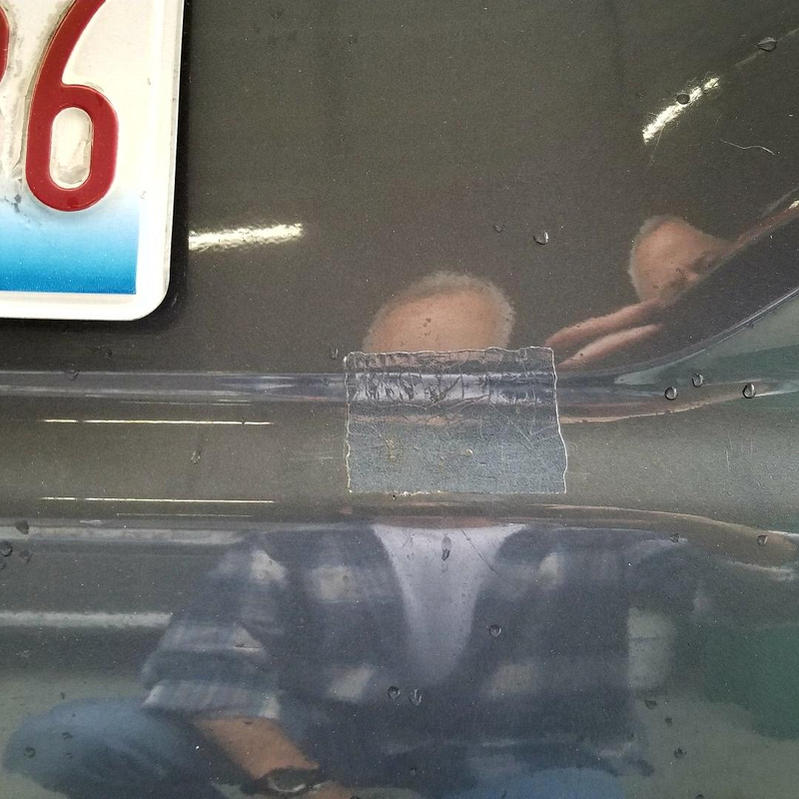

About a year and a half ago, I tried a home fix for some rust spots coming through just southeast of the license plate. I sanded down to the bare metal on both sides and found holes, so I applied some VHT, fiber-glassed the backside, primed, painted and clear coated. I clearly suck at body work, but stopping the rust was my priority. Looks like it`s back.
I kinda had a feeling it wouldn`t last forever but the truck has many more miles left and I`m thinking a pro fix might be needed as it looks like more rust spots are coming through. Any idea how much body shops would charge to fix something this size?
I`m thinking there might be some metal transplanting needed this time to do it right???

I’m in the same predicament. My 08 is rusting from the inside out, and I’m trying to decide if I should get the original one fixed right or just swap out for a new liftgate. I have already bought an extra liftgate, but it’s galactic grey so it’d have to be painted nautical blue. I like the idea of keeping the vin tag matching but I don’t want to pay for it to be fixed and then it happen again in a few years. From what I can tell, it looks like it’s caused by a piece of sound deadening material losing adhesion and water getting between that and the lift gate metal. May yank that material out and see if that helps slow it down.
My rust spot was right where the loose sound deadening was, ended up with a hole a little larger than a pencil eraser
I scraped off as much of that deadener crap as possible and sanded down the rusty areas (both in and out) to bare metal, areas with deadener residue was also sanded down but just enough to remove the residue. After some wipe downs with prep solvent or thinner I applied red rustoleum primer with a brush on the inner surface and a sandable automotive primer outside. After the "patch" was applied I spray painted the inner surface white because I it was the only color I had around, but I also figure it'll be easier to spot any returning rust if the surface is a light color.
The "patch" is composed of aluminum tape with several applications of metal reinforced filler, still have to sand it down, prime again, then base/clear. If the rust returns again I plan to cut a larger area out, make a patch panel out of stainless steel and stop by a buddy's shop to TIG weld it to the tailgate.

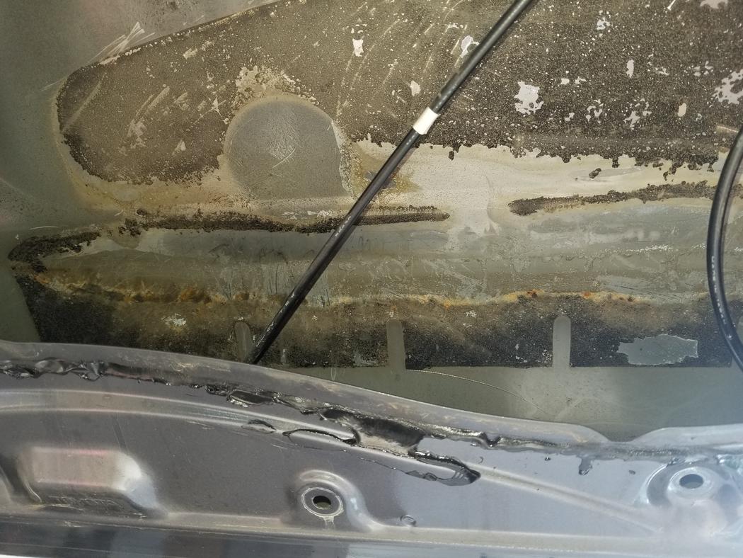

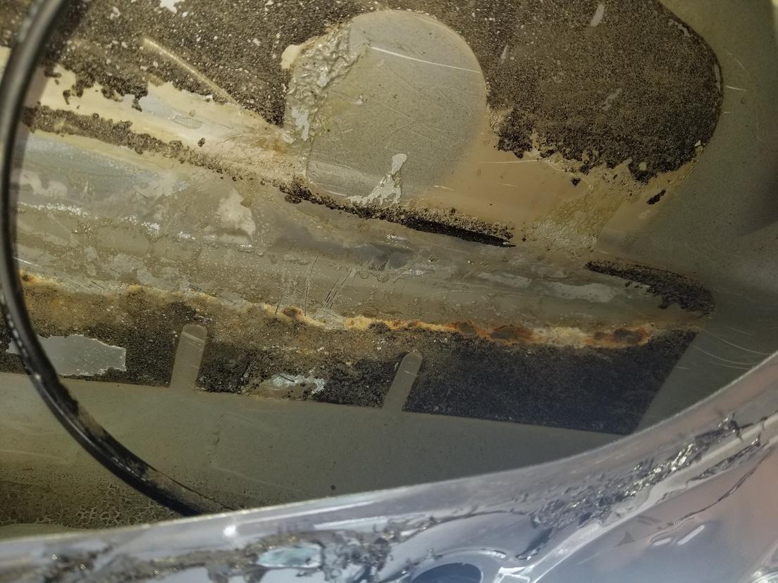

Dug into mine today before I took it to the body shop.
Looked up used hatches, they are between 800-1000 for a clean one. I noticed half them say rust on inside of back, I assume the same issue. At $60 a hour (current body work rate in Oregon) I have a hard time believing getting a used hatch would be more economical since I would have to paint it anyway. I assume for a skilled body tech it's 2-3 hours to fix this spot, then the normal time to paint.
