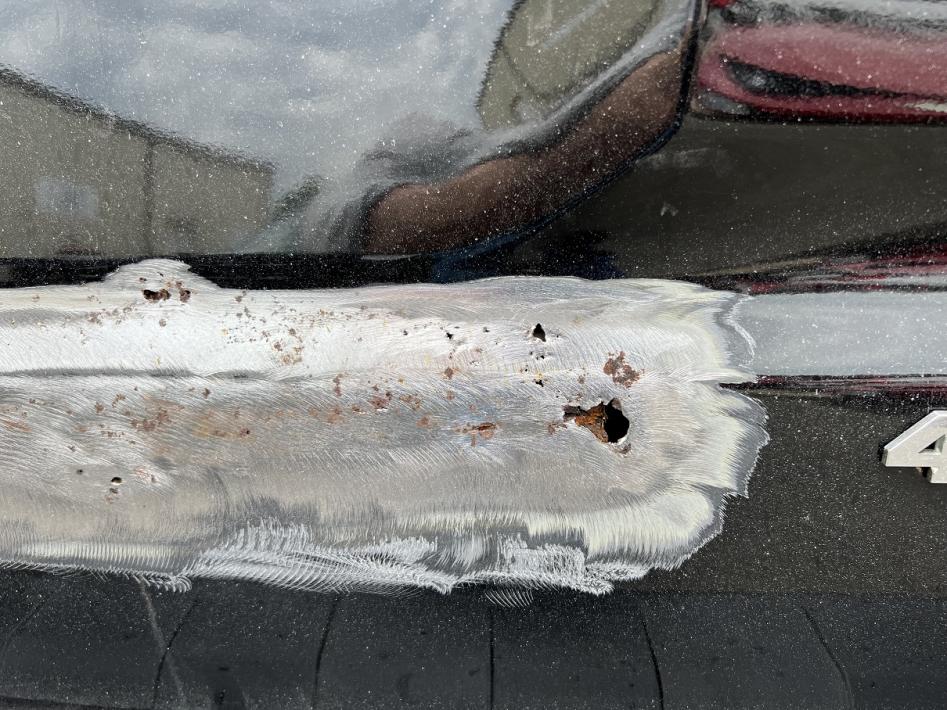

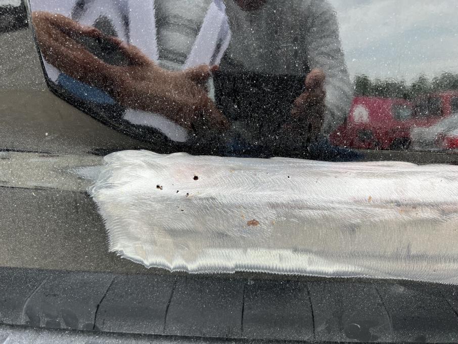

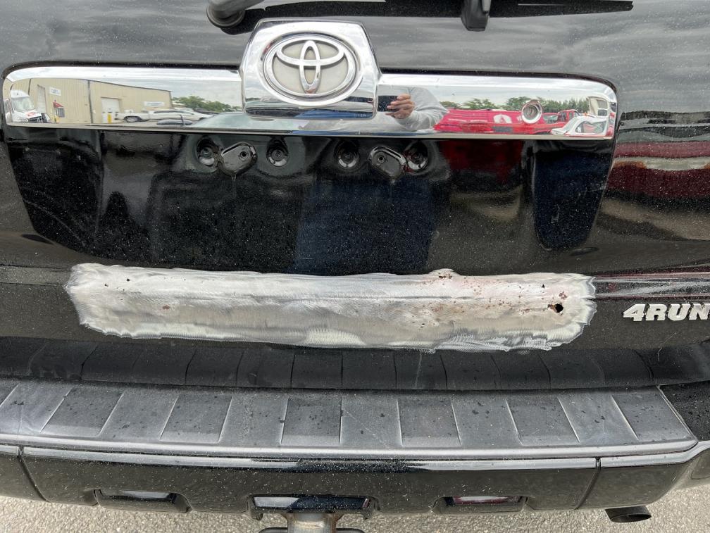

Just had my liftgate rust inspected while my 07 sport was in the body shop getting some body damage to the rear driver’s side quarter panel fixed and painted. The shop thought they could fix it for $1,000 originally before in depth inspection. After really investigating area the shop called me and will not even attempt to fix. Quoted me $2,100 for new lift gate shell painted... Wondering if there’s some way I could grind down, weld on new strip of steel on outside over length of liftgate (to beef up compromised shell) prime, and have bottom portion of liftgate linex’d?

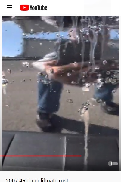

Walkaround of vehicle at time of drop-off
https://youtu.be/InpuXvs9__4

Well do you have a welder? At least that area is flat and no contour. Just a crease and bend. I would never pay that much for anything. You can buy all the equipment and consumables yourself for less than the shop quote. If you like to diy and learn new skills and sh1t.
Look on car-part.com Tons of liftgates for a $1k or less in great shape. May need to repaint it, but it still shouldn't come to half the price you were quoted. I wouldn't bother with a new OEM one.
