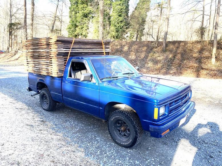

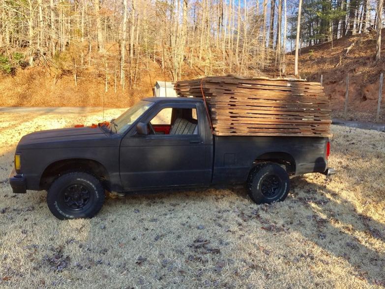

But this is one of my victims - bought for $700 (but shown here before/after) with a $1600 paint job because my wife hated that it was in black primer when I bought it.
Using the surburban driveway as a work area, I managed to put an exhaust system in it (cheap), and seat belts (kind of expensive). Also belts and coolant tank under the hood. And brake-light wiring repair (kid who was the PO managed to cut the brake lights when he sawzalled the otherwise perfectly-good muffler and tailpipe off). The sawzalled bits were bouncing around in the truck-bed when I bought it. I splurged and replaced with new.
I think of it as a motorized wheelbarrow. Starts reliably, and passes state annual inspection 5 years now.
Hauling rifle targets for repair.

Not to take the thread off-topic.

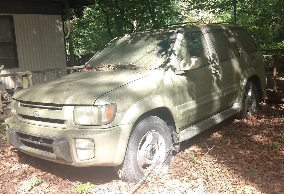

Haha you're a country man too! That's pretty cool. I got this for 350$ recently. They thought the tranny was bad ready to see what it's AWD can do. Not even a scratch on it.

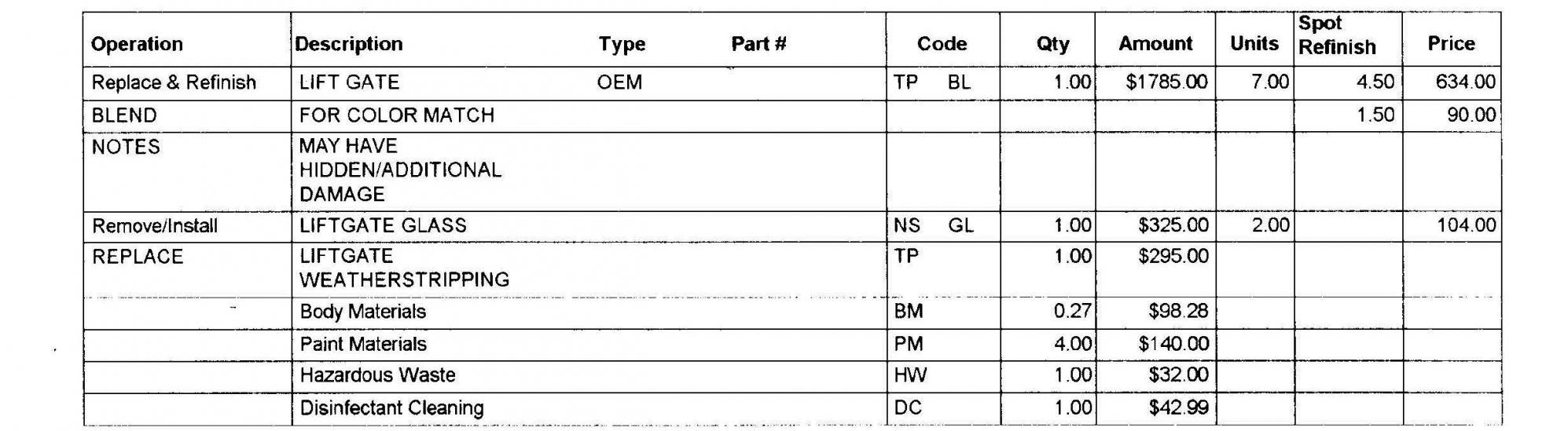

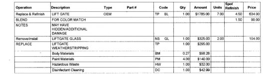

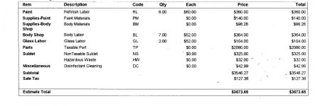

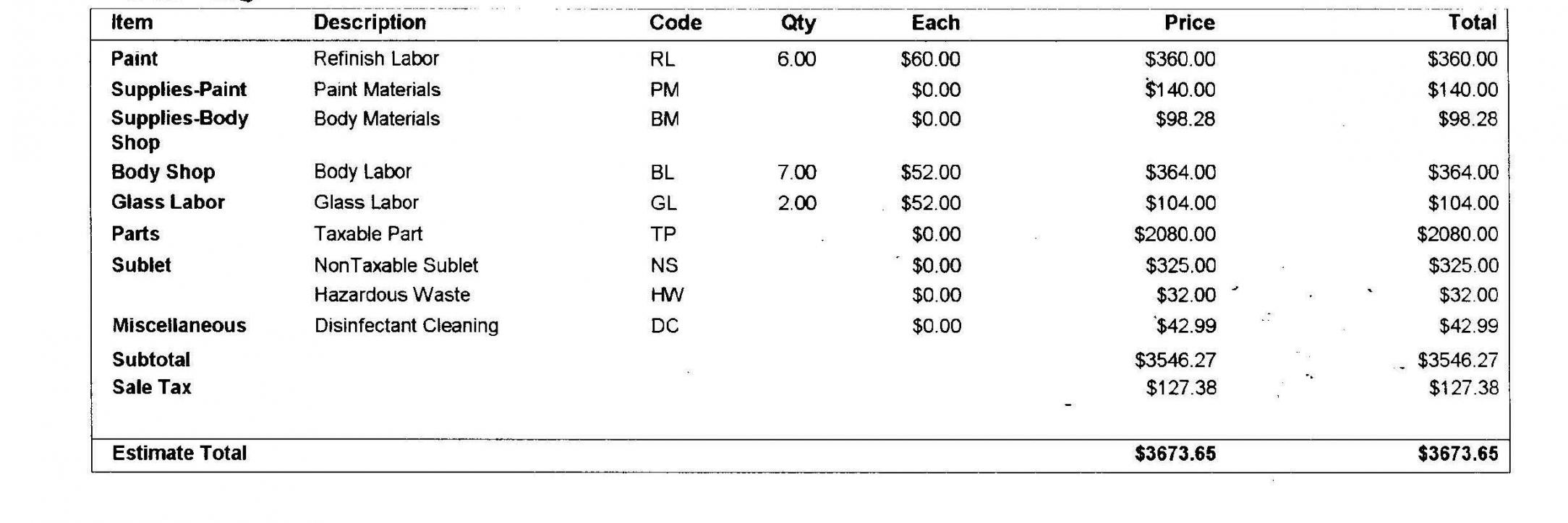

Estimate numbers in case anyone cares

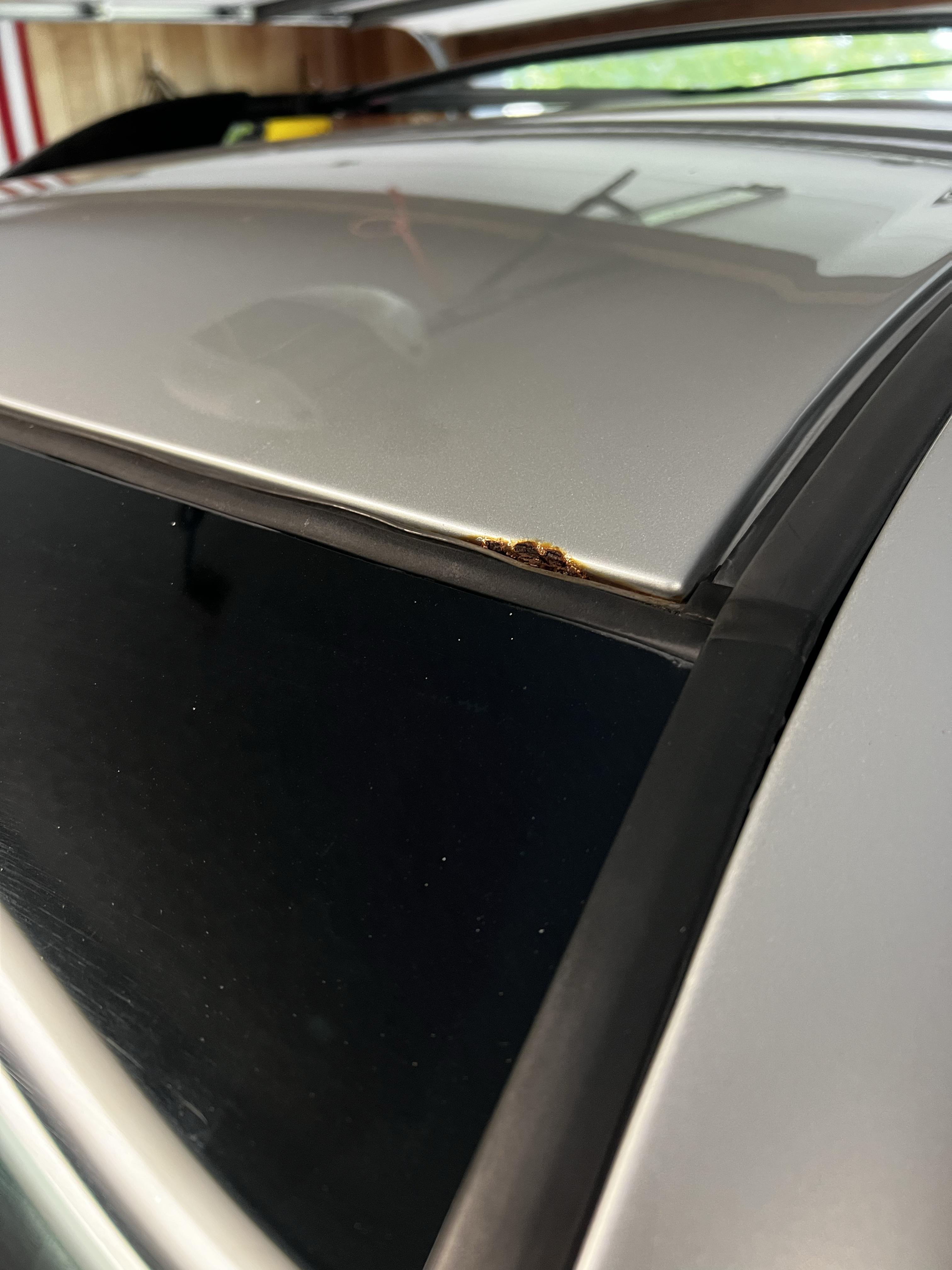

Rust experts - while I know this isn’t on the tailgate, should I pursue trying to fix it asap?
Hasn’t changed much in the past six months.. at least from what I can see. It’s on the roof line right above the windshield

I wonder if it is sitting under where the roof panel attaches to the rest of the body. Might be worthwhile to take it to a body shop to get an estimate of how extensive and how much to fix.
Otherwise, I would sand it down to clean metal. Consider using some body filler to even it out if theres more than you expect. Use a coat of a rust converter as a primer, then a few coats of silver paint, clear coat and try to wet sand/ polish to blend best you can

What do you think caused the damage?
Condensate from inside the vehicle eating it from the inside out?
Sun-Roof leak channeling water to that area? Do you regularly park the vehicle facing downhill such that intruded-water would puddle there?
Was the spot damaged by some sort of trauma (rock or some other object striking that area)?
If you have a water-intrusion issue, you should solve that. Otherwise, any repair made there will be jeopardized by further exposure to water from the backside.
Otherwise, I would dislodge any loose rust there, and rebuild the area with some sort of epoxy. Literally JB-Weld. Smooth the epoxy, and touch up with matching paint.
The alternative of doing a "proper" metal repair is going to be very expensive. For a basic 2007 vehicle, the investment for a full-on cut-out-the-rust, and weld-in-new-metal, and repaint, would seem an unwarranted expense.
