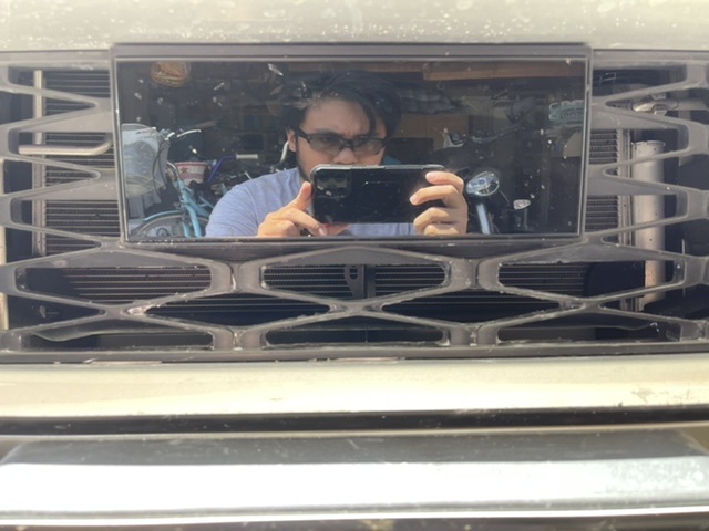

So I have a Baja designs 30” S8 incoming and it’s planned to be thrown into a lo pro front bumper eventually. I happen to get brackets to mount lights dirt cheap used for behind the grille as well. I took a close a look at the new TSS crap on my grille and the “non shiny” section doesn’t appear to be a vital part for the sensor ( at least I don’t think it is). I was thinking of just going at those filled honeycomb sections with a dremel + router bit to clear that part off and throw the light bar behind the grille unobstructed. I wanted to get your guys’ input before going through with it.
My theory of why that plastic portion below the shiny area (radar) is present is additional shielding from the elements ie. up-splashes from water and what not towards the wire harness/connections. Since the lightbar will be essentially taking up that space instead... all would be fine.

This came up on another forum just a couple weeks ago. The consensus was it was for rigidity but it was also pointed out the Tacos don't have that section filled in. A couple people cut as you are going to do and said it seemed fine. I was going to cut mine to put in my Cali Raised behind the grill mounts and light bar but ended up I am not going to install the light bar because it blocks access to the clutch on the winch or if I have to plug in the controller.
I cut one of the holes out.. its fine, there is nothing back there.
Though in hind sight I didn't need to cut the hole. Live and learn.
Someone here did what you're asking a few months ago. I'm too lazy to search, but you should find it if you look back a bit.

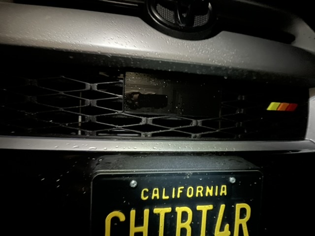

Current progress. Rough cuts almost done then next off sanding! Yea I’m pretty sure it’s just extra protection for the wire harness to the radar. As soon as I cleared the center top one I saw the wire harness saying hi to me :)

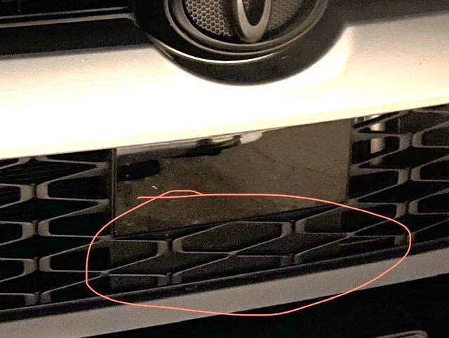

Need tips cleaning this up �� I obviously suck at sanding it’s actually my first time sanding plastic in hard to reach areas. Also wondering what I can use to help clean out the little tight corners. Had a hard time reaching deep into the corners cause the collet/chuck would end up eating into the plastic if I got any closer. I was using a harbor freight special rotary tool with a lackluster bit kit lol. The white stuff is lubricant I didn’t fully clean off yet

You should be able to clean a lot of it up with a utility knife. Then you could use a small half round rough file and or wrap it with some 120 or 60 grit sandpaper….
Or wrap a paint stirring stick with sandpaper.
Use your imagination, it shouldn’t be that hard!
Let us know.
Or if you have a Dremel, you could clean that up really nice - my 2cents
Edit: just noticed that you mentioned a rotary tool. With the right bits, that could make quick work of making it look nice.
Some plastics just "ball" up when rotary filed or sanded. You might try a die-sinker file set. Another option could be X-ACTO knives. They have a curved hook like blade which can reach the back side. IMHO, a blade is the best way to go. It'll be tedious, so, good luck.

Thanks for the tips guys gonna hit up Home Depot! Totally forgot about grabbing a small rat tail file and just wrap it with the grit you need

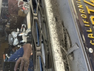

Ran out of light! Boo.. I think I’m satisfied with how it came out. Just need to find a good polish compound for plastic. Any suggestions guys? Hand polish it in or buff it in?? Thanks for all the help this far! Can’t wait to throw my new lights back there soon! The BD lead times are a painful, wait but totally worth it for sure!
I went out and bought some rough 150 grit and worked my way back up wet sanding through 220-400-800- I have 2k on standby but I feel that it’s not needed since I’m not trying to get a crazy gloss finish
