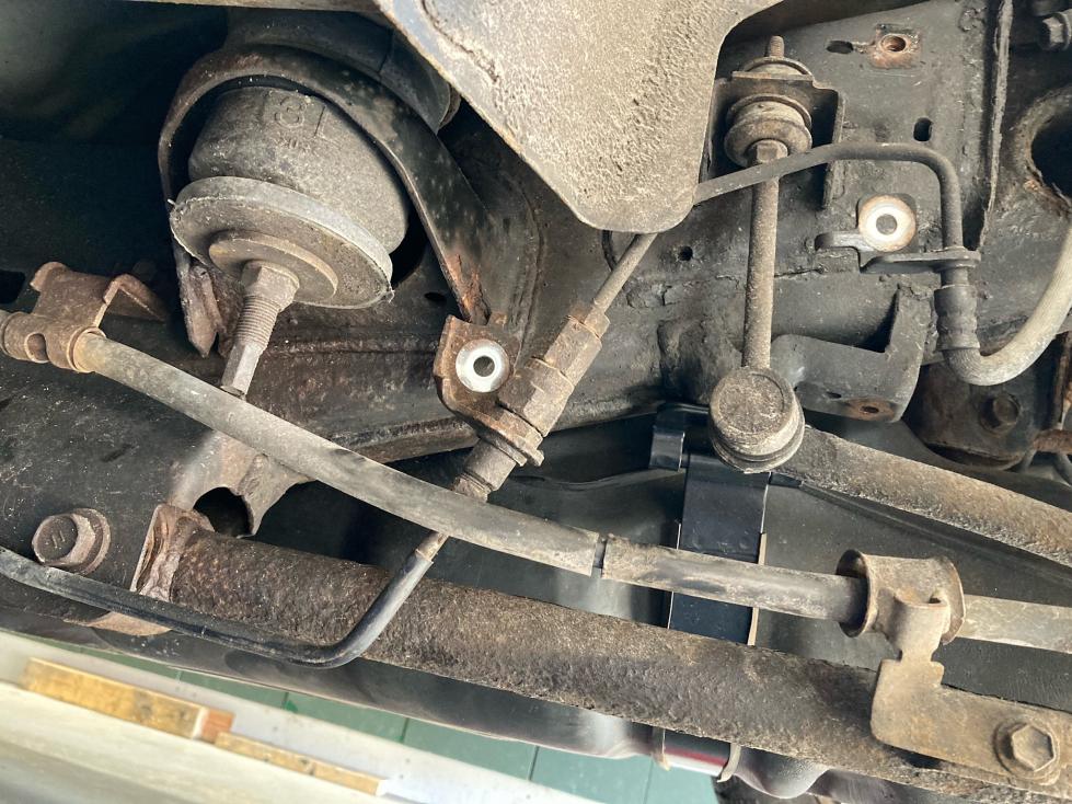

Disconnecting X-REAS
I couldn't get the 22mm wrench on the fitting and turn it without bending the wheel well wall in a bit. Just tighten down a crescent wrench all the way and gently bend it toward you, then slide the wrench down a bit and do the next little section until you have enough room. About a half-inch in was enough. When you're done, just gently bend it back. I had some black spray paint handy to cover any spots where the coating got scraped.
It's slow going to disconnect the fittings b/c you can only move the wrench a fraction of a turn each time. Here's one of the rear fittings with the wheel well bent out of the way and the fitting partially loosened. The pic is a bit deceiving as it looks like way more room than it is. Bracket at left is where the rear sway bar link attaches. It has to be removed to get to the fitting.
This one's off and I'm ready to remove the shock.
The bottom spring mount is designed such that you rotate the spring until the end runs up against a stop as shown. This is the old spring before removal.
After installing the new shock and wrangling the spring for a while, success!
The front X-REAS fitting is tougher to reach and is easier to confuse with the brake lines. Be sure to follow the tube from the shock to the fitting and be sure you have the right one.
The FSM disposal instructions say to remove the banjo bolt and drain the shocks. That was only possible for the rears b/c it took 5-6 extension/compression cycles to empty them and I couldn't budge the fronts with the old spring on them. The fluid was amber and remarkably clear. It's just a trickle in this pic since I didn't have enough hands to compress the shock and take the pic.
