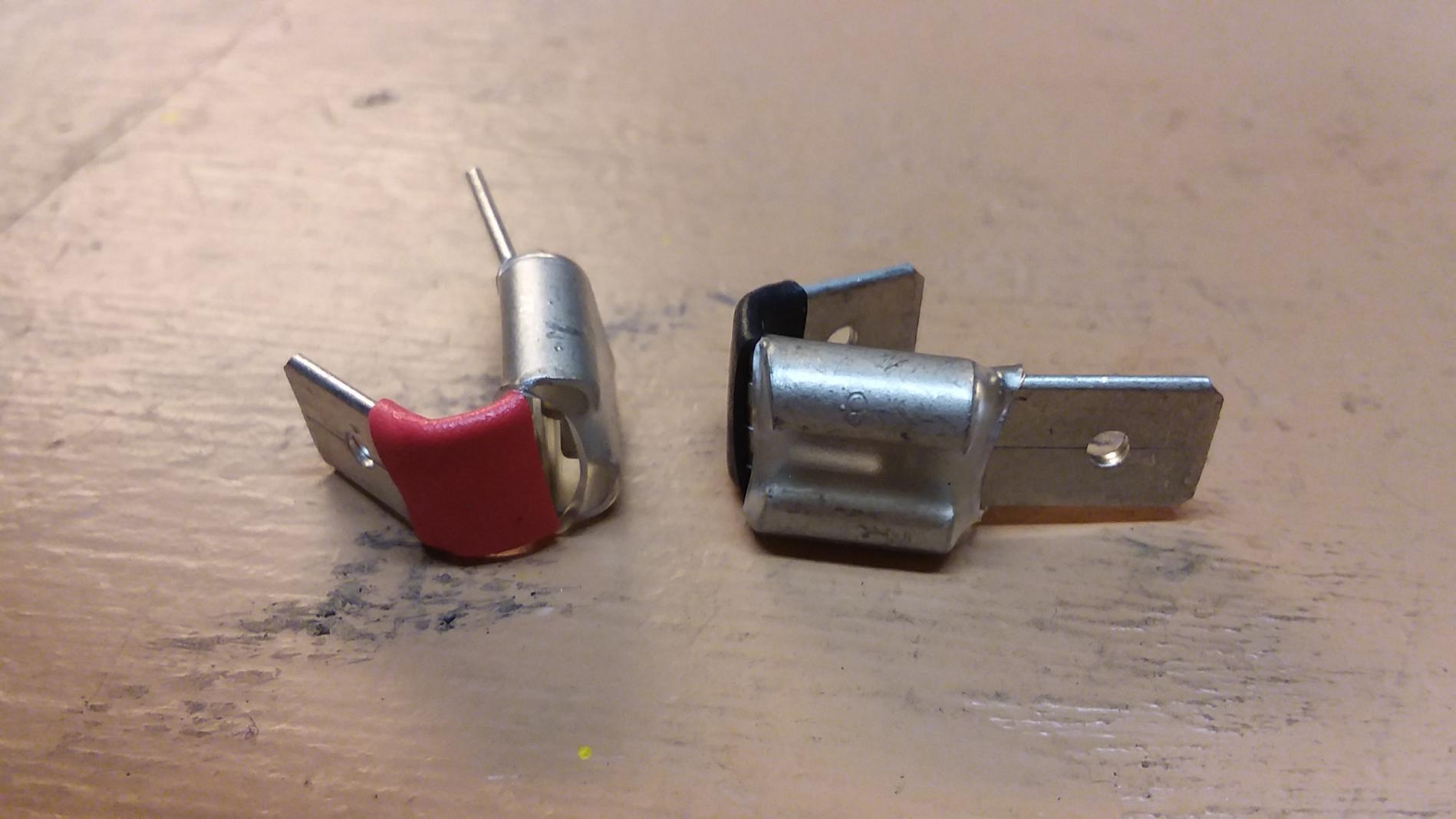

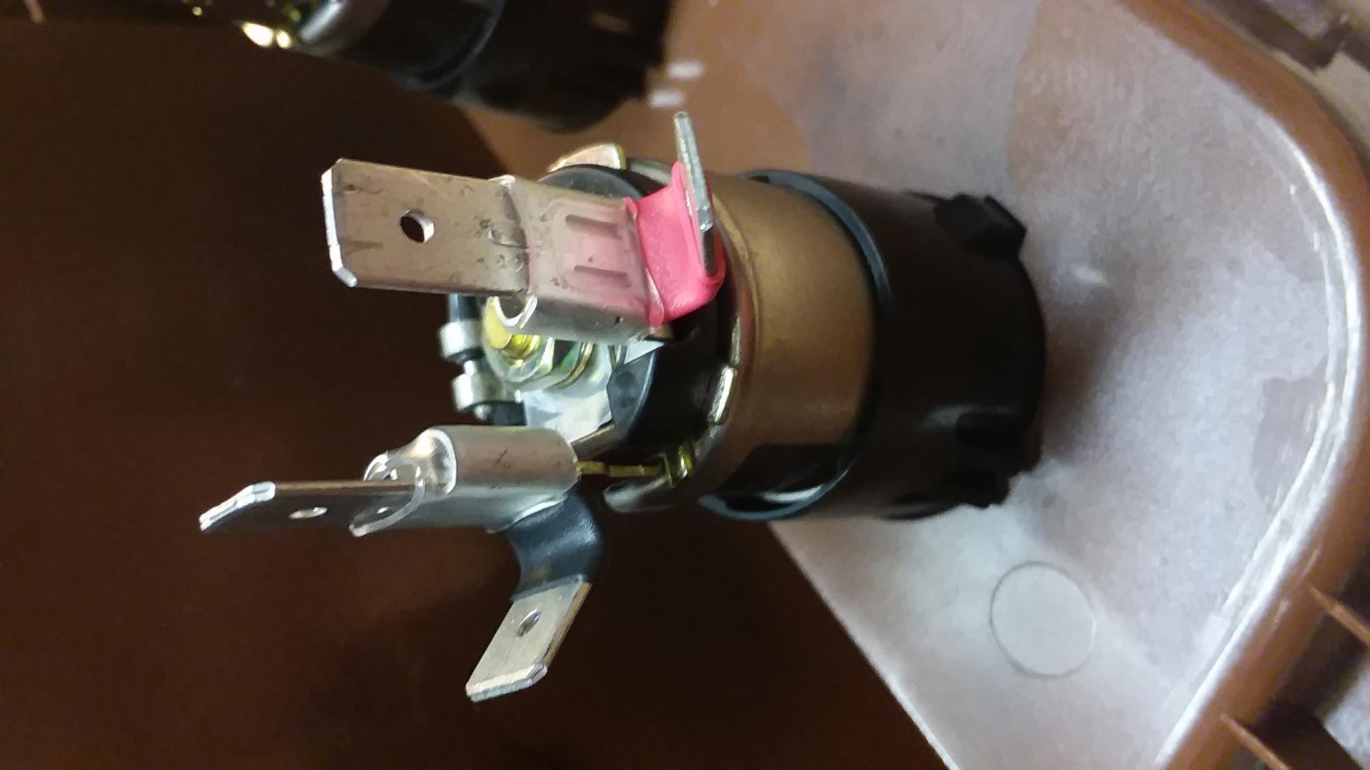

I used these cool spade connector splitter things to add a way to connect to that power. If someone was averse to cutting into the factory harness this is a great option.
Very cool, just buttoned mine up and everything works. Great idea, wish I would have seen this earlier. Ever since installing my 7th injector for the supercharger and having to tap into the factory wiring, it hasn't been so hard to do it now. I'd definitely go this route if I didnt want to cut up factory wiring.
