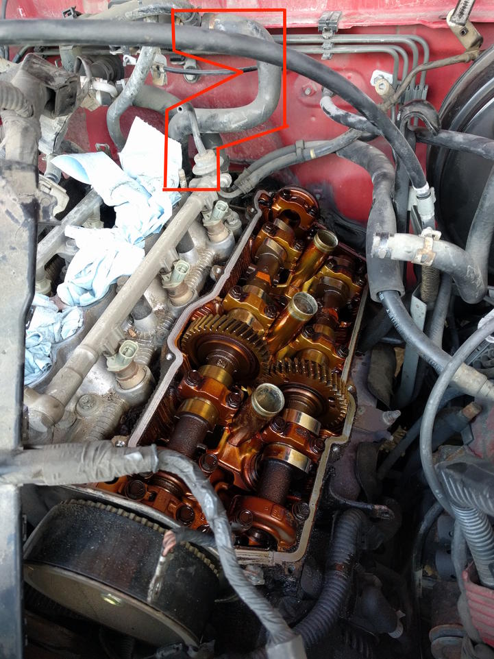

Found the culprit... Valve cover gasket was leaking oil onto the bottom of this guy, swelled up and busted. Now I just gotta find the part number to replace it, temporarily used some heater hose and made a U shaped pipe with some iron pipe since the hose kinked without it.
Glad you found it!
Still better than a head gasket :D
For the part number you could just go to your local toyota dealer parts counter, it may be even faster and not that expensive to get from there.
