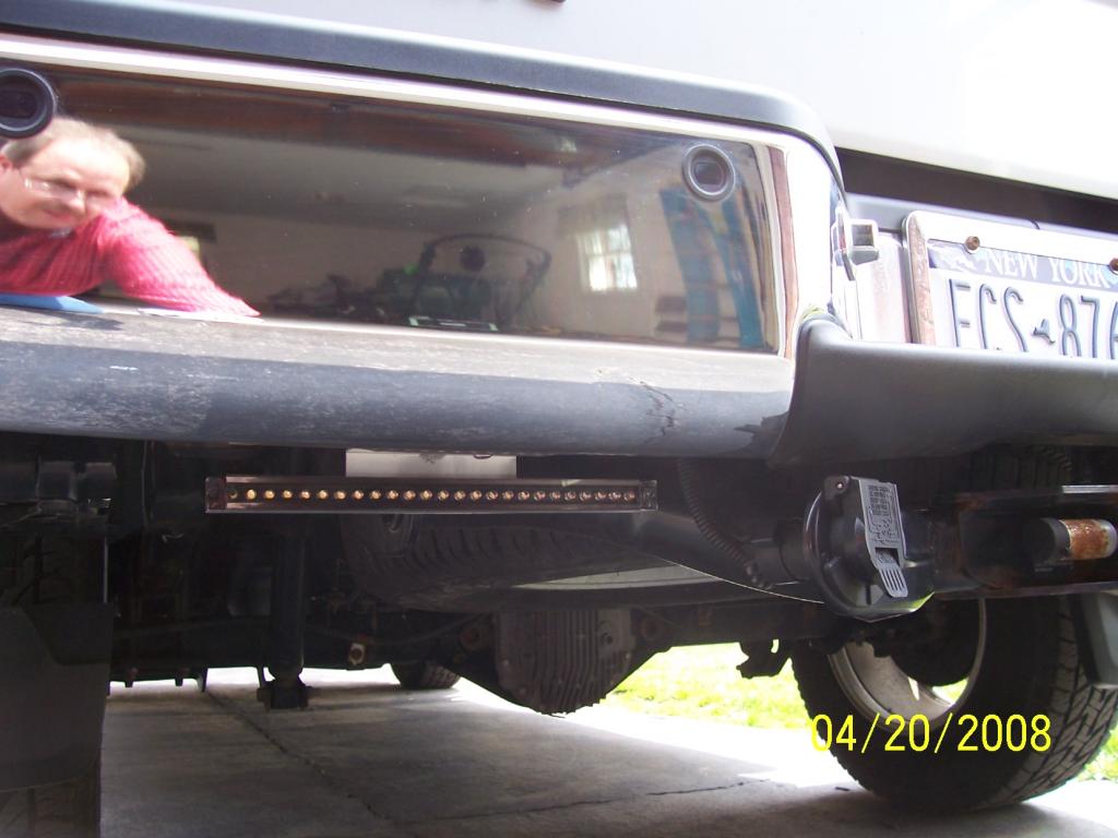

I was just out today test fitting a Diffused and Flood pattern SR-M lights. My plan was to mount one diffused and one flood on the rear roof rack. I tested them out last night and I think I like the flood on the rear more and diffused for the sides. The upside down mounting position I ended up with for the rear is a compromise, but the lights are protected by the rack and out of the way.
Here is a link to the photos I took.
http://rhino4runnersuspension.shutterfly.com/pictures/1027
I like this much better than your first attempt!
Aint the innernet wunderful?:)
