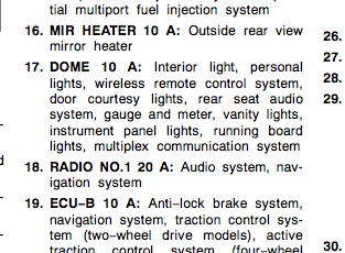

It's slot #17 in the engine bay fuse box, a mini 10A.
