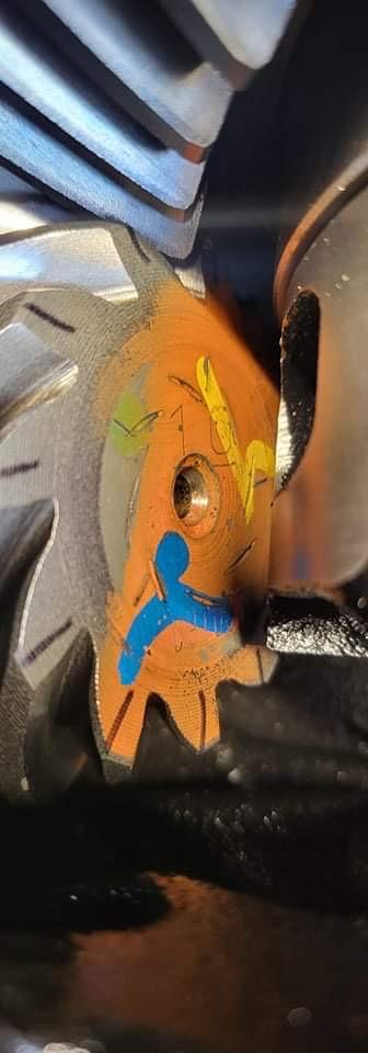

I saw an ad for a 3rd member but the seller wasn’t sure what the ratio was. He counted and said 41:11 which seems like a 3.72, did these ever come locked?
He sent a picture of the pinion and it has a stamp that says 10 but the seller says he keeps counting 11. Any idea on what’s going on?

The 3rd gens 96-02 most common. 4.10, then 4.30 and 4.56. The 4th gens 03-09 came with 3.73. both are 8inch rear ends but the 4th gens are 27 splines while the 3rd gens are 30.
15" wheel trucks came with 3.73's... So, definitely worth being wary. None of those were e-locked.
Most e-locked 4Runners were 4.30's, but some (manual transmission) came with 4.10 e-lockers, along with PreRunner Tacos.

Thanks I did not know that the 15 inch trucks came 3.73.
