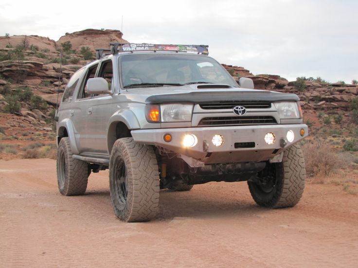

If I were you I'd just cut the hoops off. The bumper will still be bad ass. I almost ordered mine without the hoop to copy [MENTION=57546]4-Ripcord[/MENTION]s old truck.
Yeah, I was thinking about that. But I didn't want to start hacking this awesome bumper up. I like the Pre Runner style center tube facing out. And you are right, even the no tubes looks pretty bad ass. If things don't work out, I will have some options.
