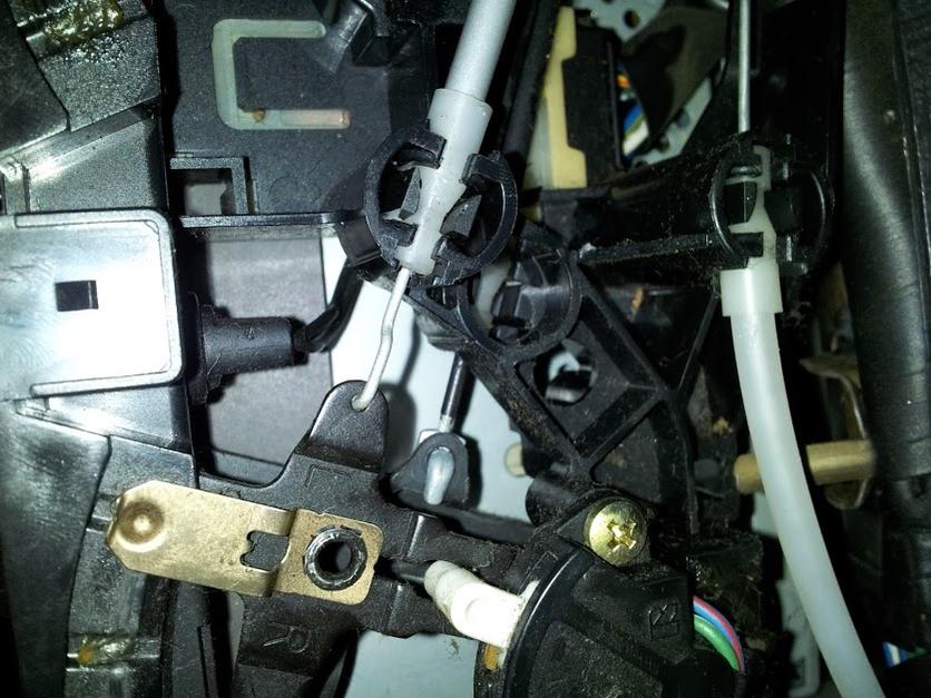

Does this look familiar on the back of your control? Sounds like the clicking is coming from the control head. I have a 99 Limited so my head unit is different. I know ebay has a crap ton of those units for cheap with the cables included. If it's clicking it's probably stripped or broken somehow and there will be no fixing it.
Nope, that doesn't look too familiar to me... I think your right about having to replace it though. It does sound like there is broken plastic. I'll have to have another look at it and see if I can get the cables removed.
Thanks for the info

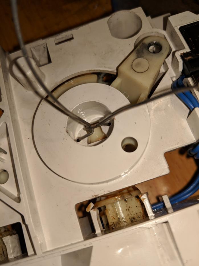

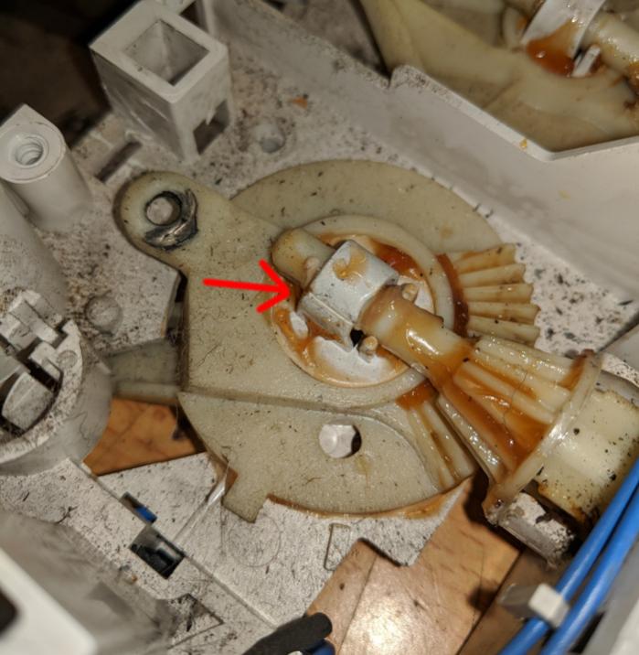

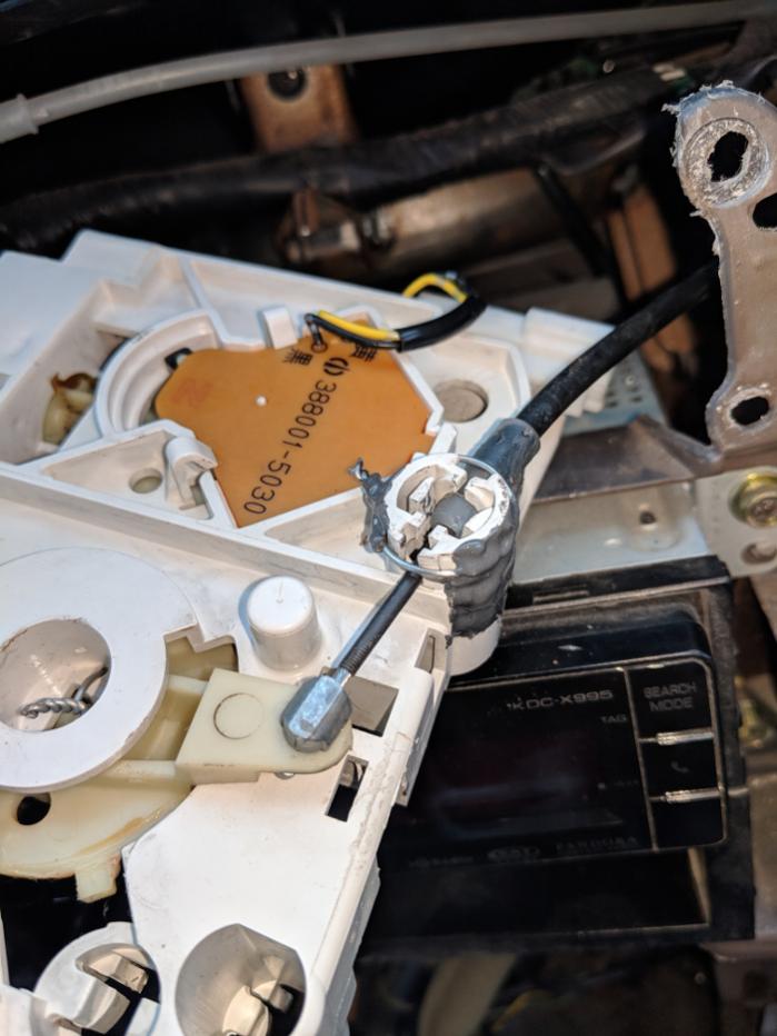

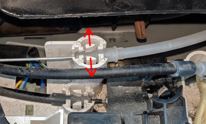

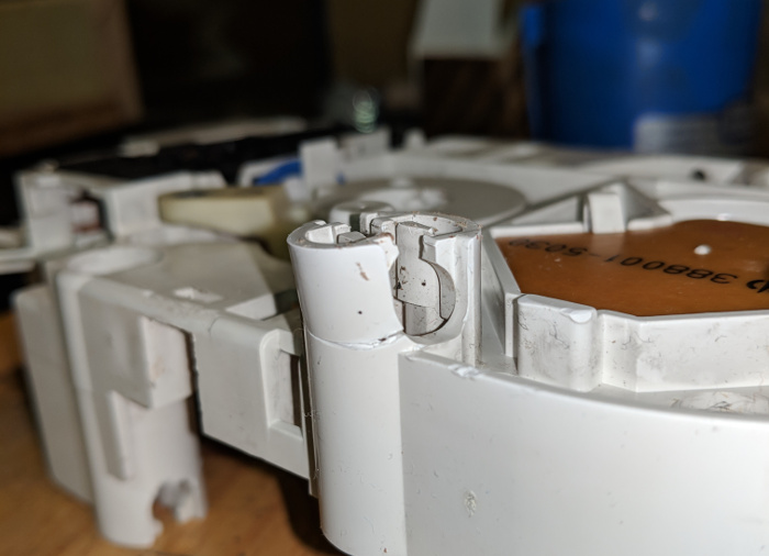

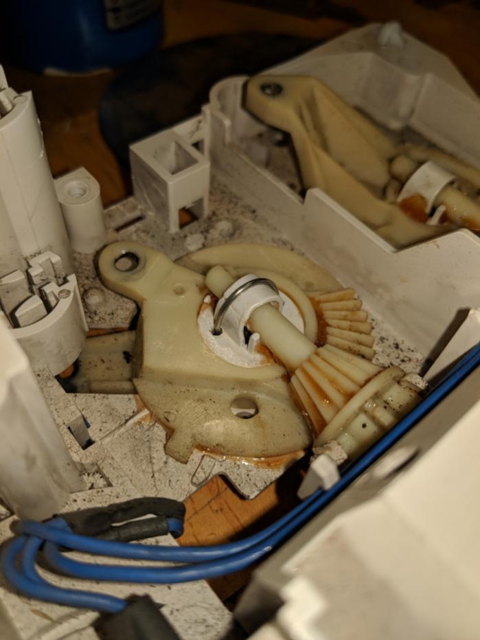

So I know this is a little late, but I wanted to give an update. Last September I did rip it all apart and fix it up. I took a bunch of pictures as well that will probably be of interest to anyone who is also having this problem.
It's not difficult to remove the temperature control box from your dash, just remove the front bezel, then a few obvious screws. The hard part for me was figuring out the correct way to remove the cables from the control box. I ended up breaking a few important plastic tabs that hold the cables down. When I put it all back together I used stainless steel lock wire and epoxy to hold it in place. The correct way to remove the cables from plastic housing is to press the inner tabs outward while pulling up on the cable - not too hard though don't want to break them off. If I remember correctly now, I believe I broke off some of these tabs once I had figured out how to remove the cables. The plastic was just old and tired...
Once I got the box out, and on my desk I opened it up. It was clear why it was clicking. The plastic bushing that holds the dial gear engaged with the actuator gear inside the control box was broken and not retaining anything. Take a look at the images attached. My solution to this was to use stainless steel lock wire to wire the bushing tight. This actually worked well, and would have been a simple/easy fix if I hadn't broken a bunch of the plastic clips holding the cables to the control box. Now, 6 months later and some of the coldest weather I've seen in a long time - it dropped down to -40c for a few days a little while ago (that's also -40F) and it didn't break. I'd say its good enough for another 20 years of service, right?
