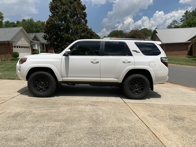

Is it just me or does it feel taller without the steps? :o
oh yeah it does. I've had my sliders off twice to repaint them, and it always looks so good when they're off. Enough to procrastinate reinstalling them

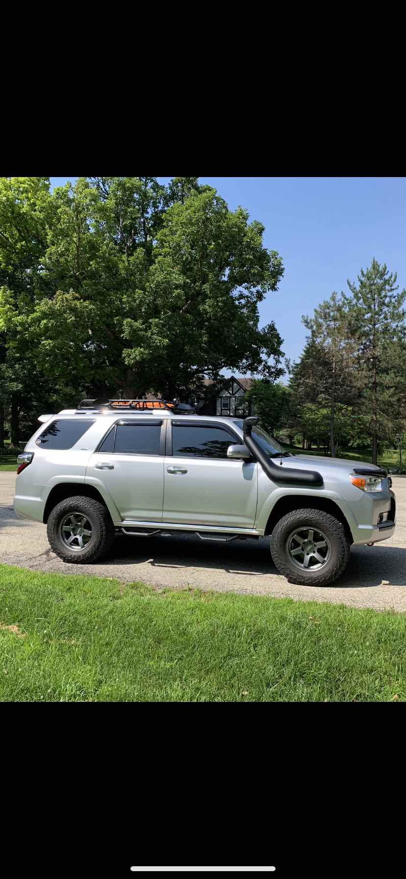

The Nfabs will look even better without the extra side skirts I have on mine.
