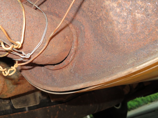

Noticed a new metalic "tinny" rattle starting a few days ago. It was rpm related at idle. Thought it might be an exhaust heat shield had come loose again. Finally had a chance to get under and look at it. Nothing obvious until I grabbed the rear exhaust pipe and it broke completely loose at the muffler. It had rusted through and made a clean break. The rest of the pipe is solid. The muffler is intact but is showing signs of age at the seams. I decided to do a temporary fix while I shop around for muffler options.
Here is the break (with the pipe held up with wire.) Over 10 years, 310,000 Km (193K mi.)

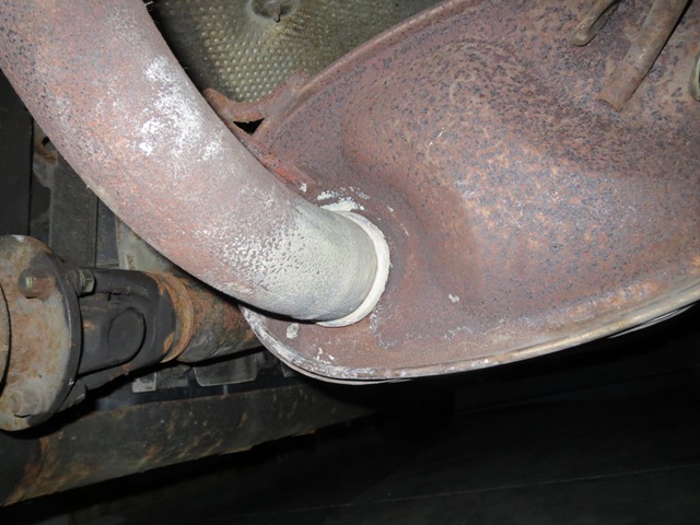

Went looking for exhaust adapters that would fit. Best option I could find was a stainless steel 2-1/4" O.D. piece, 5 or 6 inches long, to use as an internal sleeve (Canadian Tire #012-8780-6.)
Here it is dry fit into the end of the pipe. Marked it for depth.

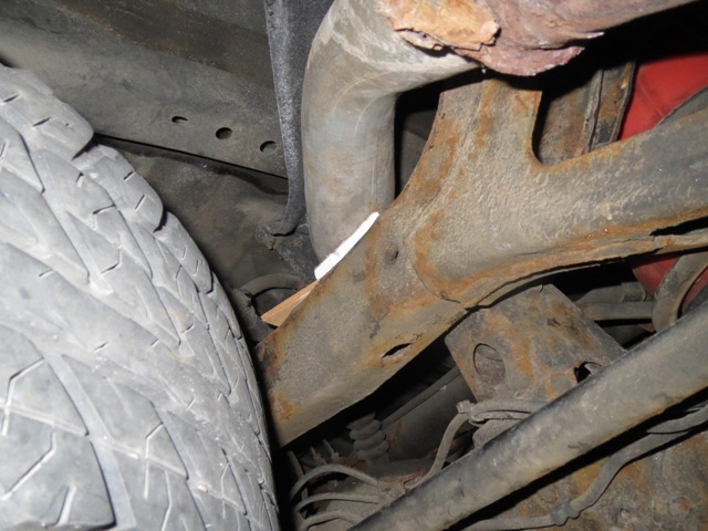

Dry fit into the muffler with a slide fit. Didn't need to cut the length.

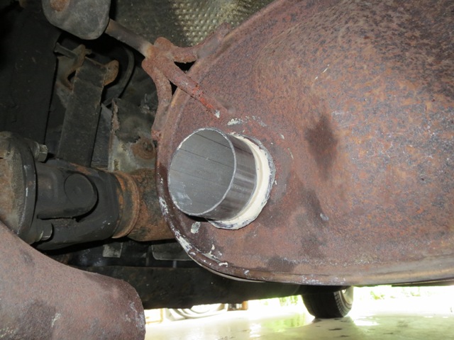

Gooped in place with muffler joint seal. Ran the truck a couple of times to warm the muffler and help with the curing. I let it cure solid for over 4 hours before going to the next step.
"New" exit stub on the muffler.

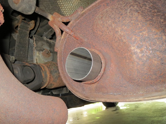

Temporarily shimmed the rear pipe to hold it above the cross member before making the final connection in the next step.

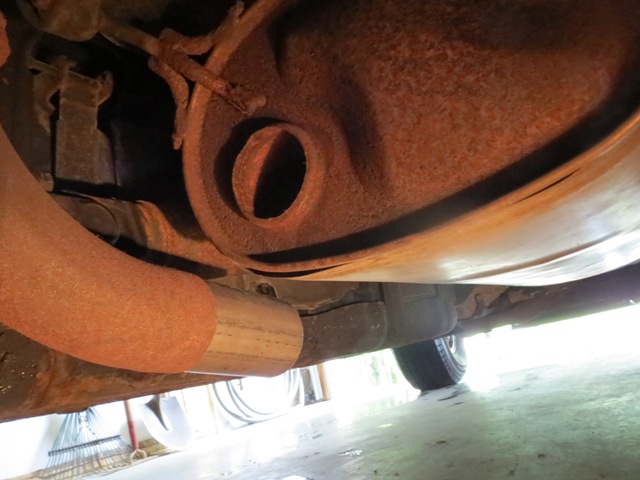

Final connection of the pipe sealed over the stub.
