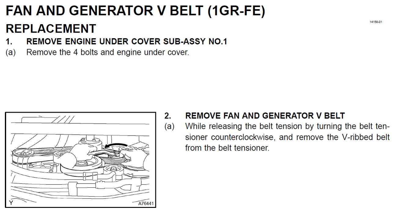

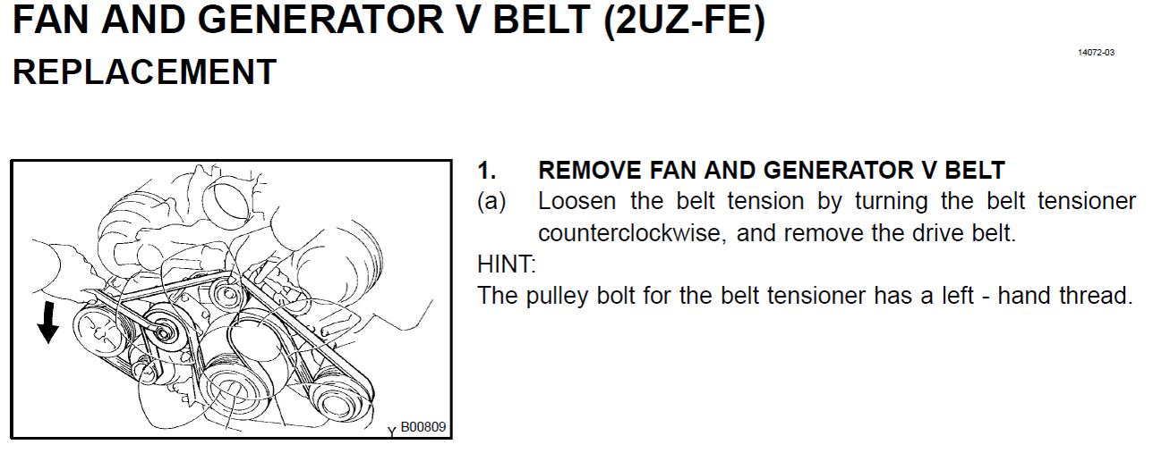

V8 or V6? It looks like the FSM warns you that the V8 has left-handed threads but the V6 doesn't say anything.

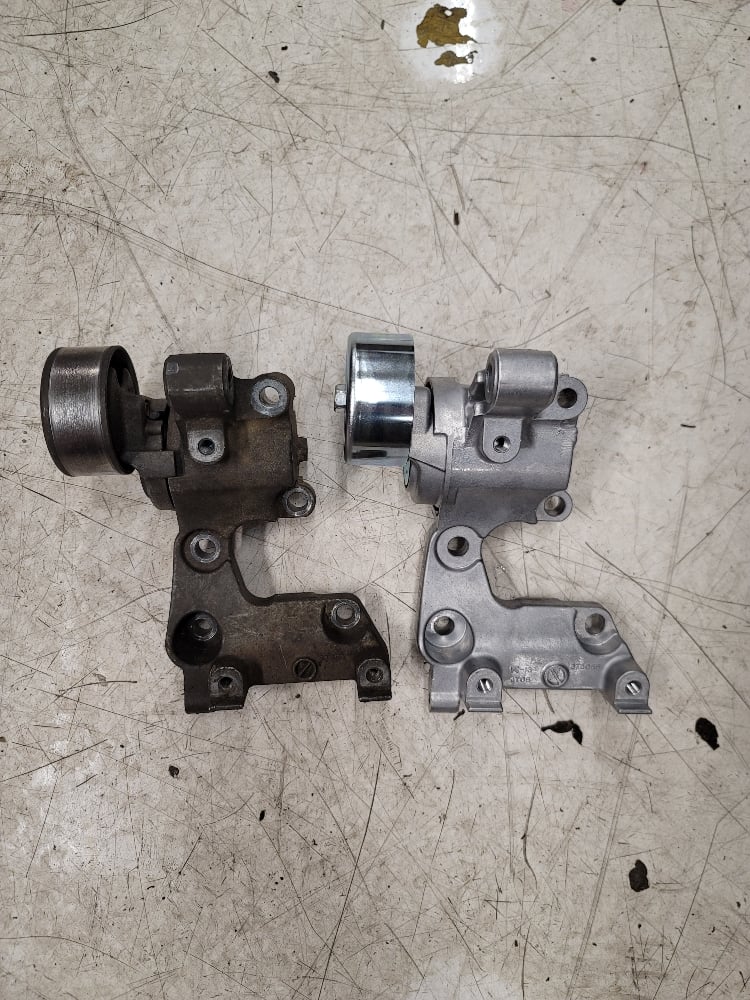

Pull the Pulley and check the bearing. Then replace with similar bearing. That tensioner pulley had no numbers on it for reference. (9/2003 Build) Its the only one that's is reverse thread/bolt.

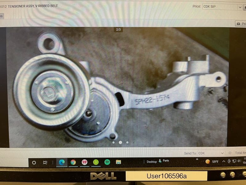

i don't believe you can purchase just the pulley, you have to purchase the entire assembly if you want to replace it. or there may be a way to remove yours and take it apart and replace the bearing.
You do in fact can only buy the whole assembly from Toyota, paid $95 for it
