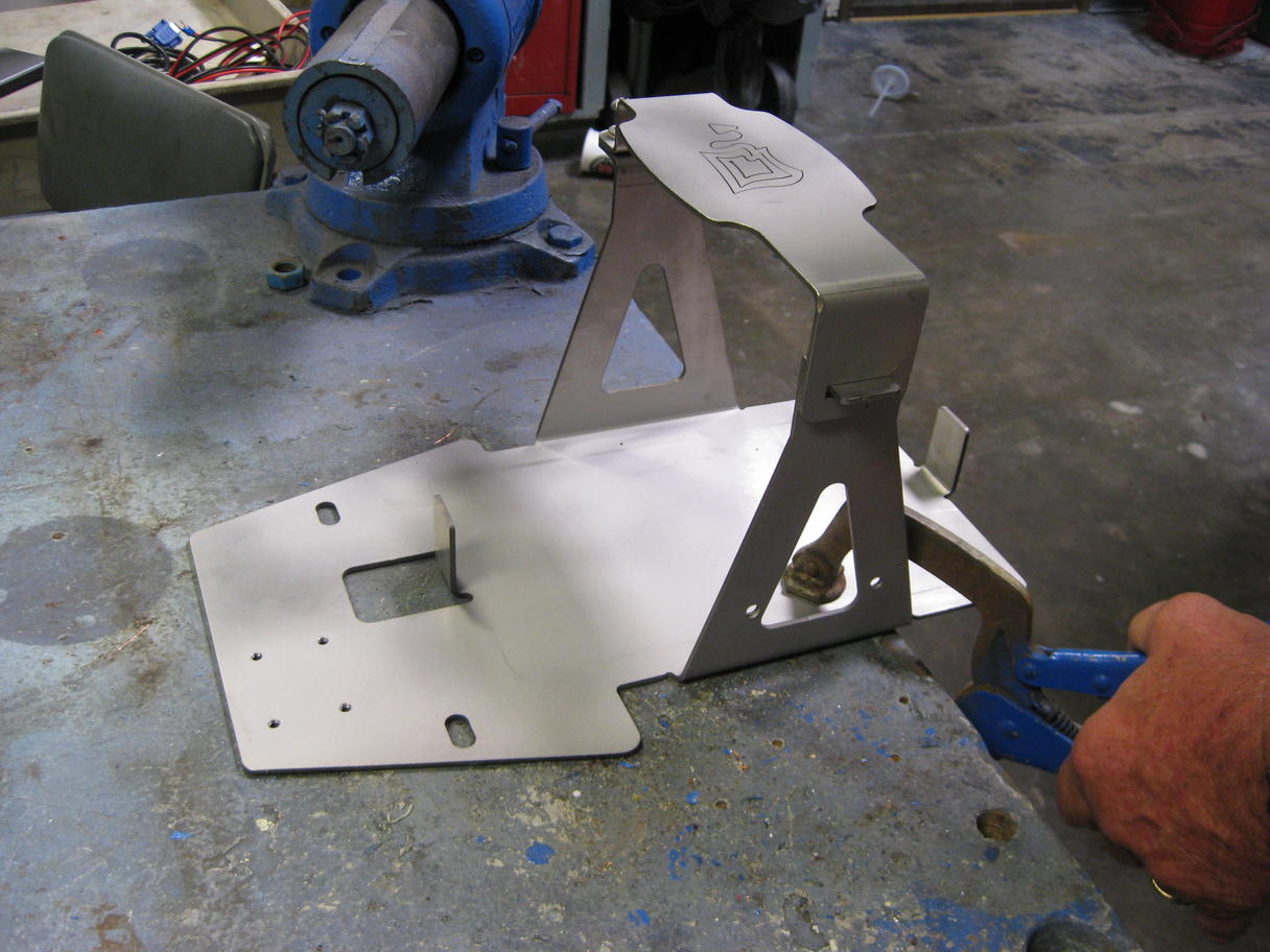

The offgrid aluminum battery bracket will end up being a simple mounting platform for my stainless steel bracket that has a far better layout for holding a battery. If for some reason the offgrid battery clamp ever comes loose the battery can slide towards the engine and short a battery terminal to ground. Therefore make sure the battery's positive terminal is the one towards the engine. My stainless steel bracket has tabs that limit lateral battery movement even if the clamp were to ever come loose. Much better design.

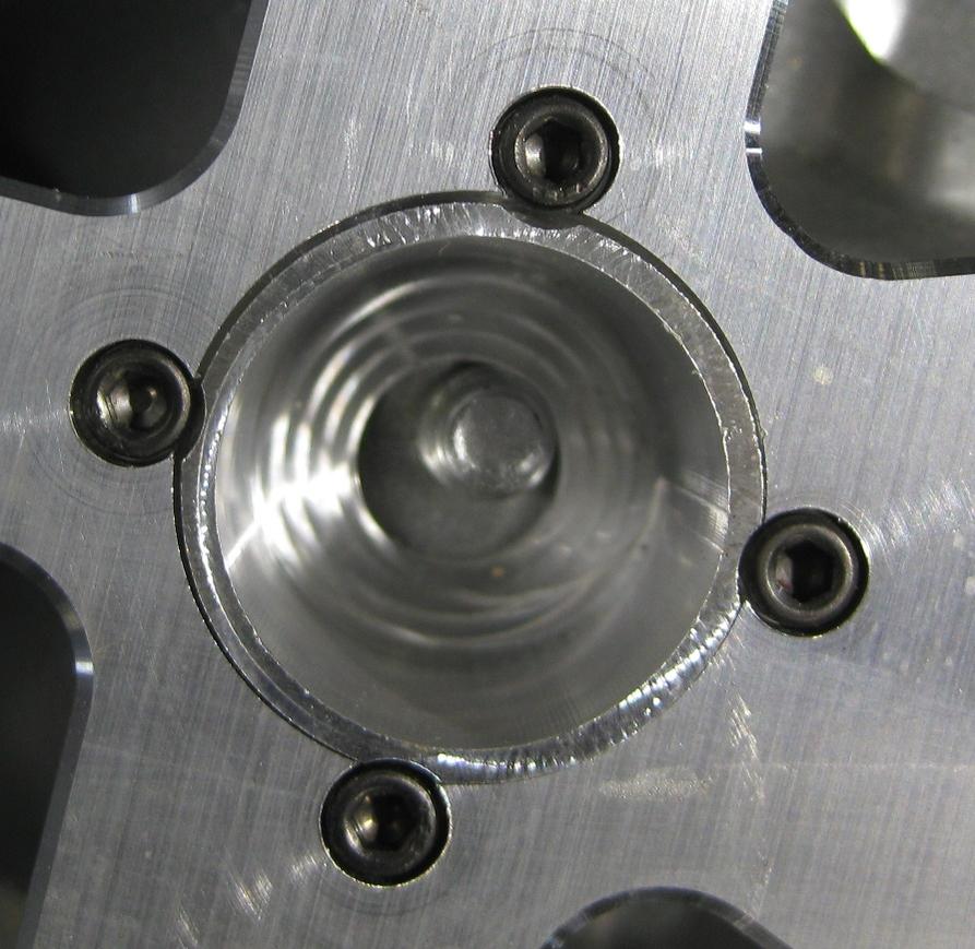

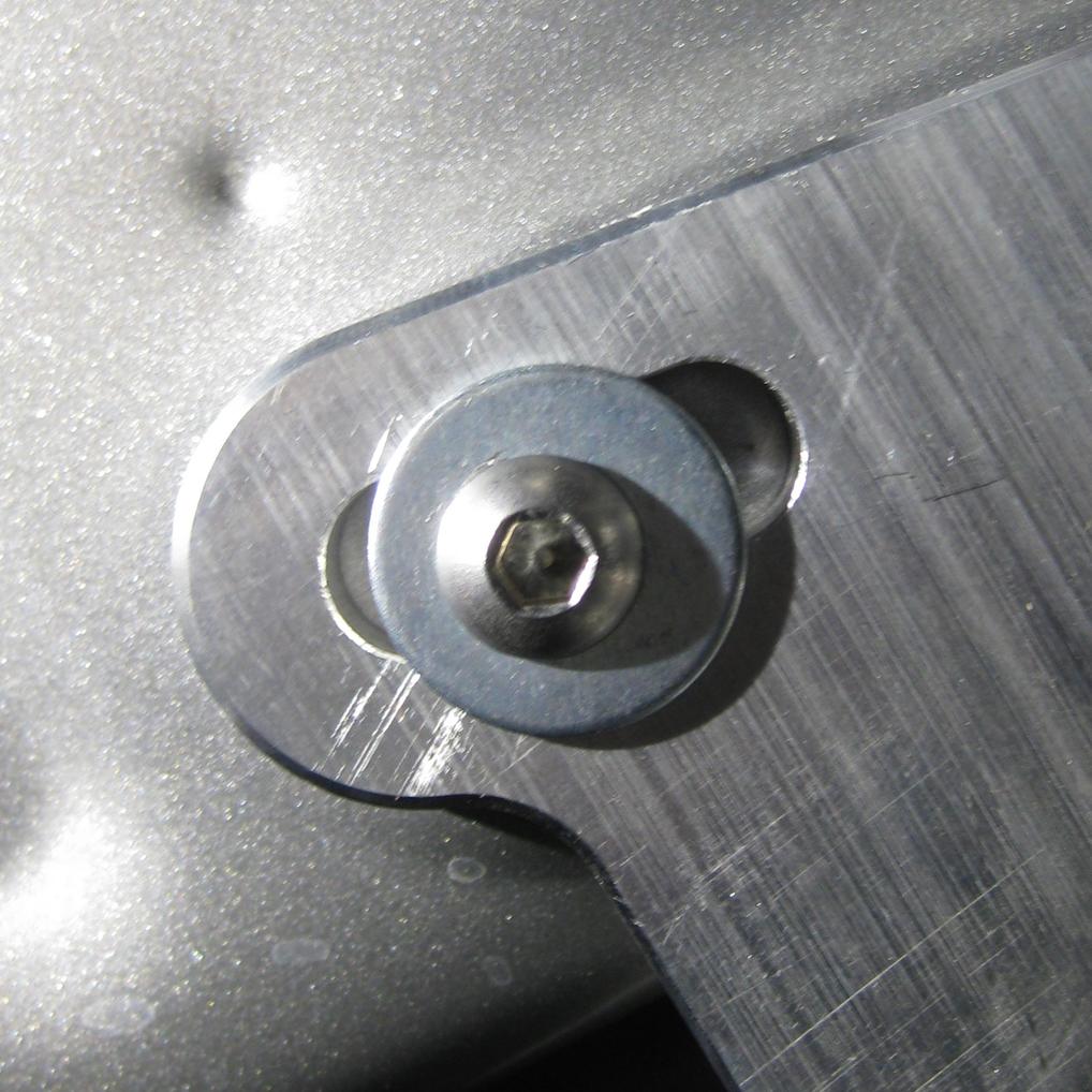

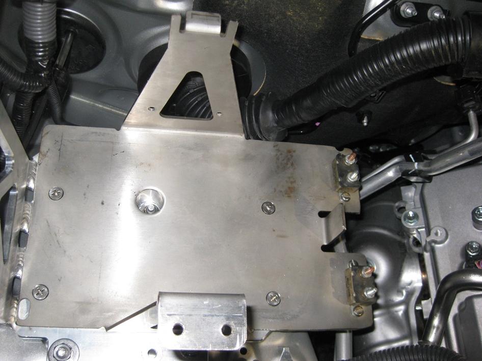

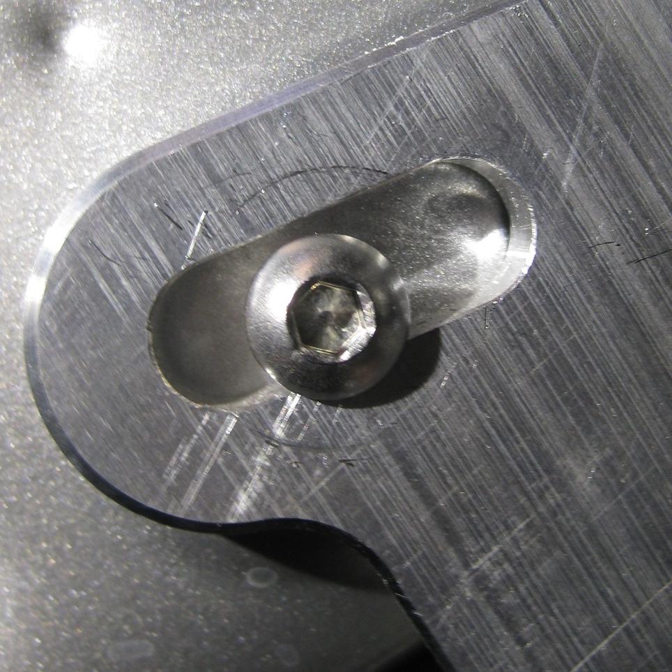

I ran a test fit of the aluminum bracket and found it is not great fit in my 2018. The bracket appears to have overly long slotted holes in two spots to try allow for variations across the 4Runner years. This creates a need for oversized washers to go under the button head bolts and take up all that slop.
The elaborate baseplate standoff mount (hollow tube with 4 Allen head screws) is a problem area for fitment as it aligns poorly. The stock Toyota flanged nut will not fit. Hopefully I can find a metric washer with a very slim profile that I can get down in there as I don't want the baseplate to have any vertical movement. I'll probably go with a stainless steel Nyloc nut.

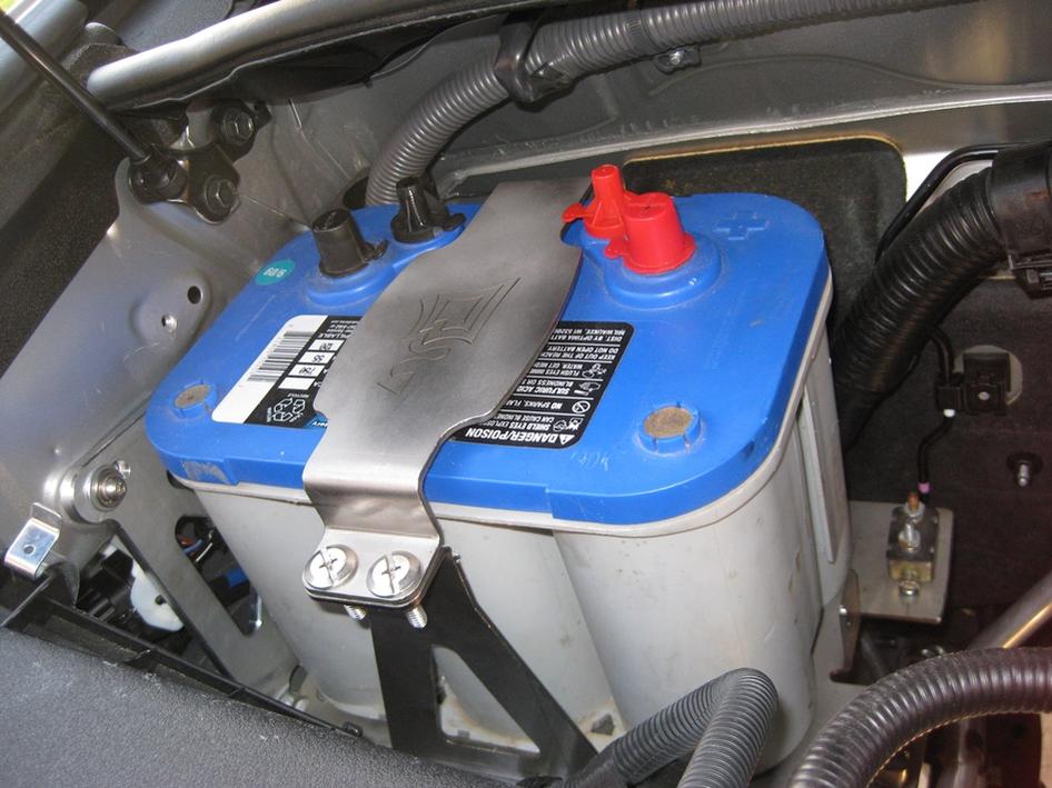

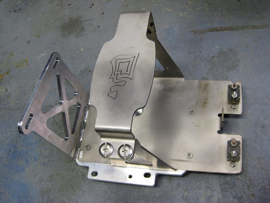

Great progress today on the final bracket setup using the modified stainless steel bracket from my 4th Gen and that aluminum bracket I recently bought.
The Optima was for a test fit as I've not decided which battery I will drop in. The Blue top is pre-Mexico production and is 9 years old but doing well.

Second battery bracket installed:
The battery is actually an Odyssey PC1500 that was private labeled for Sears as a DieHard Platinum. Almost 5 years old and seems to be doing well.
This battery will be used for the fridge and the two way radios. It is maintained by a CTEK 250S Dual. (I recently upgraded to the "SA" version).

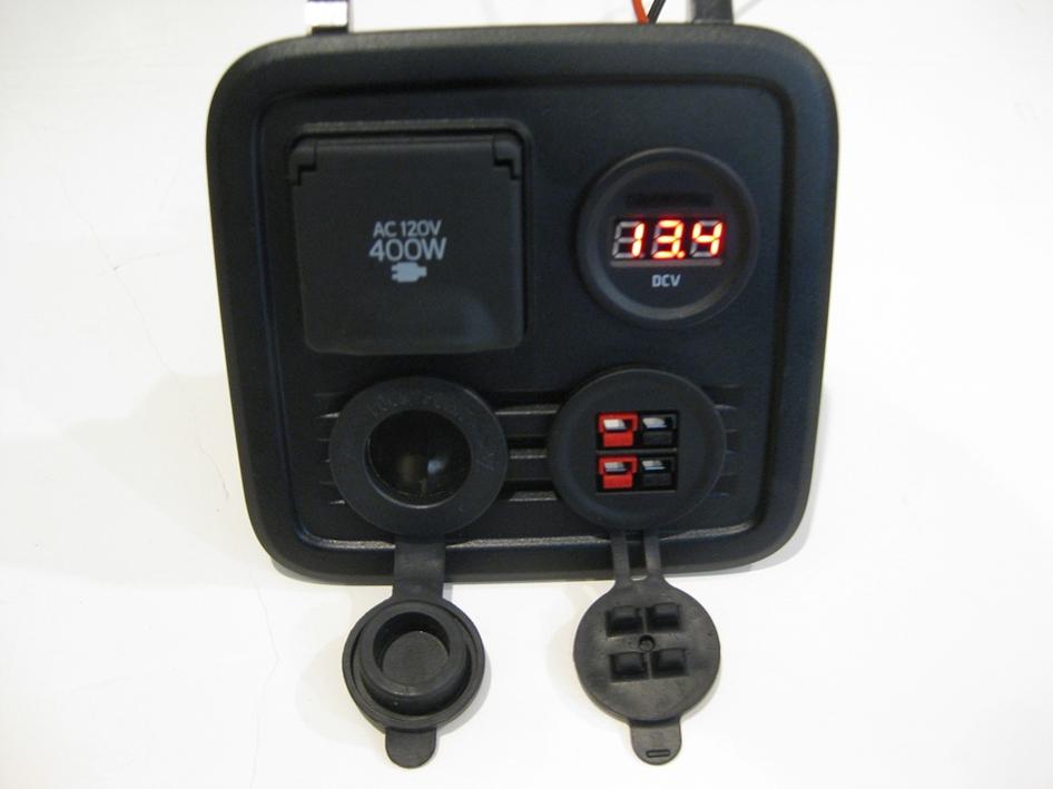

Here is the Toyota AC Power Outlet Panel modified for a LED readout DC Voltmeter, dual Anderson PowerPole outlet and high quality cig lighter socket. The meter pulls less than 0.009 Amps so I just leave it on all the time.
Radio is installed and plugged into the PowerPole outlet. I also modified the Engel Fridge power cord to use an Anderson PowerPole.
