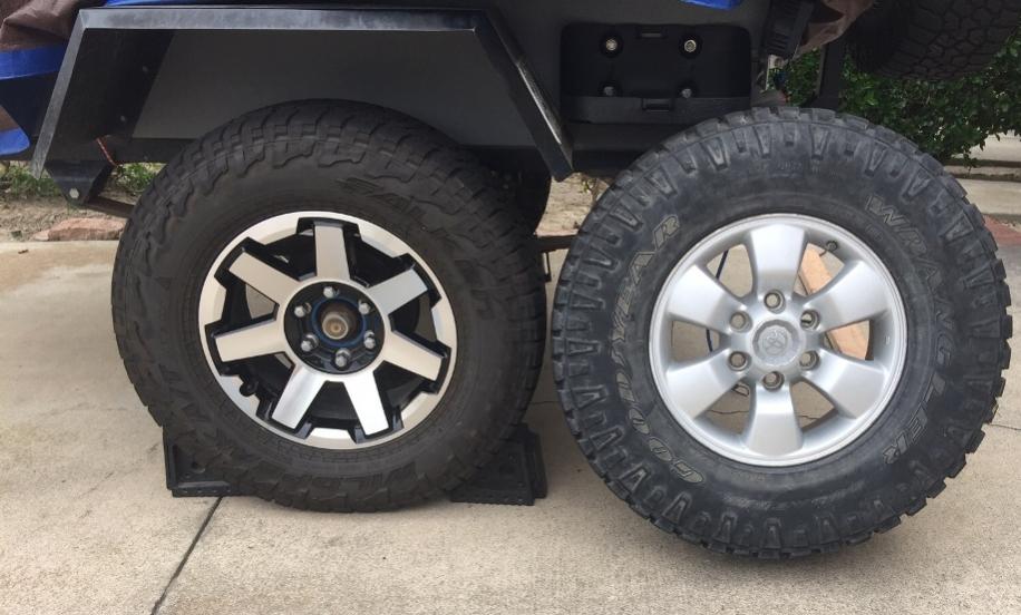

I've been watching Craigslist and have not found the rims for less than $100 each. When I had my 4th Gen I found 16" rims for $50 each and the new Duratrac tires for $100 each. The tires on the trailer will last a long time so no need to throw them away yet. But Pat likes to treat me like Antman treats him, LOL. :thumb:
Digging the build. If you're still looking for matching wheels for the trailer, I have three with stock tires in good condition!
Thanks for the compliments! I need to post some updates ASAP
Where do you live? I will only need rims because stock tires clog too easily with mud and the trailer slides in mud instead of rolling, lol. Currently I have 16” Duratracs on the trailer and they work great.

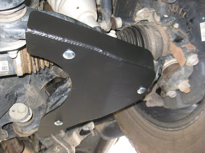

On the 2005 I had some Total Chaos skids for the lower front A-Arms. I repainted them and installed them on the 2018 4Runner

Will these skids protect the lower arms from boulders?
The Toyota A-arms seem pretty robust to me but I like the extra protection. These are probably fine with low speed impacts to rocks and boulders but the force has to go somewhere so you don't want to hit so hard that the impact damages the pivot points, shock mount or anything else attached to the lower A-arm.
