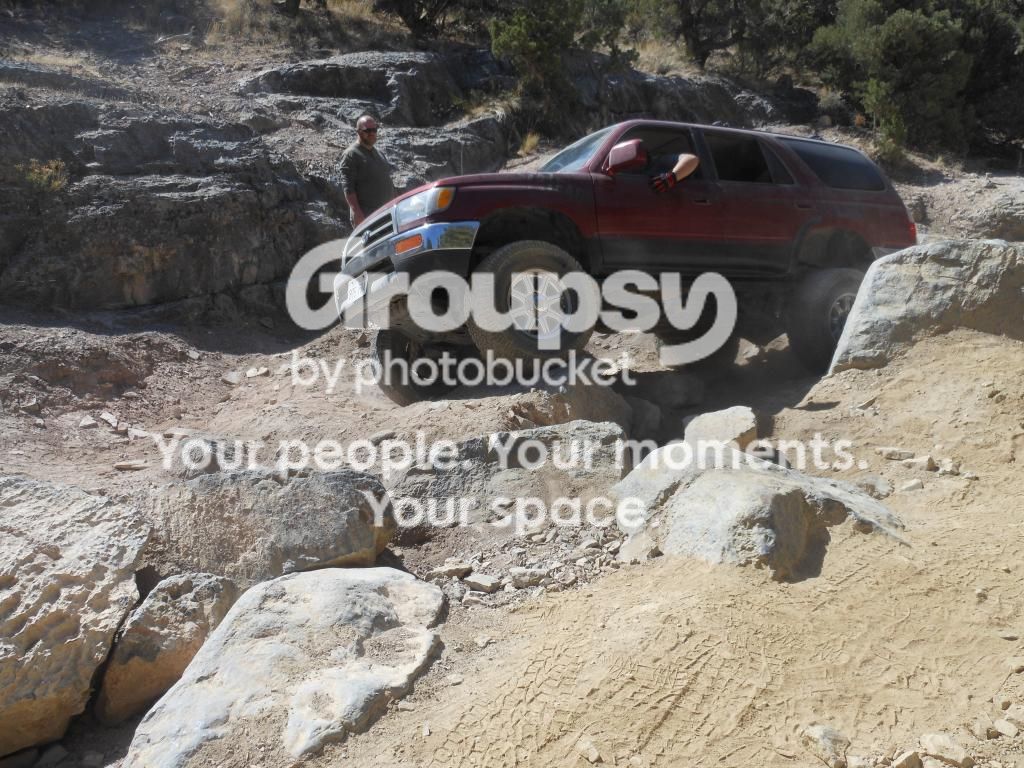

Before we headed to Moab I found a set of used 285s on some alum wheels to run.

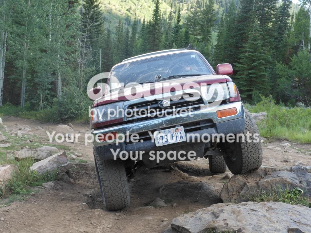

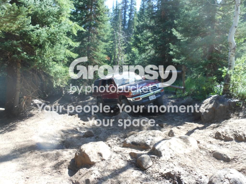

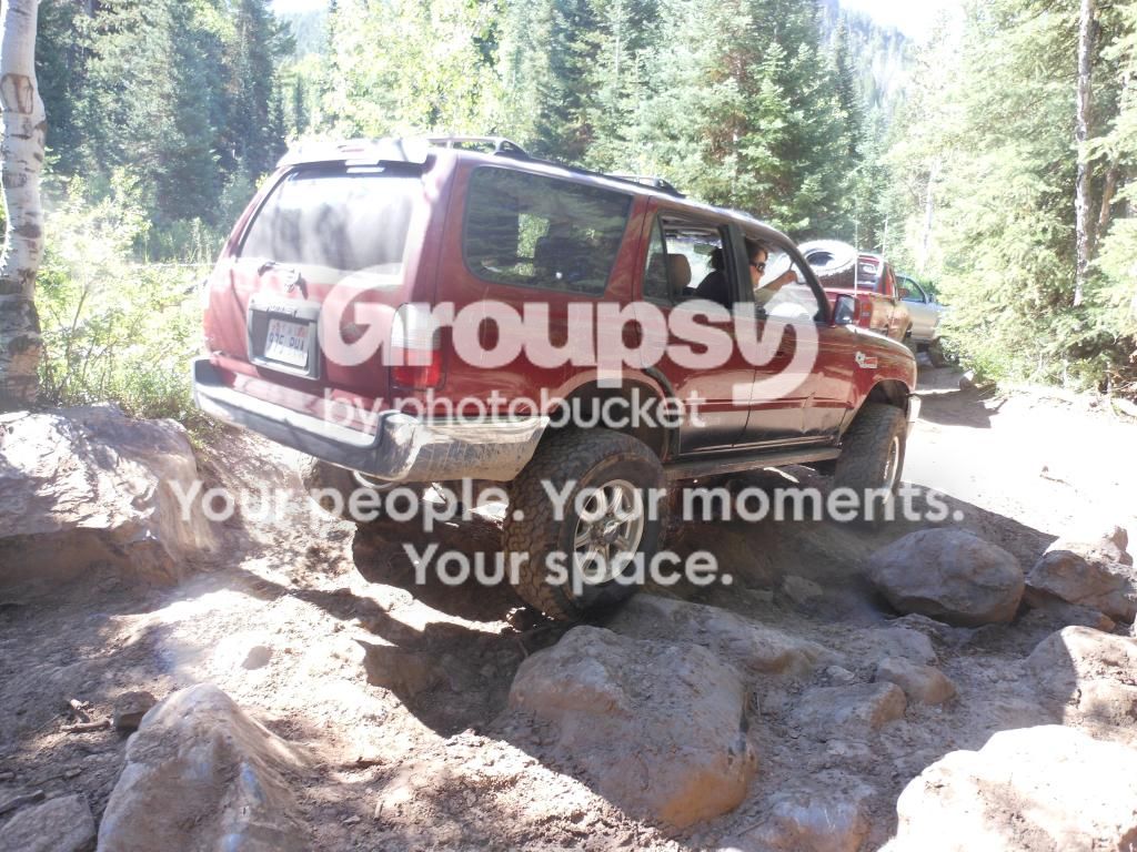

This is Long Canyon Trail in Moab
Strike Ravine!
Fins n Things!

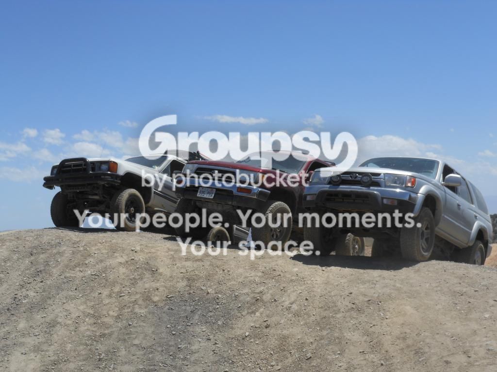

Hit Rattlesnake with the, then new, 4Runner club Desert Runners.

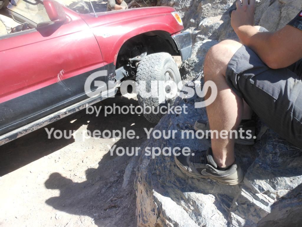

Damn rock got my door

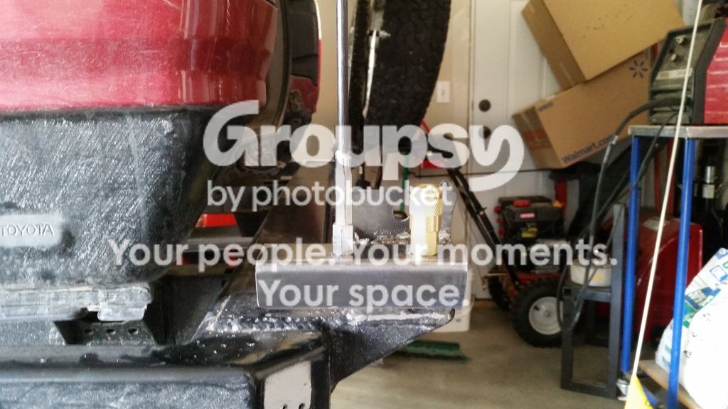

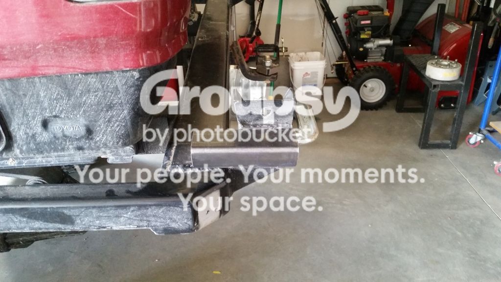

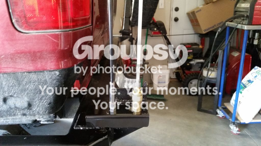

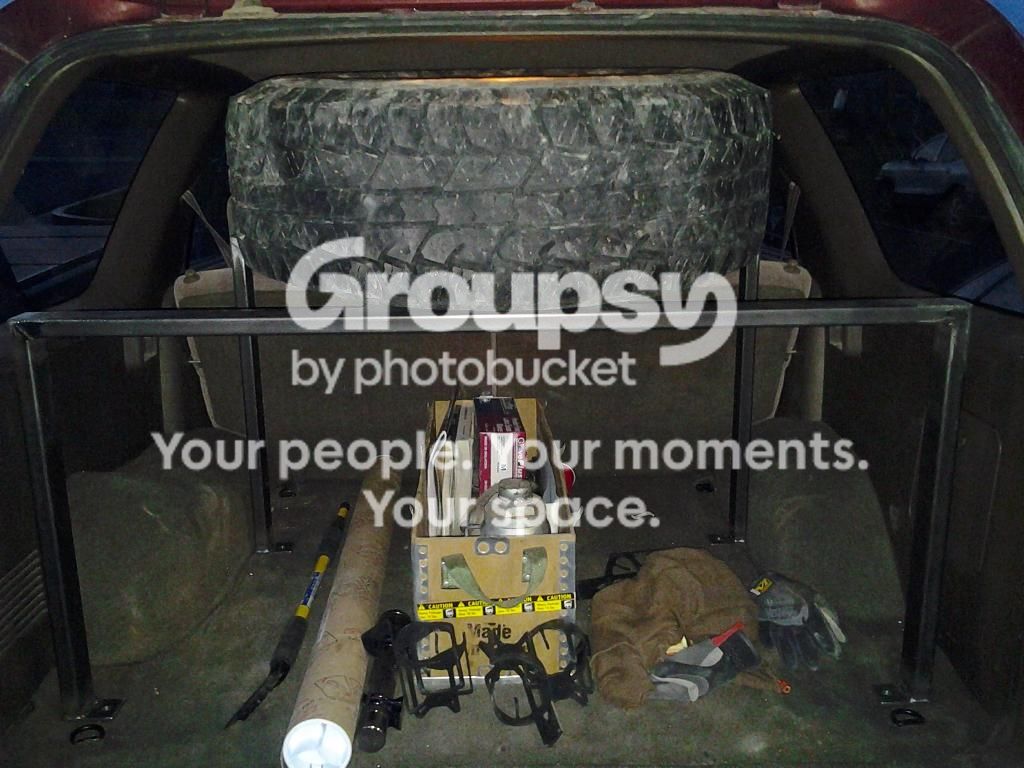

After That I built me a spare tire rack for the cargo area!

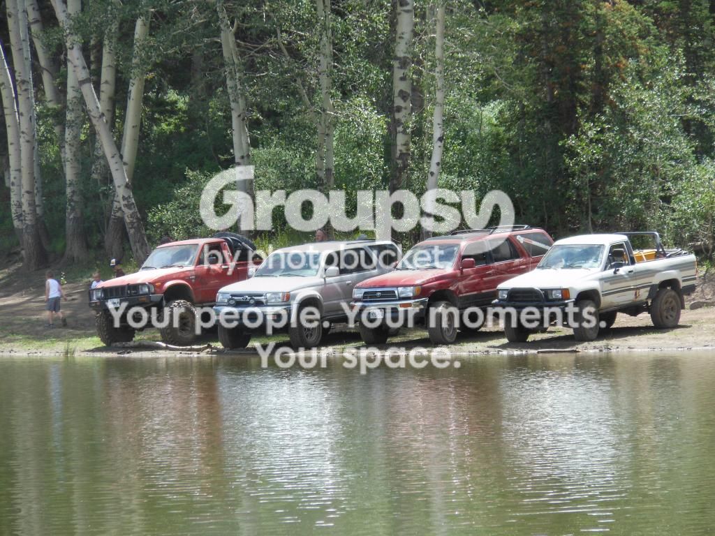

Then it was time for another Desert Runners run at Forest Lake!!

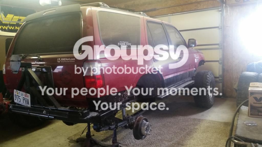

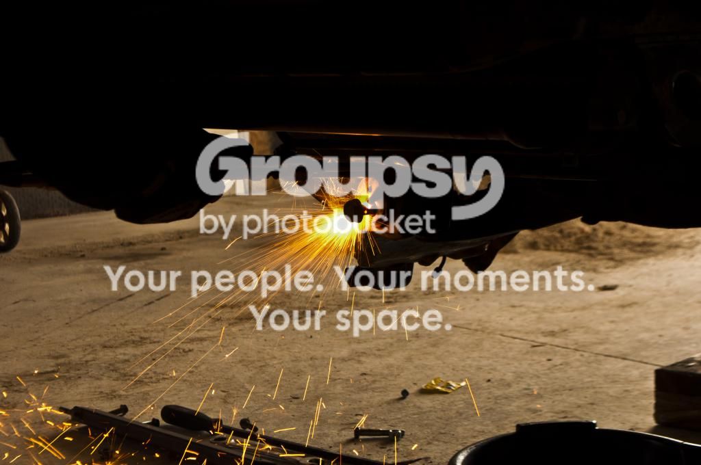

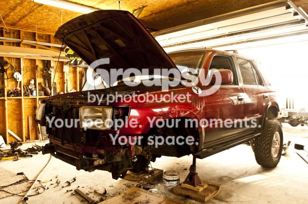

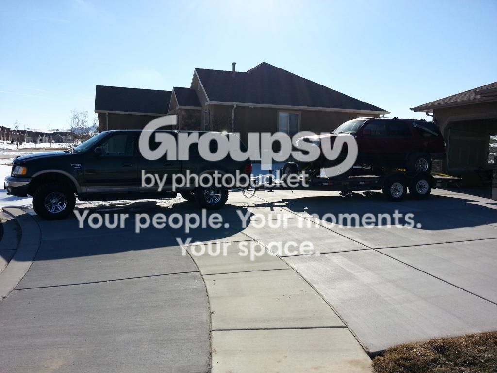

While in Moab it finally happened. I destroyed my front end, and my rear end. So it is time for my SAS!!!

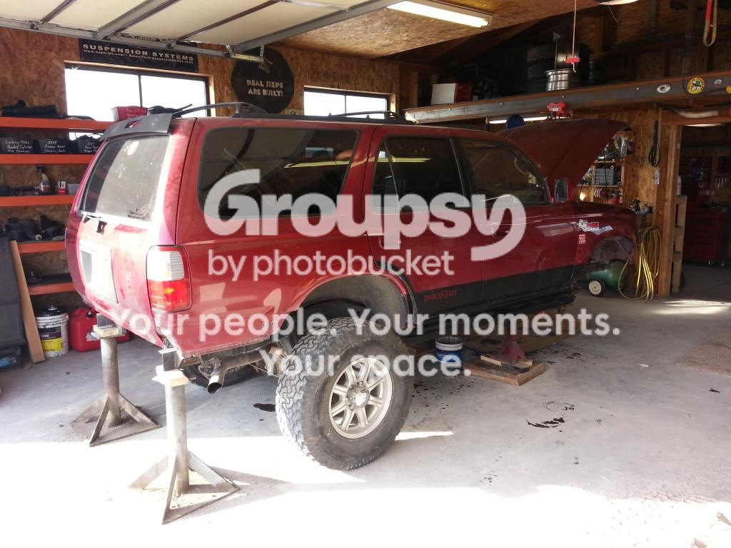

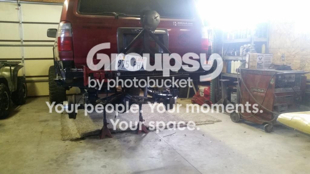

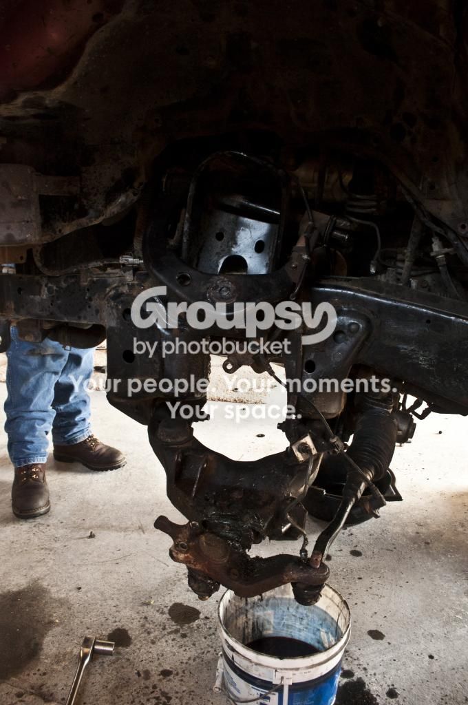

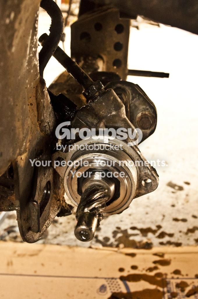

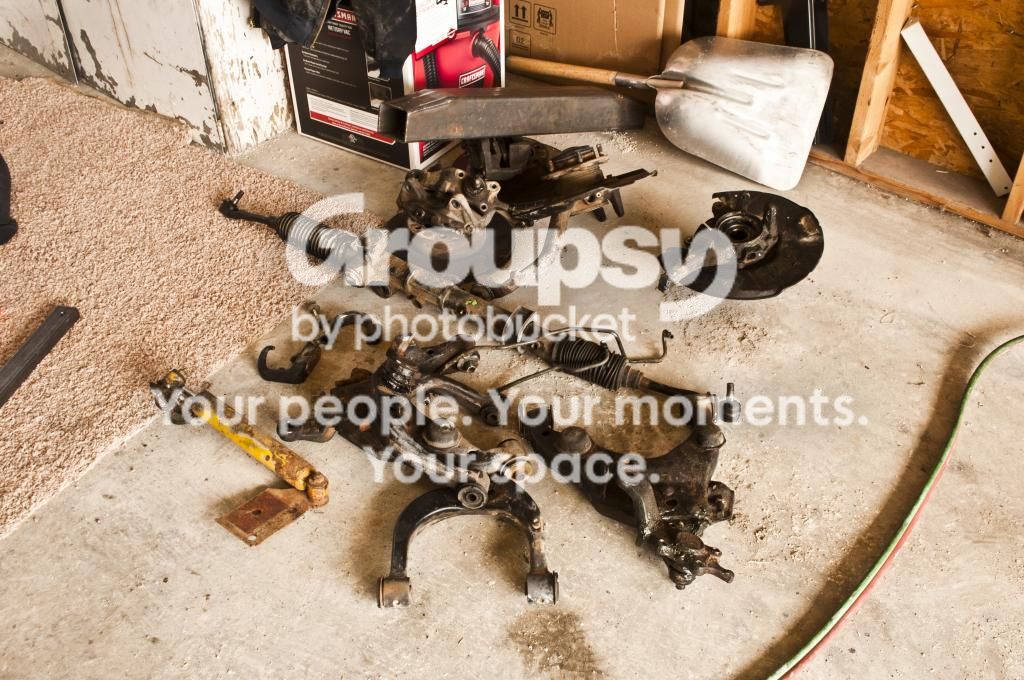

I started to tinker around with it in my garage before I hauled it to my dads shop.
and Started collecting parts

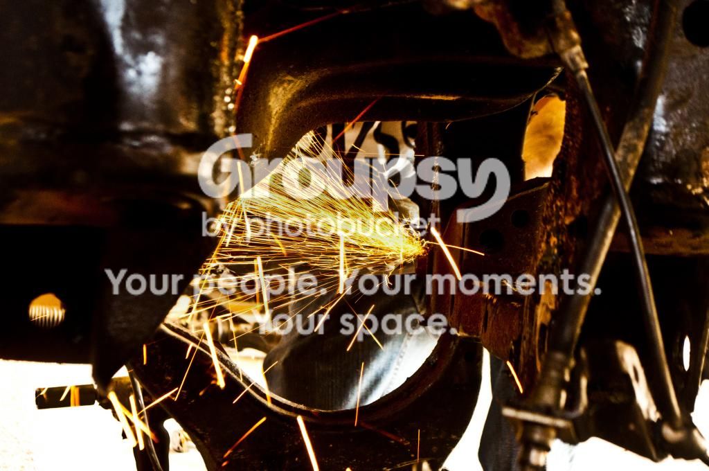

Hauled it up to my dads garage and started to cut!!

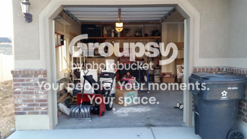

There are some good things and bad things about using my dads shop rather than my one garage.
1st its not in my way while we under go the project.
2nd he has a lot more tools and supplies than I do.
3rd we can make a mess of his shop not my new garage.
the only bad thing is it is 2 hrs away. So I can't work on it every night.

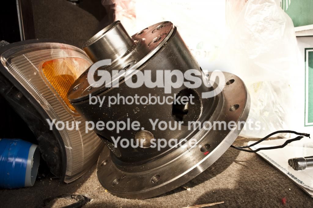

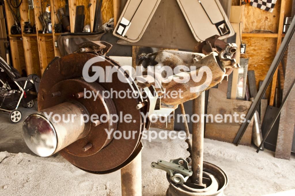

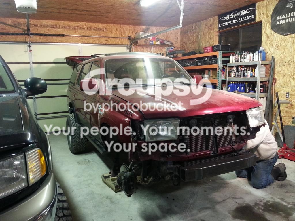

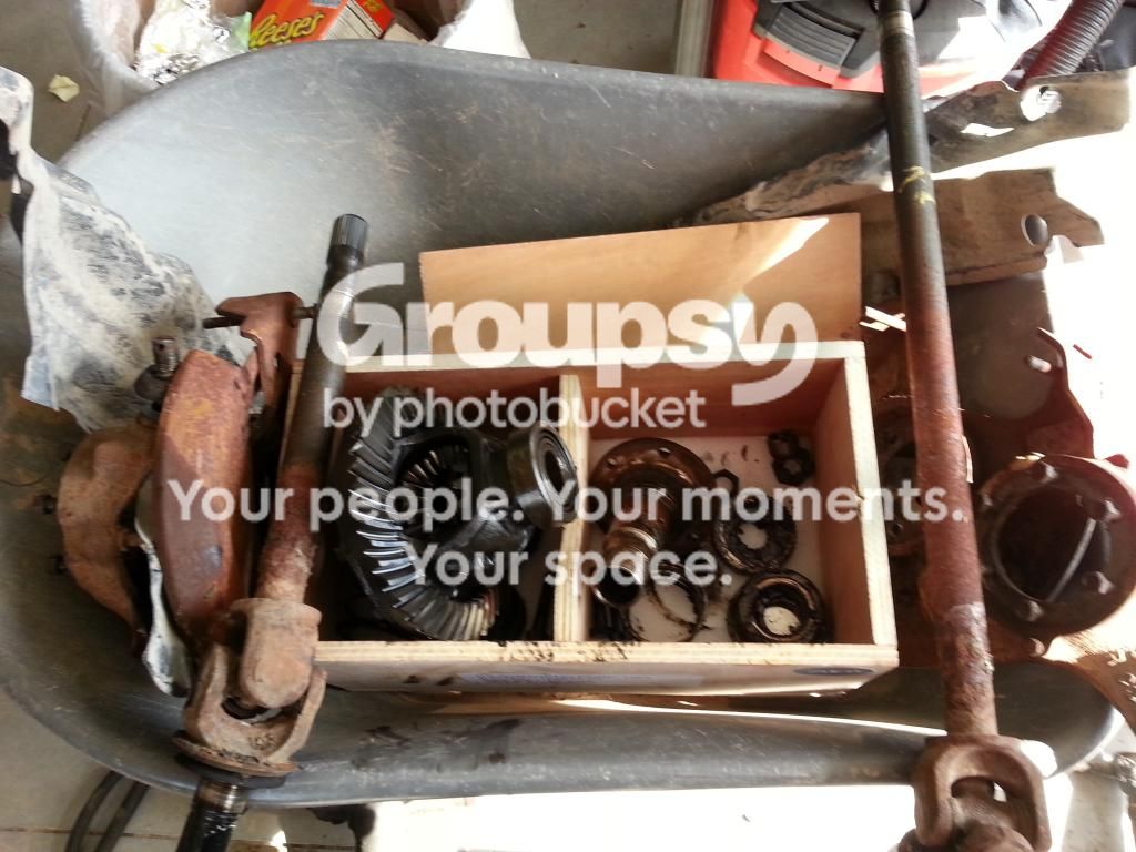

Most of the parts I have come from low range (I work 2 blocks from the shop). Gears from Randys. Elocker came from a user on rme4x4. Axle is a Dana 44 from an 87 waggy. It's him in my garage I will get some pics this afternoon.

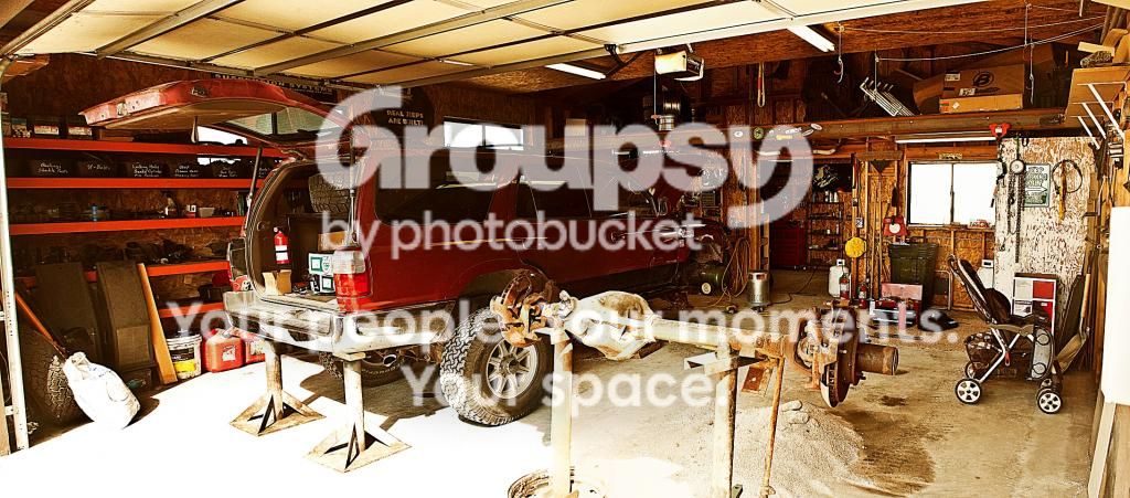

Here are a few more pics of the first SAS Wrenching party we had!!
We did make some good progress..

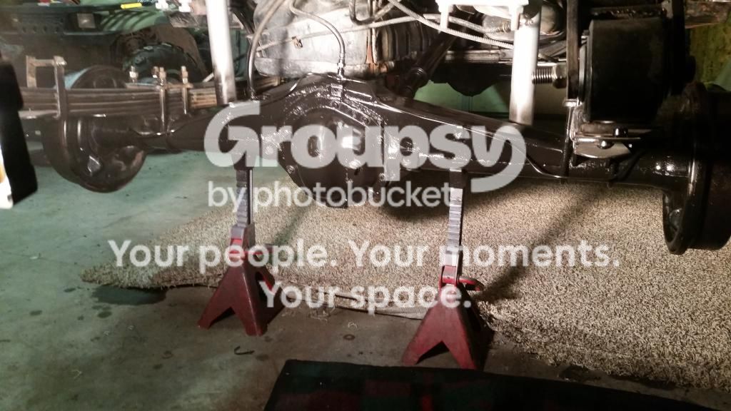

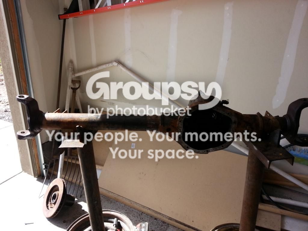

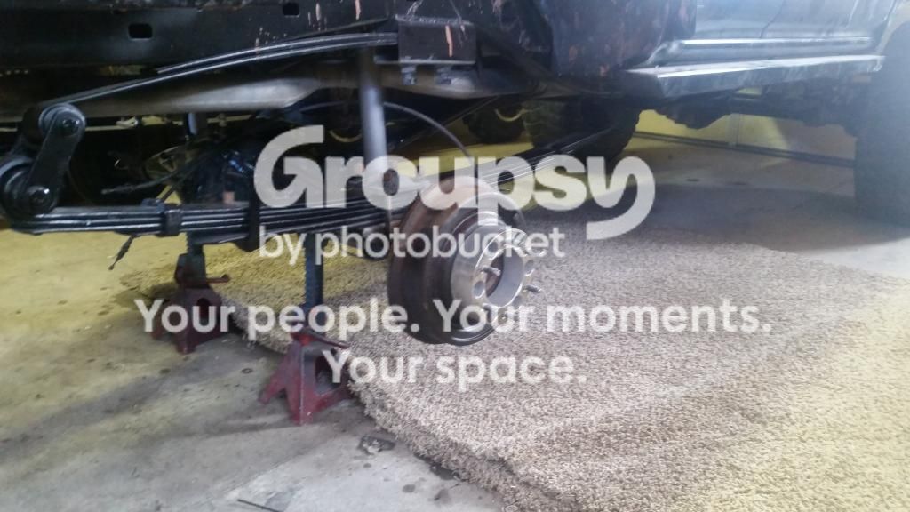

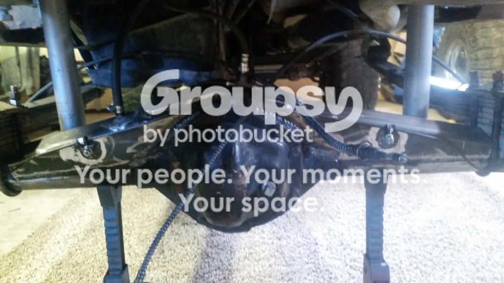

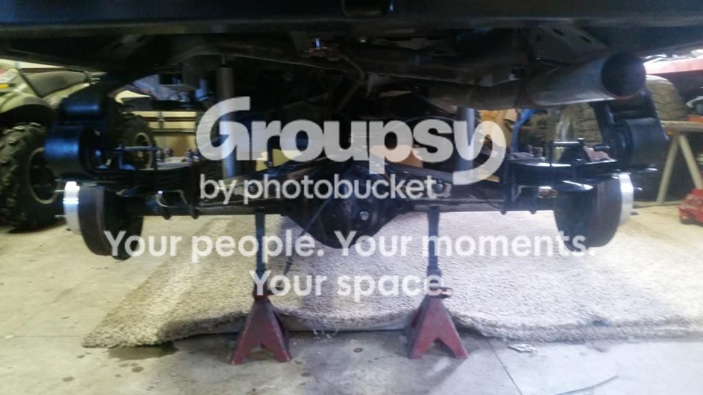

A couple pics of the axle as it sits now.
[/URL]img842/1244/20130415170033.jpg~original[/IMG]

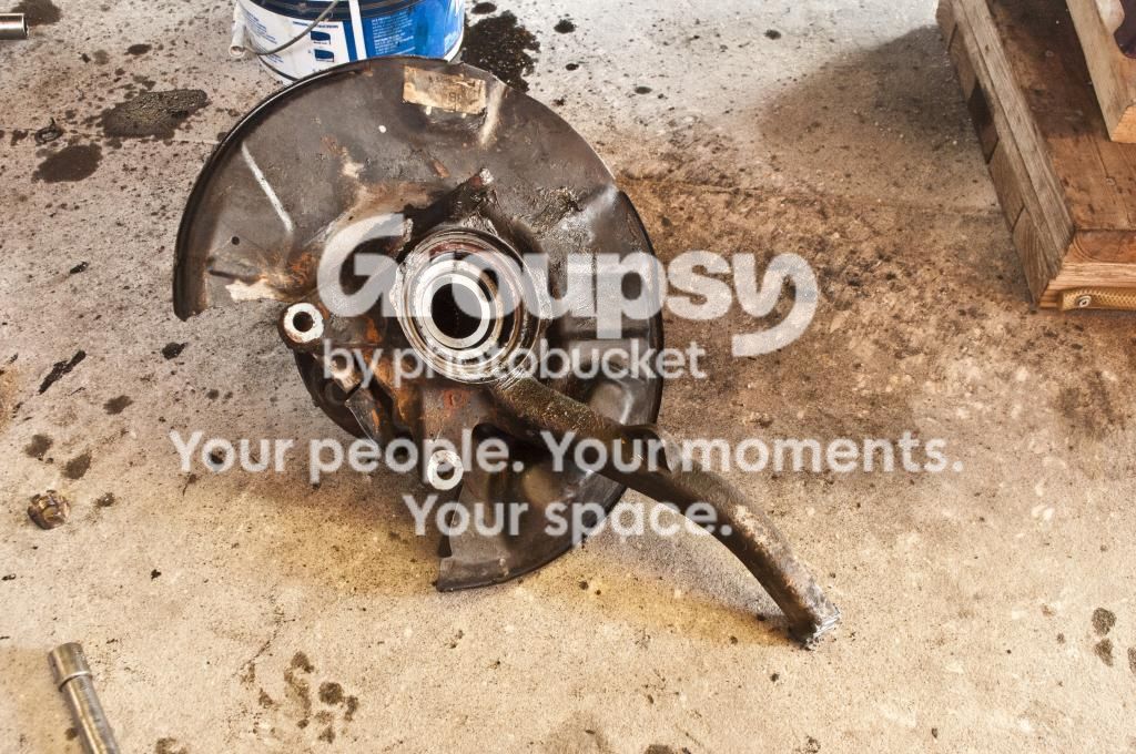

I do have Flat top knuckles and high steer arms that will go on with the rebuild. Along with the Auburn Ected locker to complement the Toyota E-locker that is in the rear end.

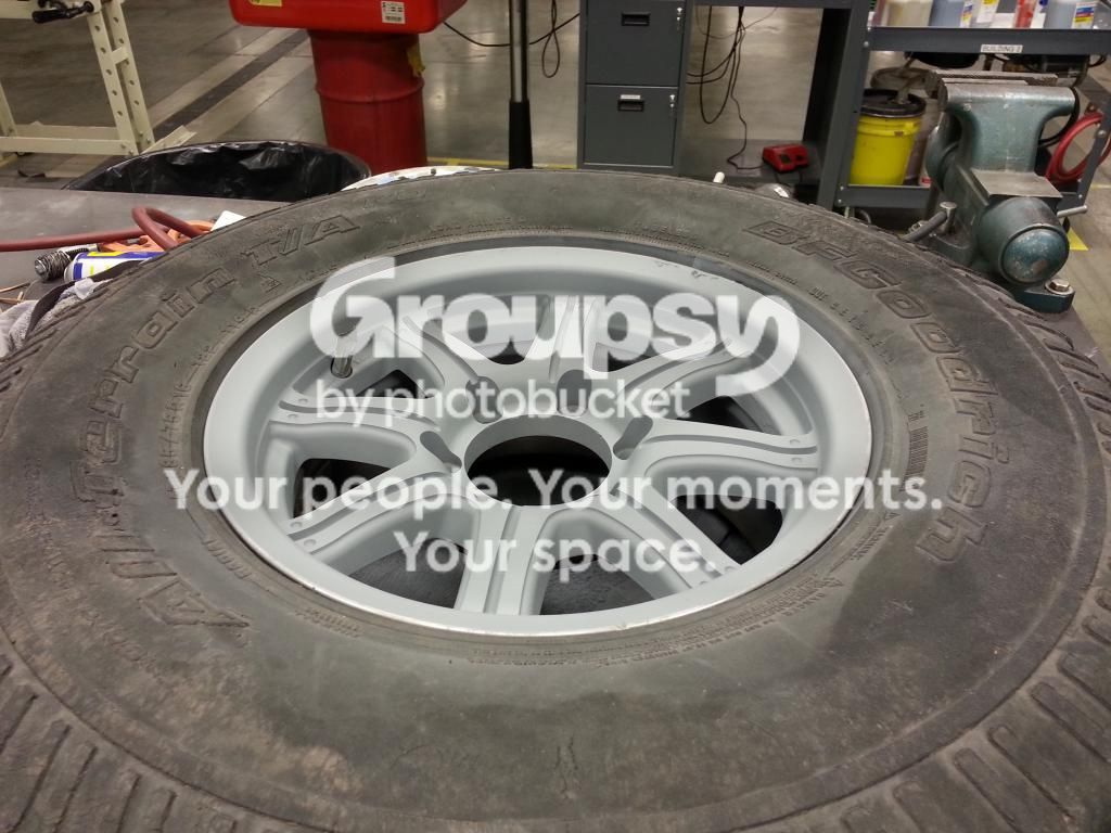

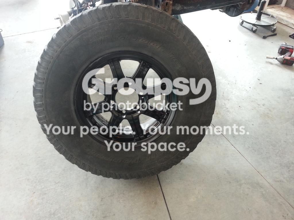

My little bro stole my tires and wheels to run on his truck. He said the 37" TSL's were working his 22r to hard.
The problem is he didn't paint the other 2.
Looking at his truck I think the black will look pretty BAD ASS on my runner with my black accents.

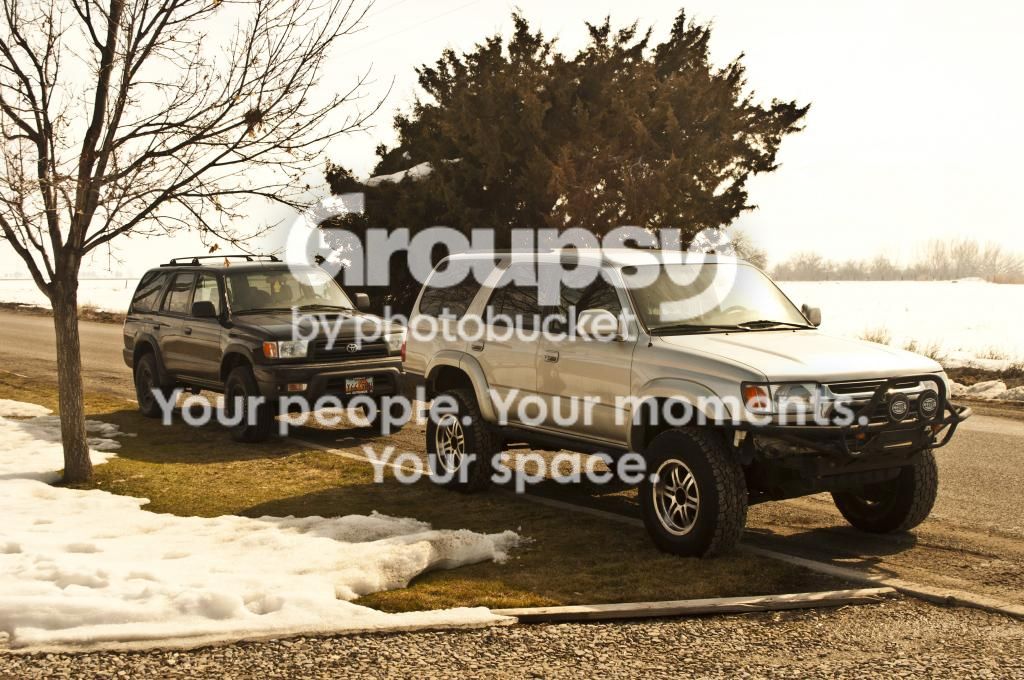

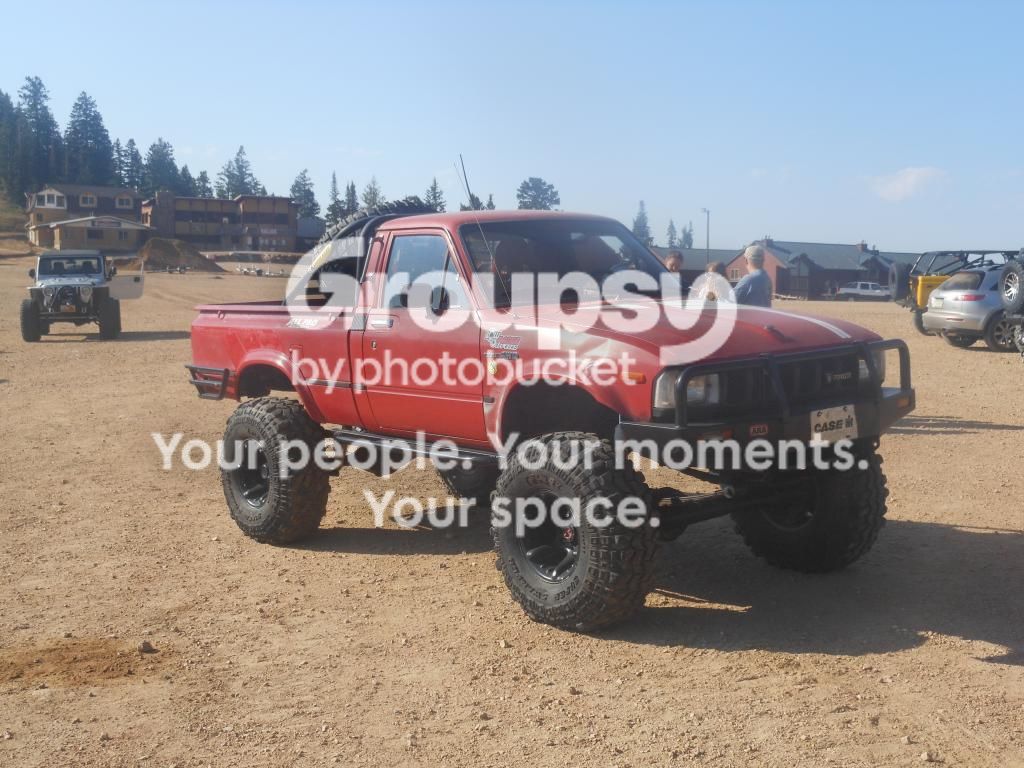

I guess you guys don't know my brothers truck. Here it is with his tires and wheels
