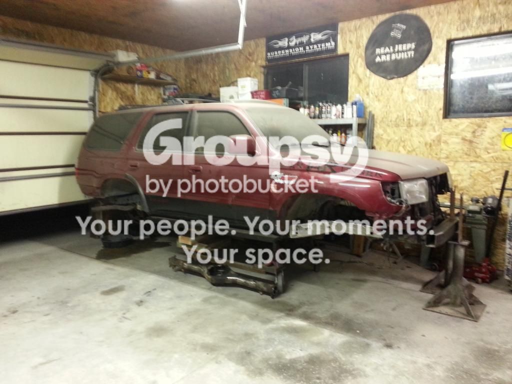

Got a little more done this weekend.

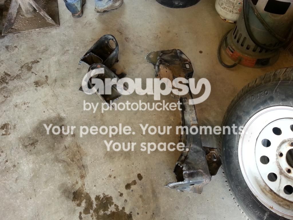

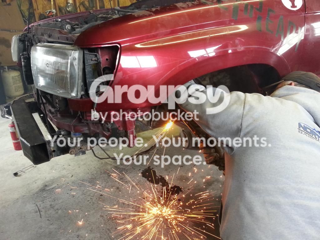

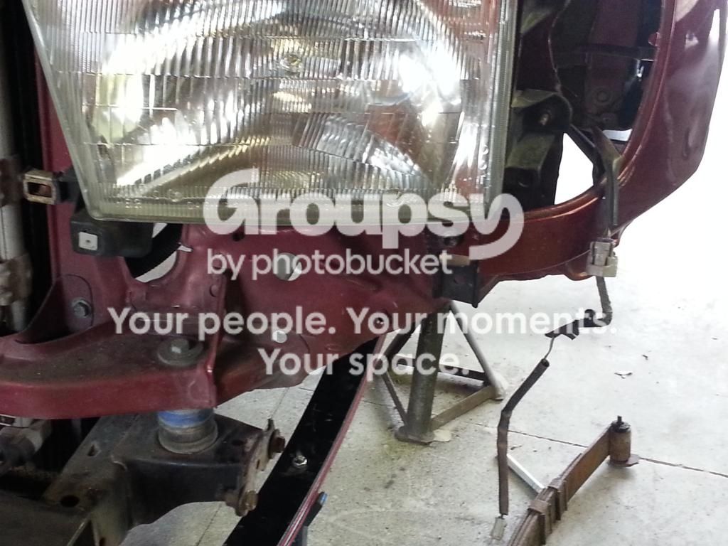

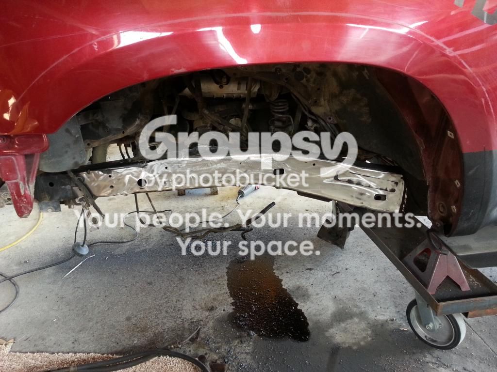

Finished the IFS out. Then ground it down clean!!

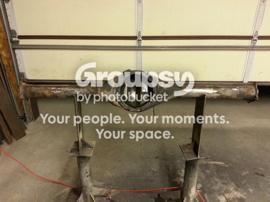

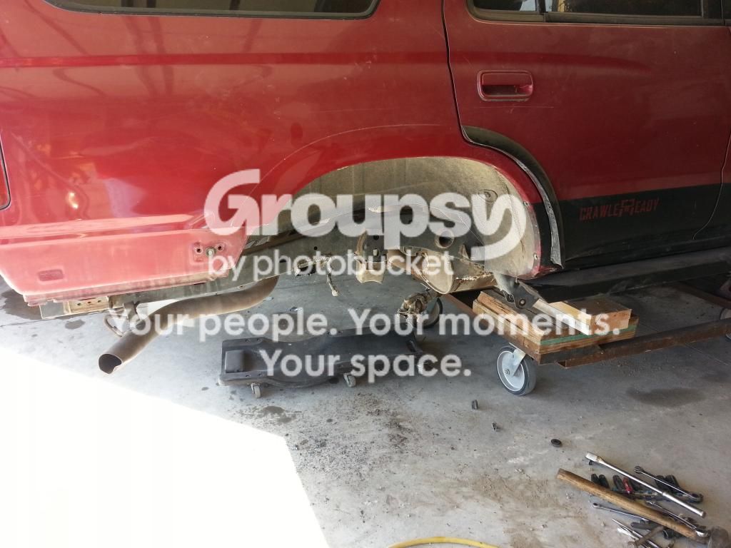

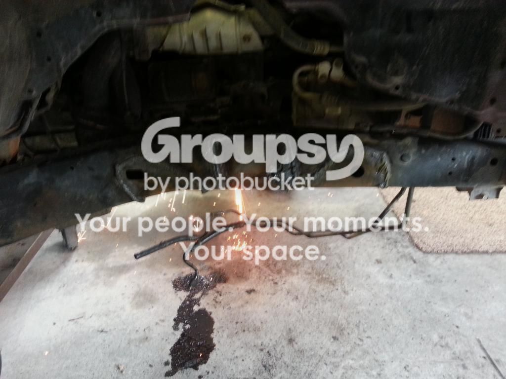

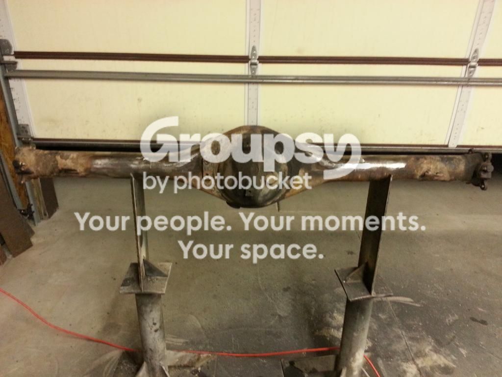

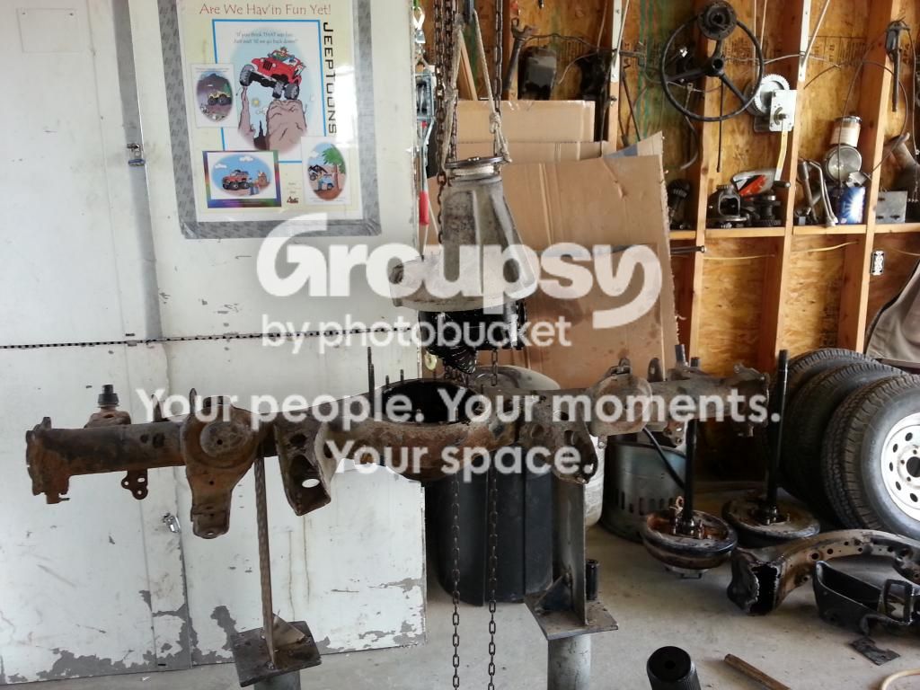

The good welder was tied up on a business related project so I couldn't pull it away. So we started tearing down the rear end.

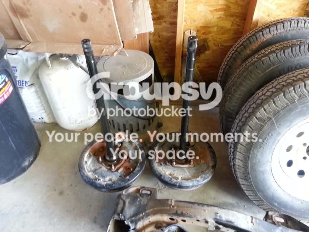

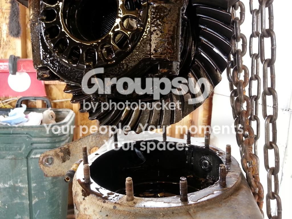

My dad was itching to get the 3rd out to see what kind of damage we did in Moab.
I don't see anything wrong with it! :lol:
We considered ourselves lucky, the locker seems to be A-OKAY :cheers:

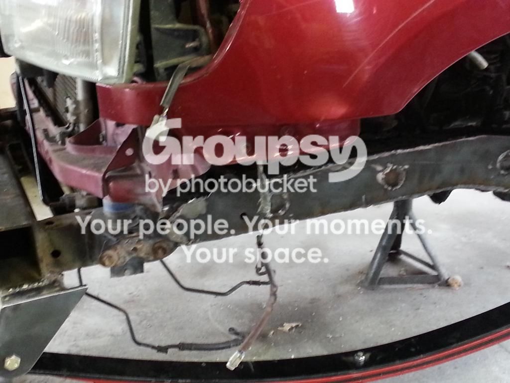

Once it was out we cut all the suspension crap off and ground it clean.

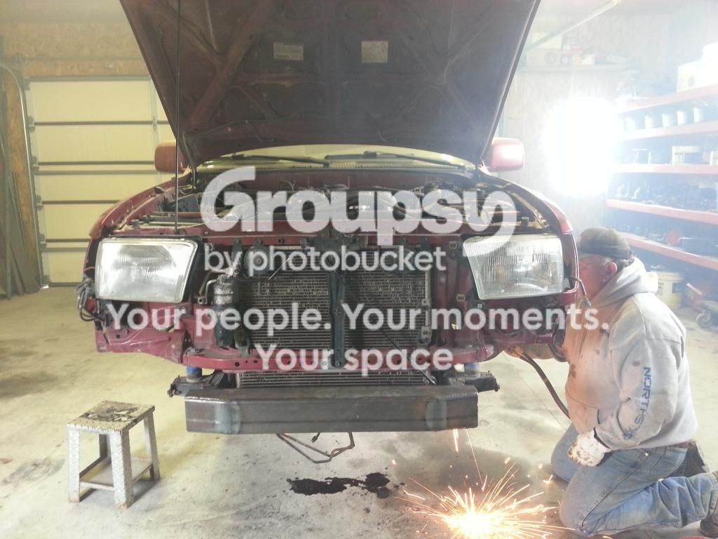

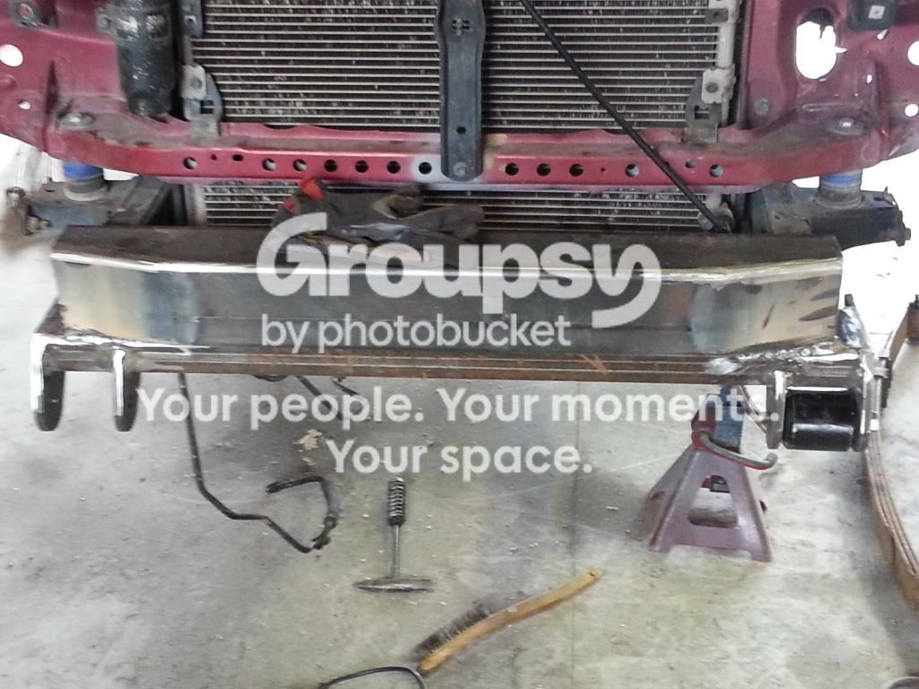

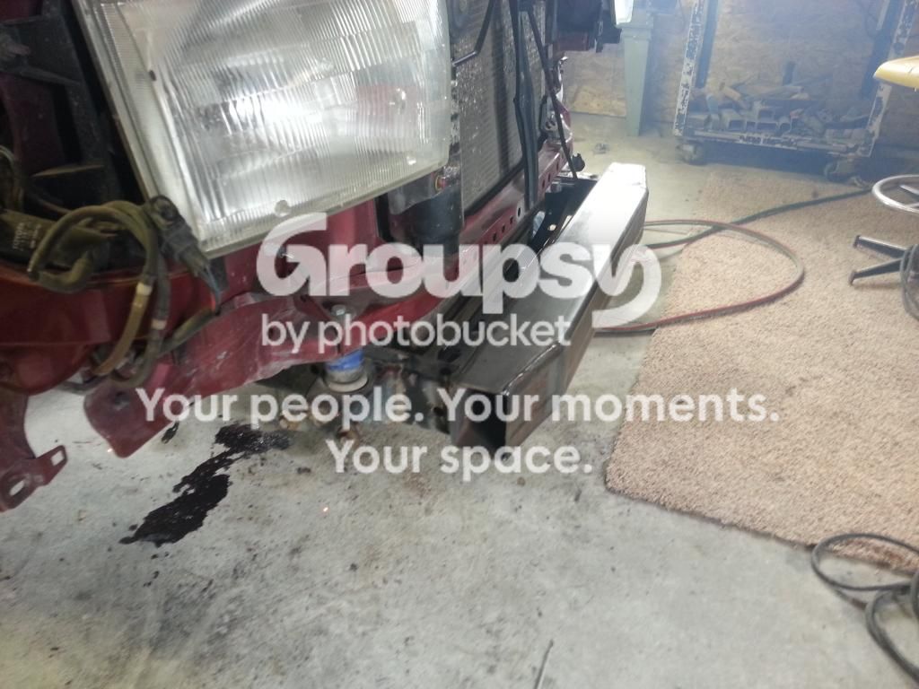

I did get the start of my front bumper welded on!
So here she sits again awaiting me!

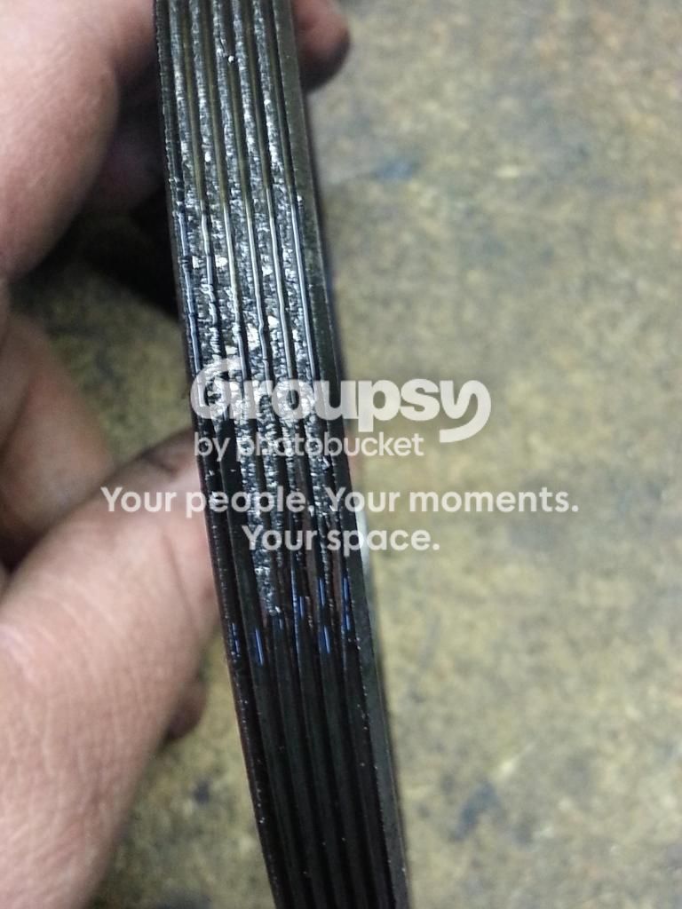

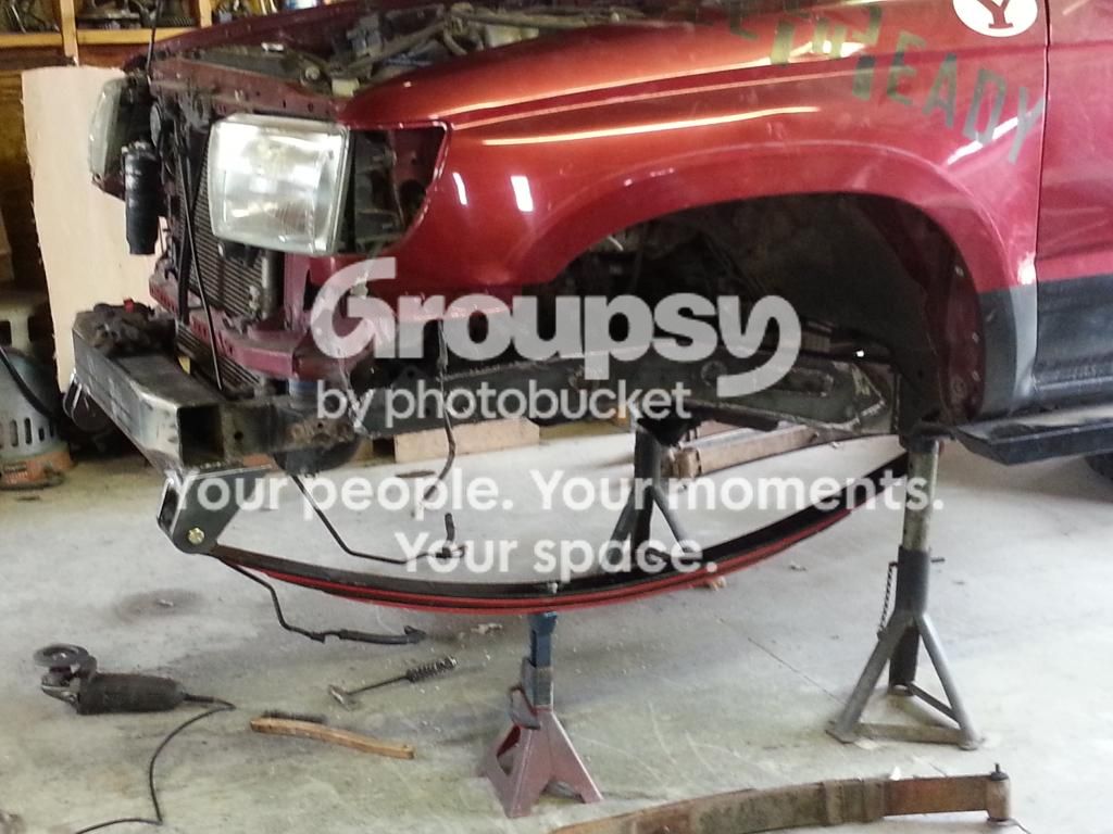

So got a Little done this weekend! *Not a long list but didn't work a real long time on it. *Basically I got my Toyota 3rd member torn apart. *I think I will stick with it just based on the fact that I have all the stuff to do it. *When I pull it apart thou I found one of the adjuster nuts is shot. *Effing dealership item. *I think I will order one online and save a little cash. *Other than that Brady spent some time cleaning my front end with a wire wheel. *Didn't get any pics of it but it looks good. *I spent my time getting my front spring holder built and mounted. *started mounting the front springs then decided I need shorter springs. *The ones I have (the ugly red ones) put the back end damn near under the tranny cross member. *If any one has a set of 50" springs let me know. *Did a little fender trimming and a lot of measuring. *I think there will be a lot more fender trimming in the future. *I didn't get many pics but will post what I have a little later.
Here are a few pics of what I Brady and I did Saturday.

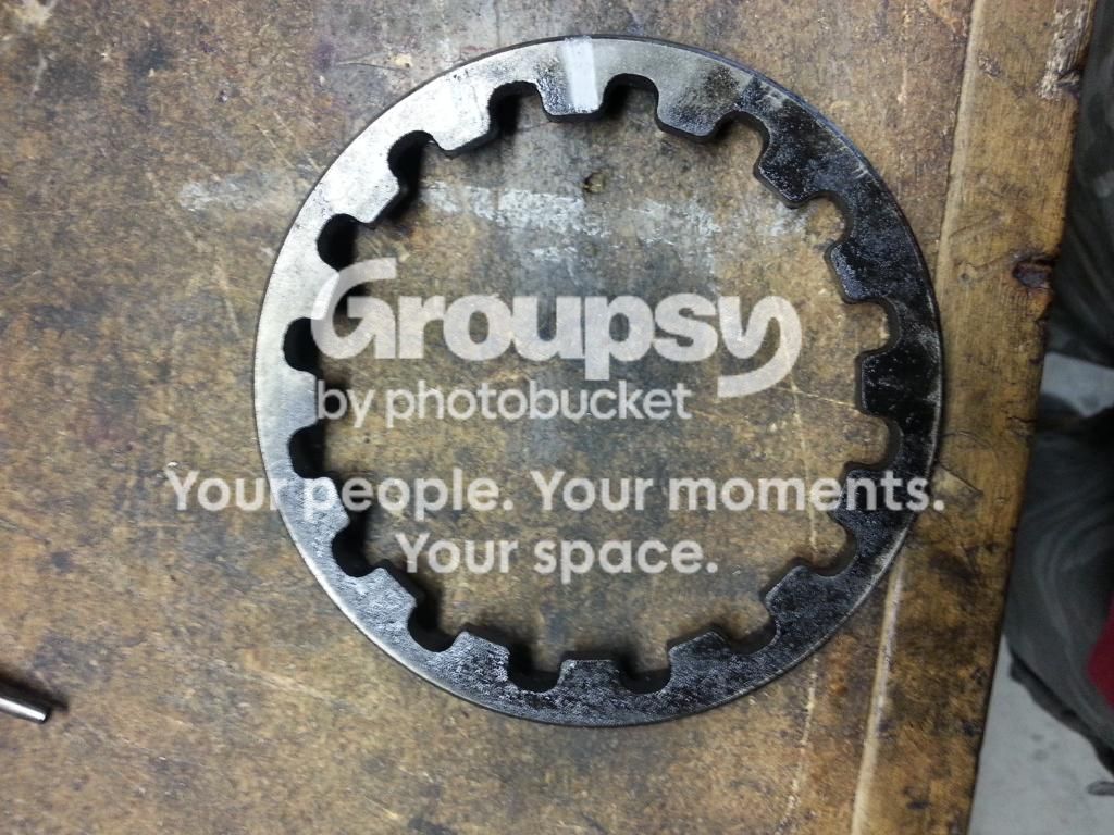

This is the adjuster nut that is shot. *I'm having a hard time finding it online. *I might have to go to Brent Brown and at least find the part number. *I guess I could call Kurt.
Got the spring hanger built and mounted!
A little trimming

Got a little time to work this past weekend. Literally a little! The springs I had for the front end ended up being way to long so I got some different springs and had to move the front hanger back a couple inches. It pretty much sucked I had that sucker welded on there GOOD! I got that moved and mocked up my rear bumper to see where additions needed to be made. I also got my steering shaft all but buttoned together. I need to do a little fab work on it then hook it up next weekend.

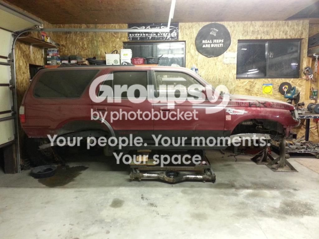

6:00 Saturday rolled around the family was itching to get on the road so I ended up with a 3 wheeler. *We ended up 2 u-bolts short and couldn't put the passenger rear tire on.
FRAME HEIGHT 23 Inches!!!! Hopefully with a little settle to come!!
