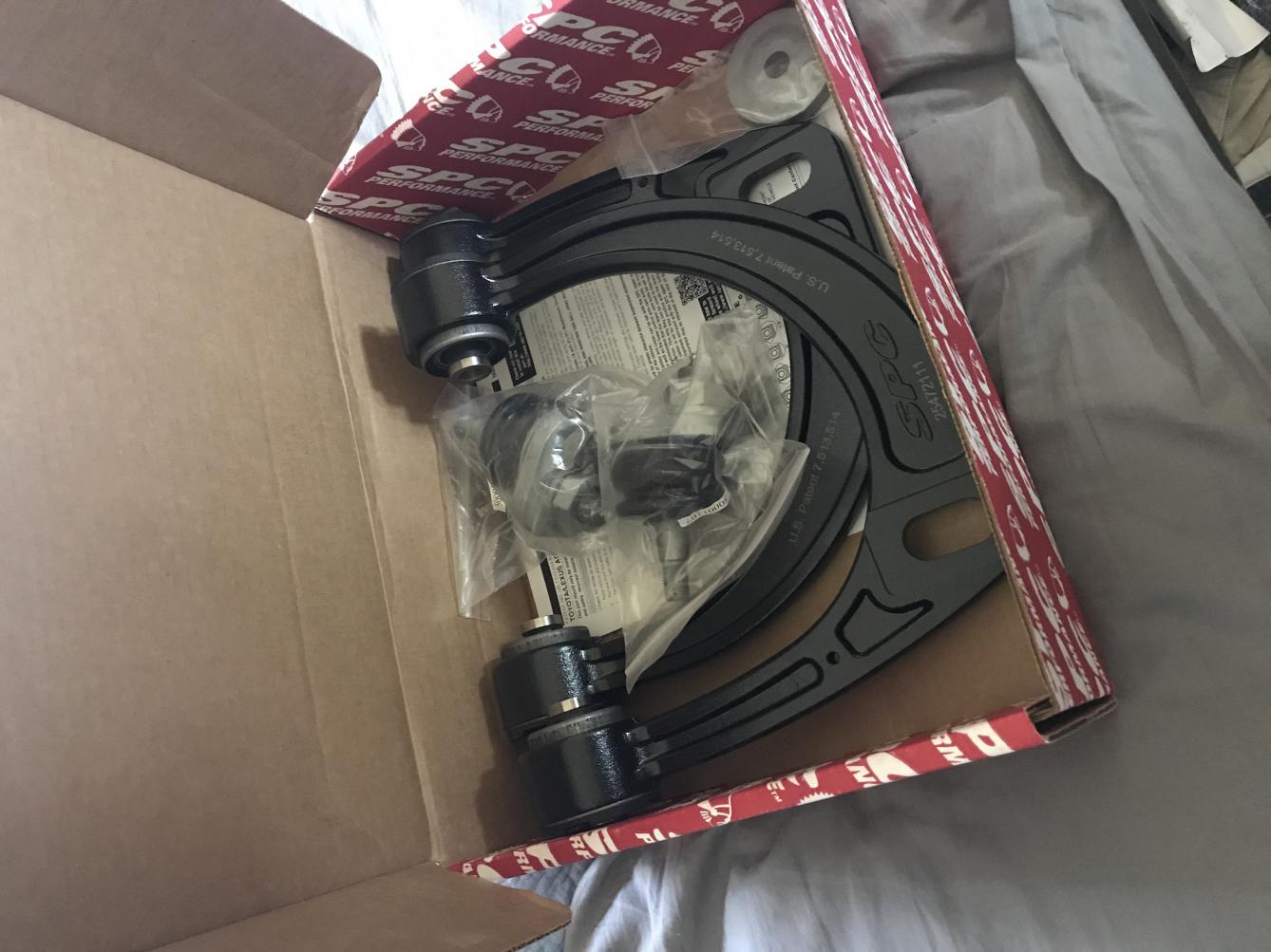

Also I just ordered some SPC UCAs today from Battle Born Offroad. They were having a great sale and I wanted to have these UCAs on hand to install during my lift! All thats left is rear shocks, and possibly a sway bar relocation bracket! Haven't made my mind up whether I want to just ditch the sway bar altogether though. I've heard of plenty of people doing this, but I do a decent amount of highway driving so idk...
SPC UCAs came in today!! Man these things are beefy and I can't wait to get them installed!

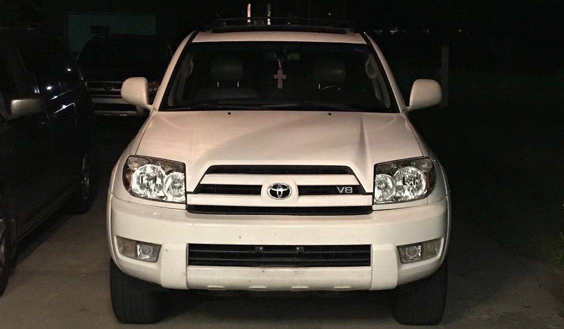

Just added some XenonPro led lows and highs today at lunch. 45w variant in white. Seem to be a very high quality light and all the seals on them were absolutely awesome. The fans are massive but also very quiet. I’ll take some pics tonight of the light output.
Edited to say-DO NOT BUY THE LOW BEAMS. They have terrible output in the projector housing. The highs are unbelievably bright though and put out enough light in the reflector housing to make it seem like you have a light bar on your roof.
I will be trying the Auxbeam lows that other have used once I get around to ordering them. The XenonPro Lows will be getting returned though.

Finally happy with the headlight setup. Auxbeams in the lows and fogs, XenonPros in the highs.
Also finished up the mod allowing fogs to be always on, and for them to be on with high beams as well. When you turn all three sets of lights on at once, it is quite bright to say the least.
