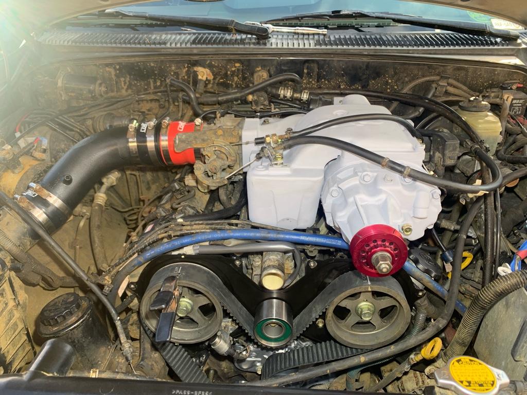

Anyone got pictures of how to hook up a 1st gen grey charger for the existing vacuum hoses and stuff. I just got done installing 2 knock sensors, knock sensor wiring harness, 295cc injectors, complete valve cover gaskets, and complete timing belt kit (belt, pulleys, cam seals, crank seal, water pump, 170* thermostat, k22 plugs). I have the diagram, but I’m a visual kind of guy. Any help is greatly appreciated. [emoji1686]
Charger is on. Just have to finish the timing belt.
