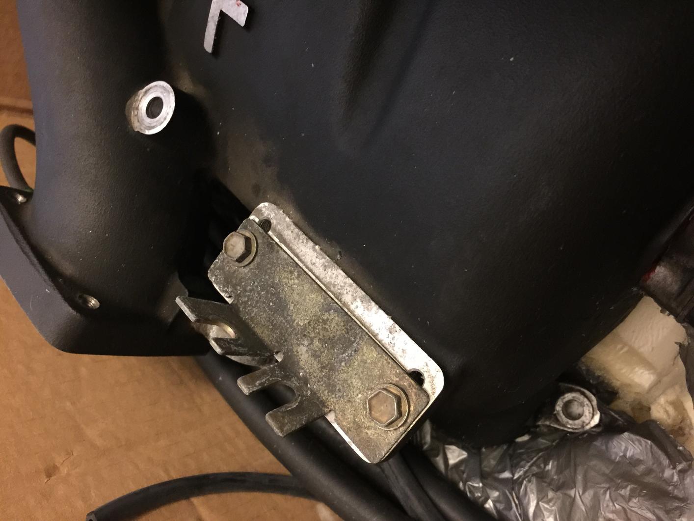

Heres a pic of the one that came in with my sc. could text me a pic of yours so i can get a frame of reference. Pmed you btw.

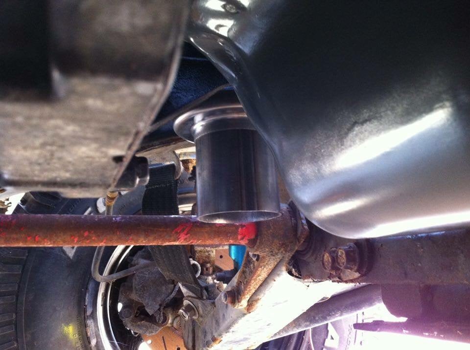

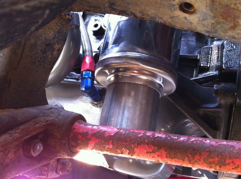

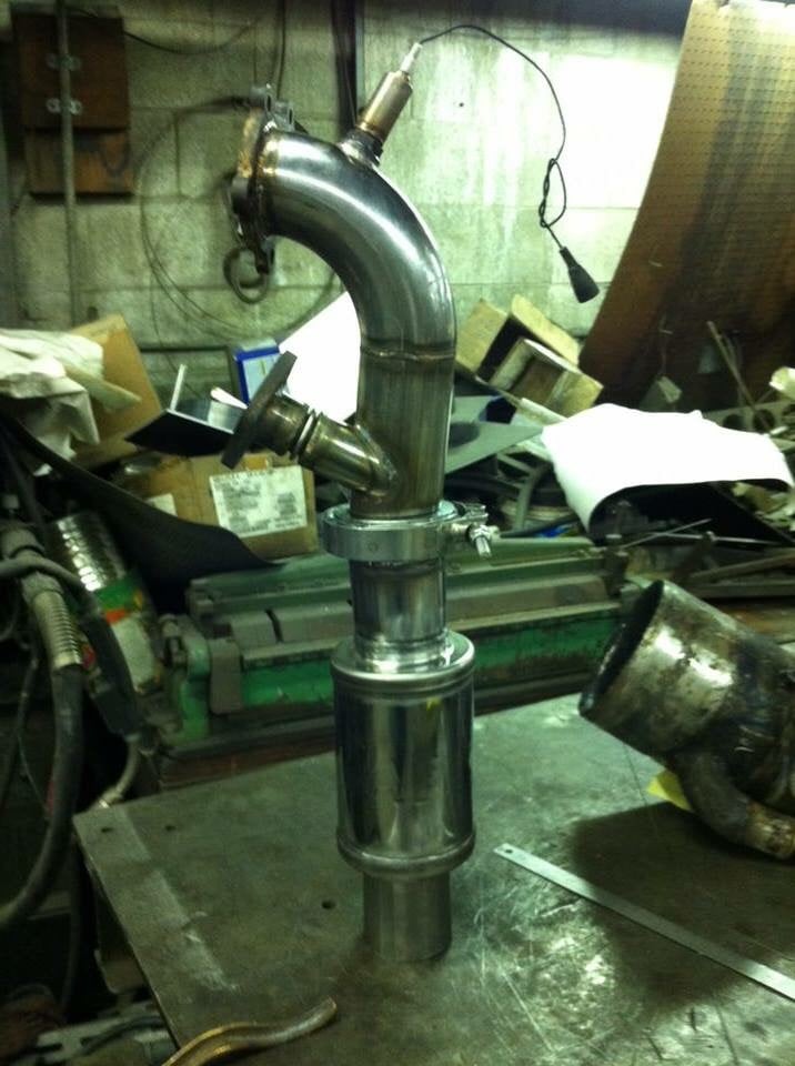

would it be a bad idea to have the exhaust exit too quickly and easily ? I'm planning on getting an exhaust cutout and running it right before the cat, which in return would be better then a high flow cat and cat back exhaust system correct? so in terms this would be the most free flowing exhaust but is there a downside to having it too free flowing and not having enough back pressure ? sorry if this seems like a dumb question
To little exhaust pressure and you will lose a lot of scavenging at low RPMs (like around town). I had this problem on my '87 4R w/ 22RE and had to rebuild the exhaust to get it back where it should have been.
Bracket measurements needed
This is everything that was included with my sc. Do you think I will need to buy any other parts other than:

I just purchased a used SC and the bracket was lost. Can anyone tell me what thickness the tensioner bracket is (like pictured above) and exactly how long the spacers are which are welded on the back?
Having a hard time finding the bolts too.
Good luck finding bolts. And info on it. Might be better to go buy a new one
