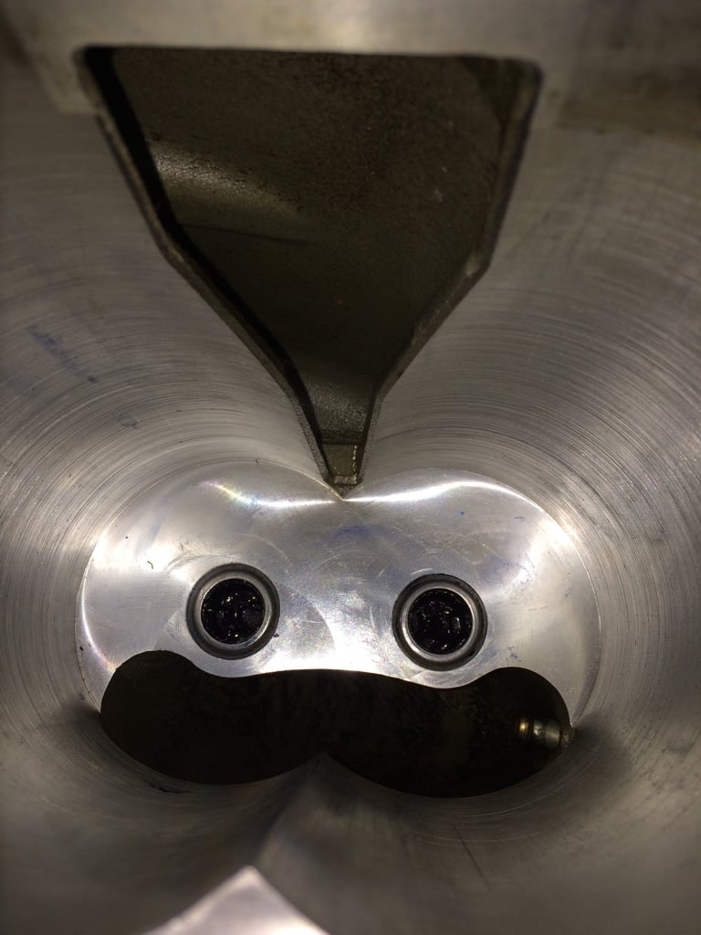

Busted open my newly acquired supercharger tonight to replace the rear bearings. I hammered the old bearings out of the back successfully with a 1/2 drive extension. I got the new bearings installed with the "beating with the back of a socket method" and they seemed straight until I tried to turn the rotors after reinstalling. I heard some slight rubbing and I'm almost positive it is because I did not press them in straight enough. Is there a better recommended tool for this possess? What type of press would I need to 1) install the bearings and 2) make sure they r straight
Edit: Decided to sleep on it. Woke up and installed the nose cone today fine. Although I did manage to overtighten one of the nose cone bolts and strip the thread. and There is still a little bit of resistance when I turn the pulley ( not sure how much resistance is normal) . I guess there is no way to really tell if its working until i install it.
