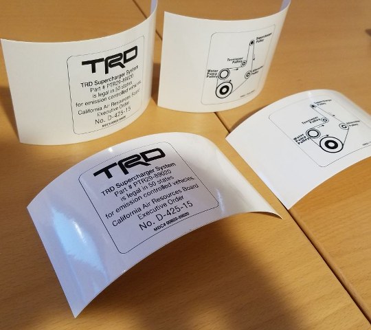

Not sure this has been posted here, but since I kept failing my smog test in CA due to a mismatching E.O. sticker for my 2002 4Runner, I thought I would mention it:
The E.O. sticker for a 2001-2002 4Runner with a super charger IS different than the E.O. sticker for the earlier 3rd gen models.
The correct E.O. for the later 3rd gen models is D-425-15, which must be listed on the sticker, and the part number for the sticker itself is MDC# 00602-89020.
Some posters have said you can print off a document and show it to the shop for approval, I tried and it has never worked, but best of luck. The sticker was $1.09 at my dealership after tax.
Can I pay you $5-$10 to get me one please???????
I had some replacements made a while back... Came out pretty good. Downside is that they are not pre-cut.

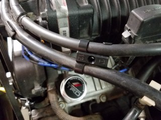

Some helpful hints for those sourcing parts:
The fasteners are easily found on mcmaster.
For the IAC check valve, I found the following Toyota # is still available for about $8 and works: PTR29-60031 (dont forget it has to be oriented such that air can flow from TB to engine)
For the vacuum adapter tee (4WD), I used these. You can find them on ebay by searching "1/4" x 5/16" x 5/16" Hose ID Black HDPE Tee"
For evap canister to throttle cable clips, I used mcmaster #7429K45 (pic below).
