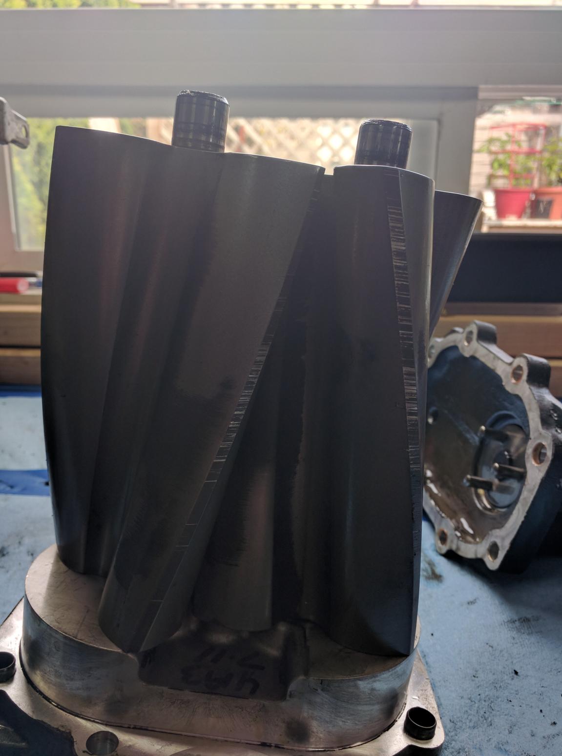

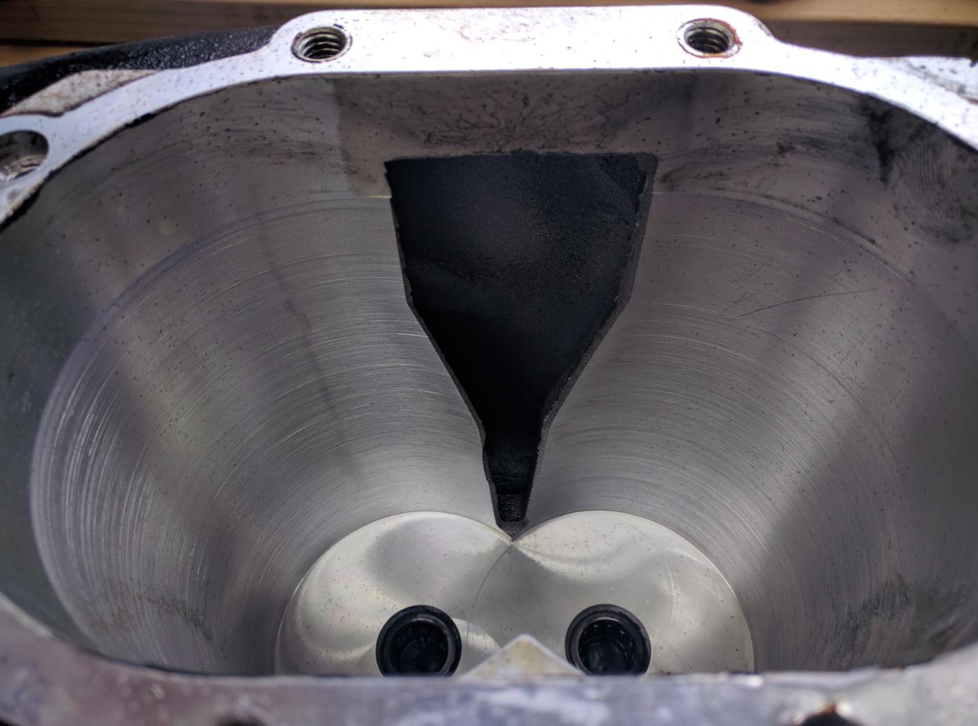

Could use some help or more like advise. Started tearing down my supercharger when it sounded like the bearings might be toast. When I opened it found this...
I would assume its salvageable, but what do you think?

Yea I figured I was going to be loosing out on some pressure. I would assume there is no real way to save the housing at this stage?
That is probably a question for one of the more professional refurbishing companies.
My SC was exactly the same when I tore it apart. I replaced the whole rotor assembly with a new one though. I'm still getting 7.5psi at WOT and its working fine.
