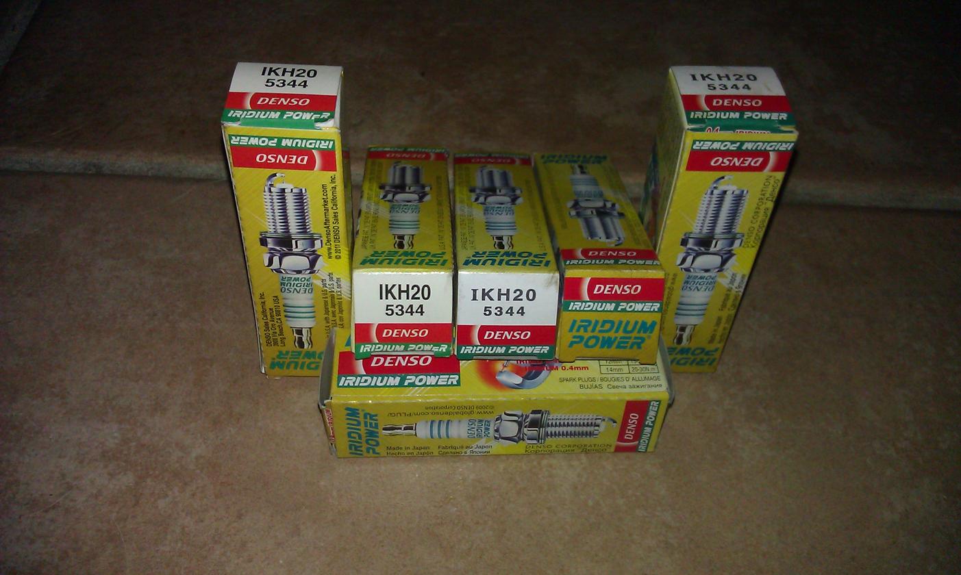

P.S. I just posted this and then saw Whitebeauty's post with photo above - these are the ones I have installed, they're great! Although, mine were pack in Toyota red boxes.

Its the Tower of Spark plugs!!!!! That will kick your Azz!!!!!!..lol..
My tower is bigger than yours.:jump:
