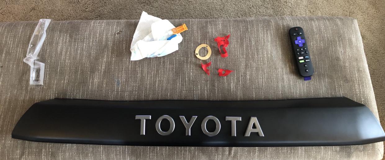

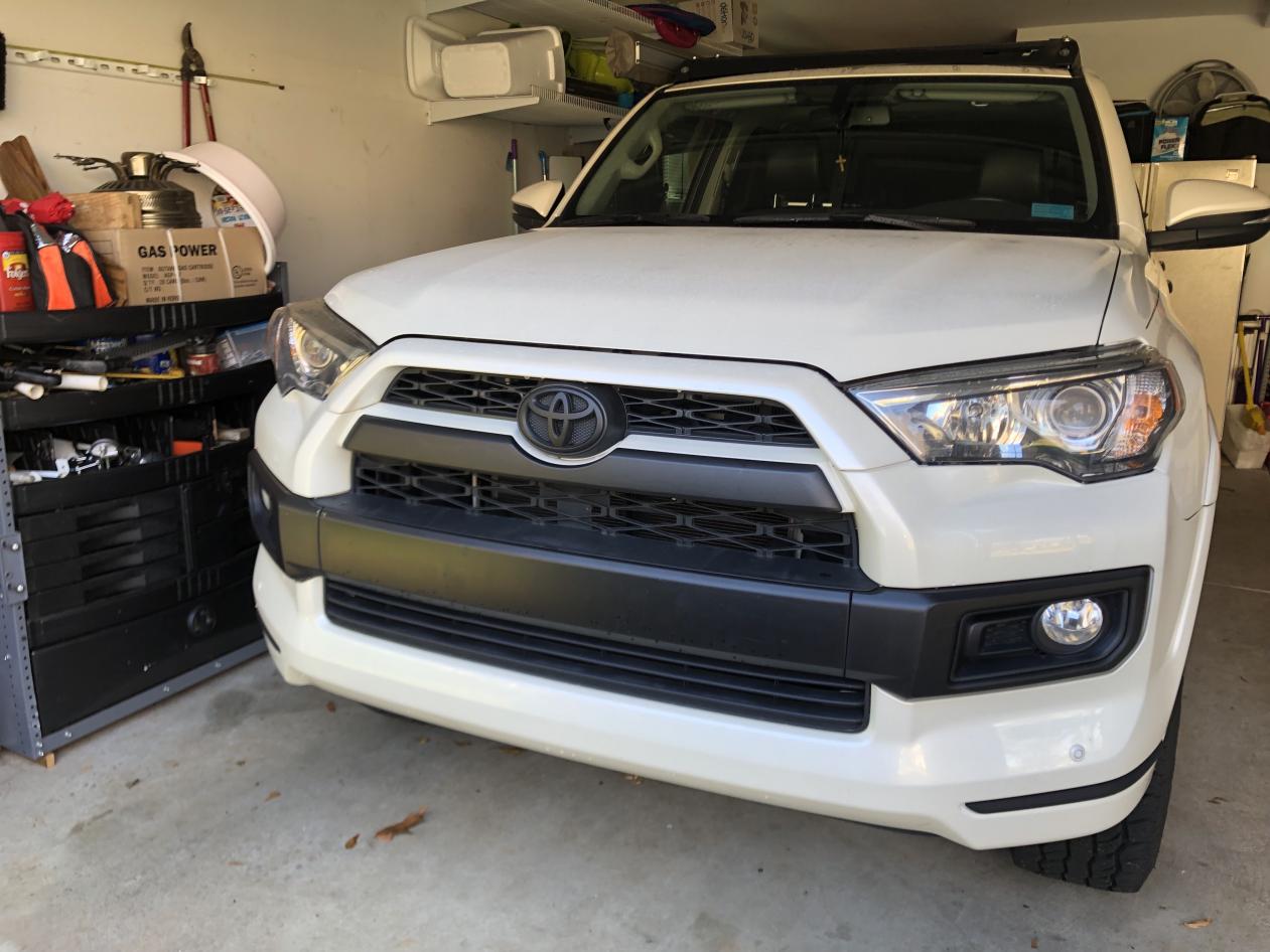

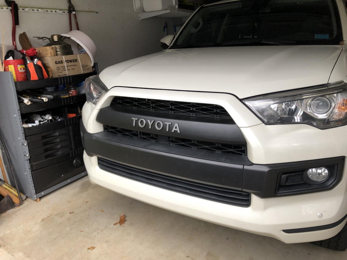

Here's my Limited to TRD Pro conversion buying from a Chinese eBayer during the 15% off so I paid ~$137ish. It came to my house in maybe 2 or 3 days.

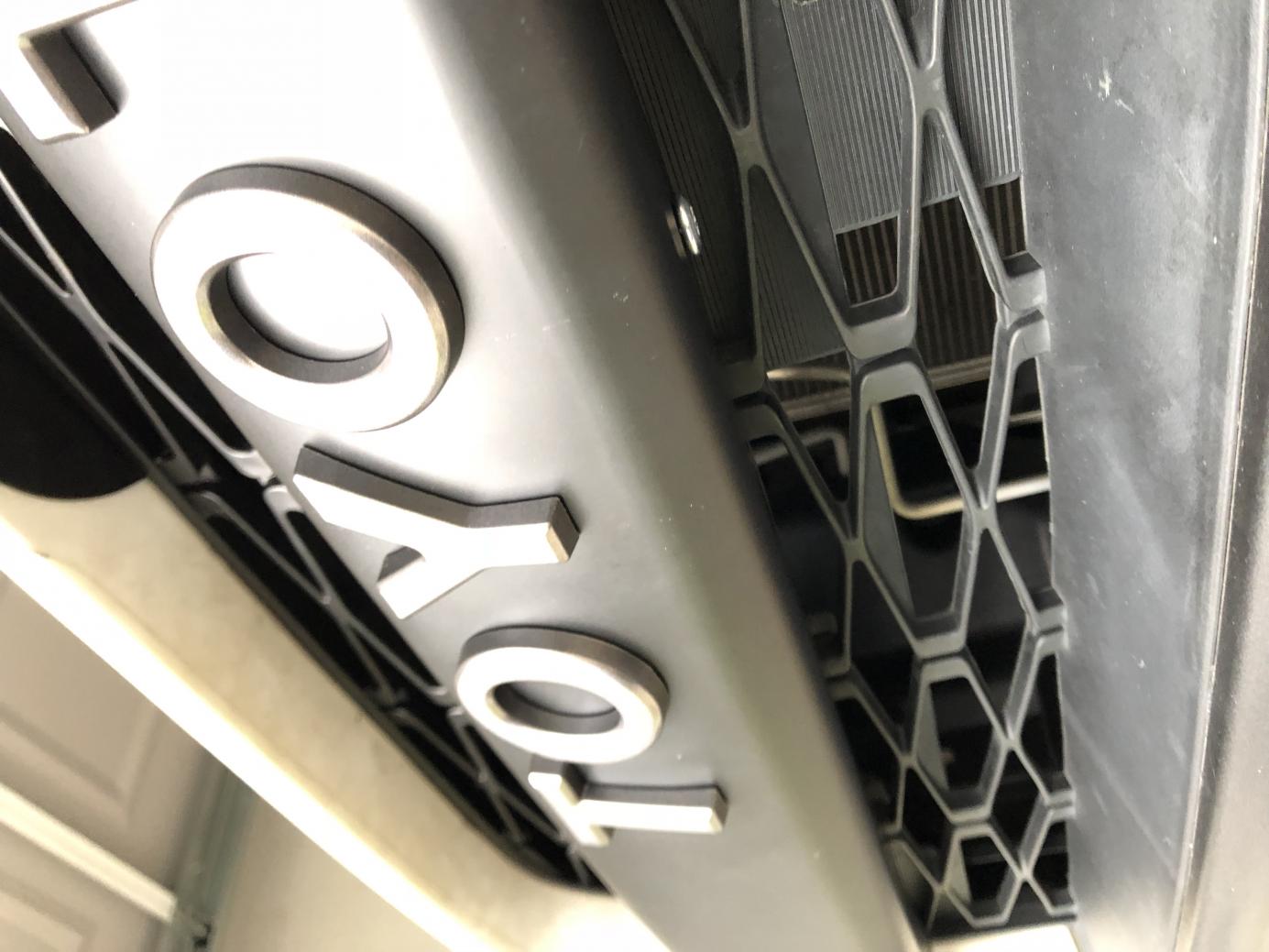

I ended up drilling a hole on the top and bottom of the center piece (zip tied the top and nut/bolt on the bottom side. The double sided tape it came with was trash and I wasn't even sure if it was touching the OEM parts underneath. I did the zip tie close to the edge on top so when the upper grill was on, you can't see any of it. The bottom I used a small nut/bolt and tried to center it so it looks clean to me. Gaps on both sides will definitely catch a lot of dirt so I'll have to see how it holds up over time. Overall I say 10/10.
I am installing on a Limited too. Does the TRD Pro black garnish piece go directly over the OEM piece with the raised chrome (your's blacked out) piece or does that chrome part need to come out first? Seems it would not sit flush otherwise?
