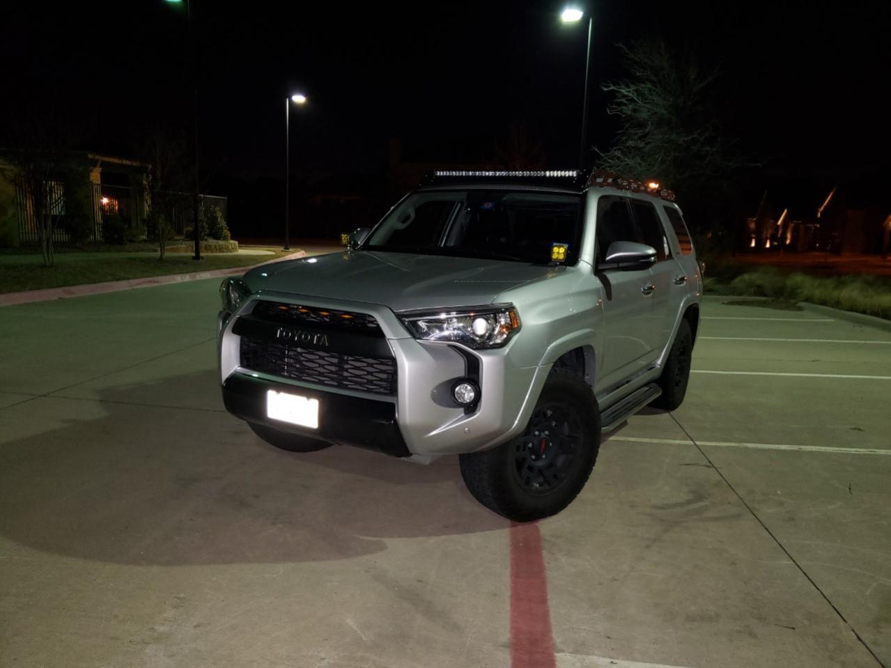

Installed tonight
Finished the install tonight with the raptor lights. Looks great. I ordered from the Cartrim website. Sorry for the poor lighting. Finished it late.

Looks sweet. How did you wire up the ambers in the front? Switched with your DRLs or headlights?
Neither, I followed the YOTALED install method they are tapped to the 10amp INJ circuit which is switched on when the key is on, in the under hood box which was much easier and faster than going through the firewall. You also can relatch the cover this way.

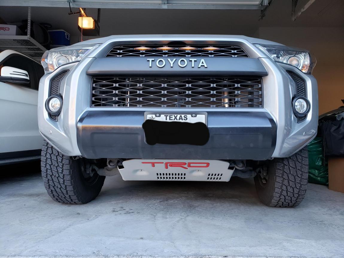

Full front
Here's a picture of the Cartrim front TRD Pro garnish and upper grill piece with their raptor lights up close. Included in the box were the garnish, "Toyota" lettering with adhesive, upper grill piece, adhesive promoter wipe x4, a roll of 3M like double sided tape, TRD PRO badge, Raptor lights x4, and wiring. I paid approximately 160 for everything.

Looks great. Since I negotiated lower prices, the LED version is now $150, for anyone else interested.
