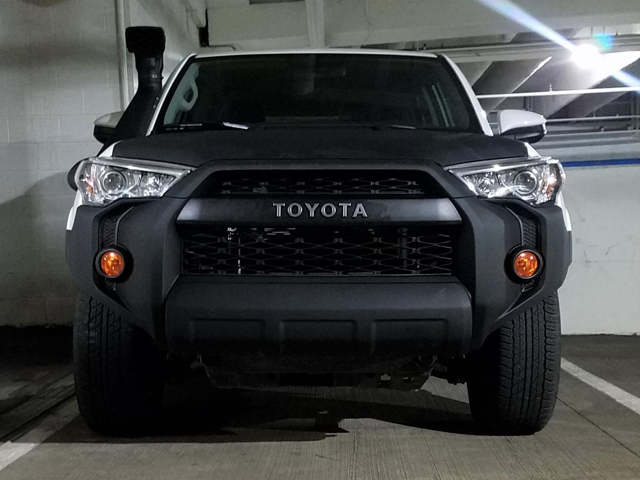

Are those the Cartrim grille lights or the Yota's? I want to do the 3 across the same way you did but not sure how with the Cartrim ones. See above post.
Neither, those are what I call the menards special. I have $28 into my setup.
They are these lights. A couple bucks in butt splices and the add A fuse which is also available at menards.

How do the letters attach? With 2 sided tape? I notice some depressions on the plastic, only for alignment?

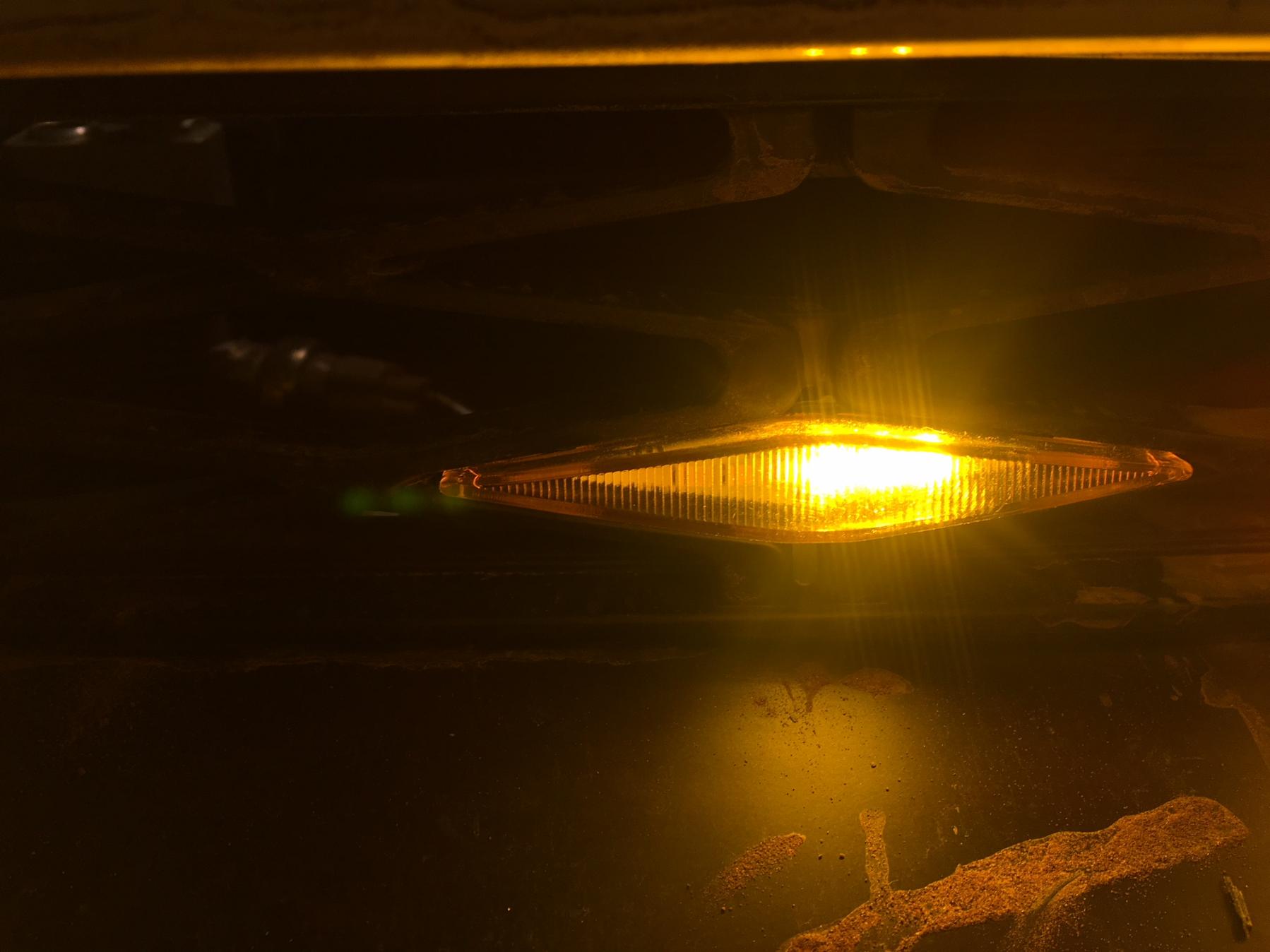

Here's a picture of the back of the light. You can see the clips
So two of the lights from Cartrimhome.com had only 3 of the 6 leds illuminating for some reason. I emailed them an image of the lights and they shipped me a complete lighting kit to replace them with, 4 lights and the wiring harness. Took a week from the time I notified them until the replacement arrived. Very pleased with the customer service from these guys and would recommend them to anyone else looking to change out their grill and add the marker light kit.

yup, tape is already applied. Mine hand a extra tape roll too. There's a small alignment bump on the back of them to help guide into the depressions. Best to apply the 1st and last letter, then run some tape across the bottom and top edge to use a gauge so you can line up the remaining letters a little easier. I had a little trouble with a cple, once these stick, they don't move or you rip off the tape and need to reapply.
Take your time! Do a dry run, choose the correct "O".

What’s the simplest way to test these lights for all the LEDS being lit before installing them in the grill?
Plug them all into their sockets on the harness then touch the red wire to your positive battery terminal and the black wire to the negative. They will light right up.
