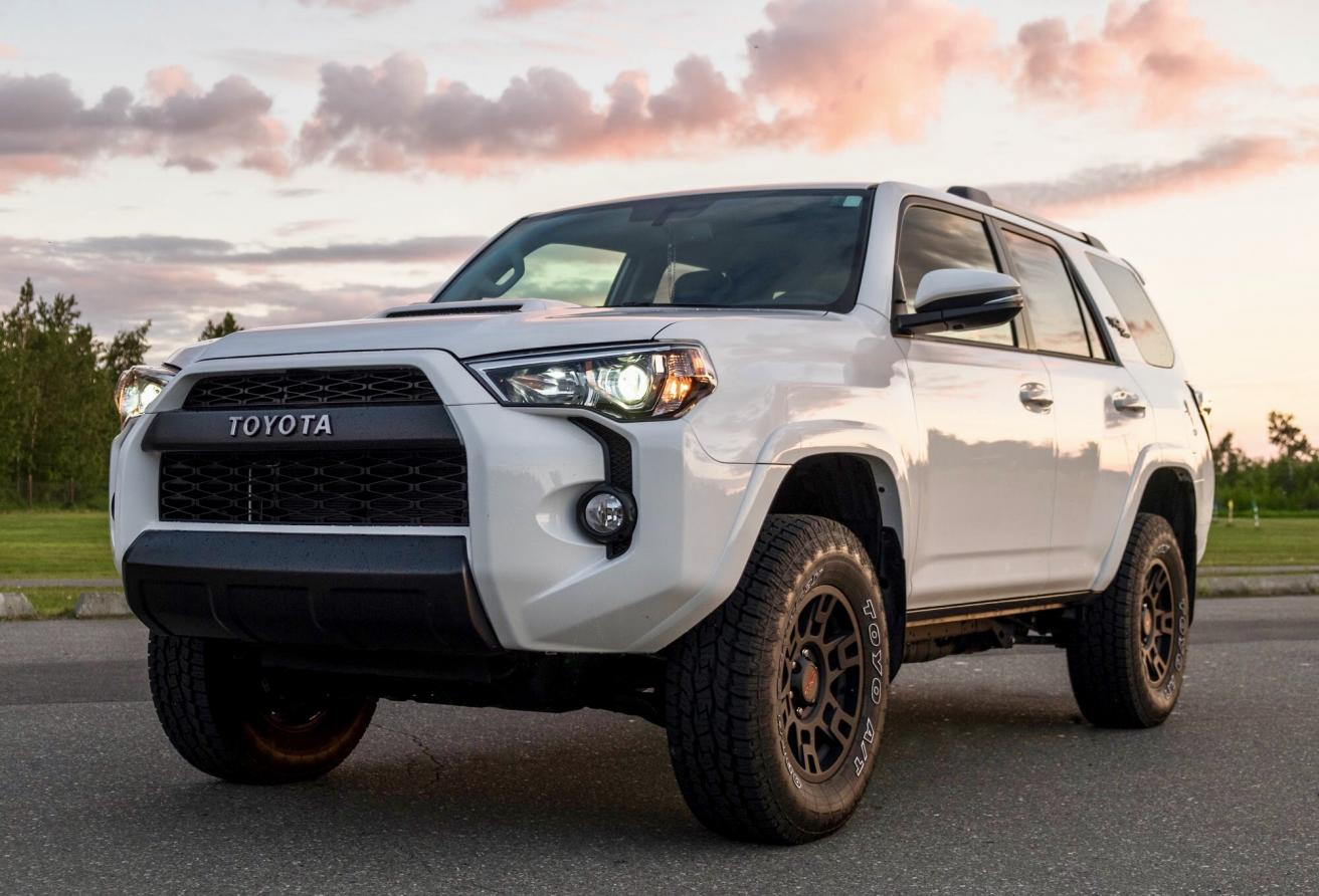

I really regret waiting so long to install this. I degreased it, hit it with a couple coats of adhesion promotor, then a couple coats of SEM Trim Black. Aligned the letters to the best of my ability, then stuck her on. The gaps aren't bothersome to me at all, especially when you realize that the Trail valences also have a bit of a gap on either said. Originally I was also going to hit the valances, hood scoop and fender flares with the Trim Black as well, but after doing my lift I'm a little modded-out so I'll probably knock that stuff out next month.

I prepped it by scuffing it with a gray scuff pad soaked in soapy water. Dried it off, hit it with a tac rag, then painted it with SEM plastic trim paint. It matches the color and texture of all the other black plastic on the truck.
The hardest part of the entire thing was aligning the two letter O's in the word TOYOTA. Both of the O's seem slightly taller than the rest of the letters, so using blue painters tape to keep everything level means the O's would be taller than the rest of the letter on the top, but flush across the bottom.
That is how that sat with the pegs aligned properly in the dents.
I ended up trimming off the pegs, and splitting the difference so they sit centered height wise compared to the rest of the letters.
Also, if you care...use the VHB tape on the back of the letters, not the cheap ass foam double sided sticky tape they supply on the letters.

Pic of the Amazon special front garnish. Fitment 8/10. Lower valance is plasti dipped. Wish I would have sprayed the garnish with some automotive paint but couldn’t wait to install it.
