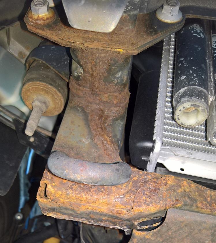

What did you do about the upper sides of the frame which are unreachable?
I have mostly typical surface rust which is not terrible but I want to stop it before it gets worse. Well actually there are a few outer places where things are starting to flake so it should really be addressed.
If I couldn't reach something by hand or tool, I didn't worry prepping it mechanically. In those cases the best it got was a spray of Prep & Etch (assuming the sprayer could get a stream in the unreachable spot), maybe some overspray from the primer and paint, but definitely a good coating of Fluid Film. Those ff sprayer hoses fit everywhere so I sprayed it every where I could or couldn't see.

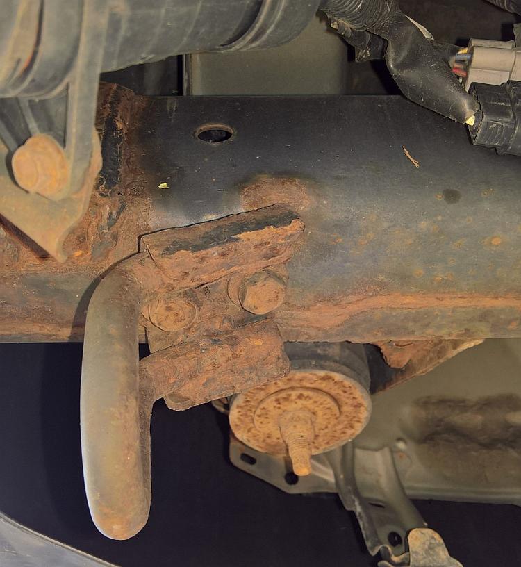

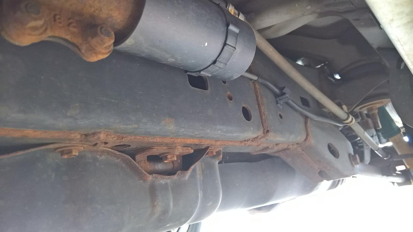

Here are some of my worst areas. Not terrible but getting there.
The problem is I can't have the vehicle down for days so I will have to do it a little at a time. I think I'll only wirewheel the worst spots and only fluid film the surface rust for now.
