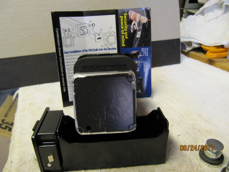

Just bought one of these (Amazon) and it didn't fit well on my 2011 4Runner. just used a file to file down the back edges of the box. Touched up with some black paint. It fits fine now and it easier to get in and out without a hammer or pry bar.

No, Everything in the package was all I needed to install on my 2011 4R. Just needed to file down the back edge of the insert, mostly on the corners. Use a very fine file and hit it lightly so you don't file a hole in the box. I touched it up with some black paint and it slides in and out very easily.
