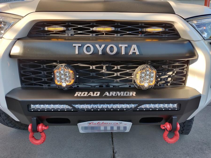

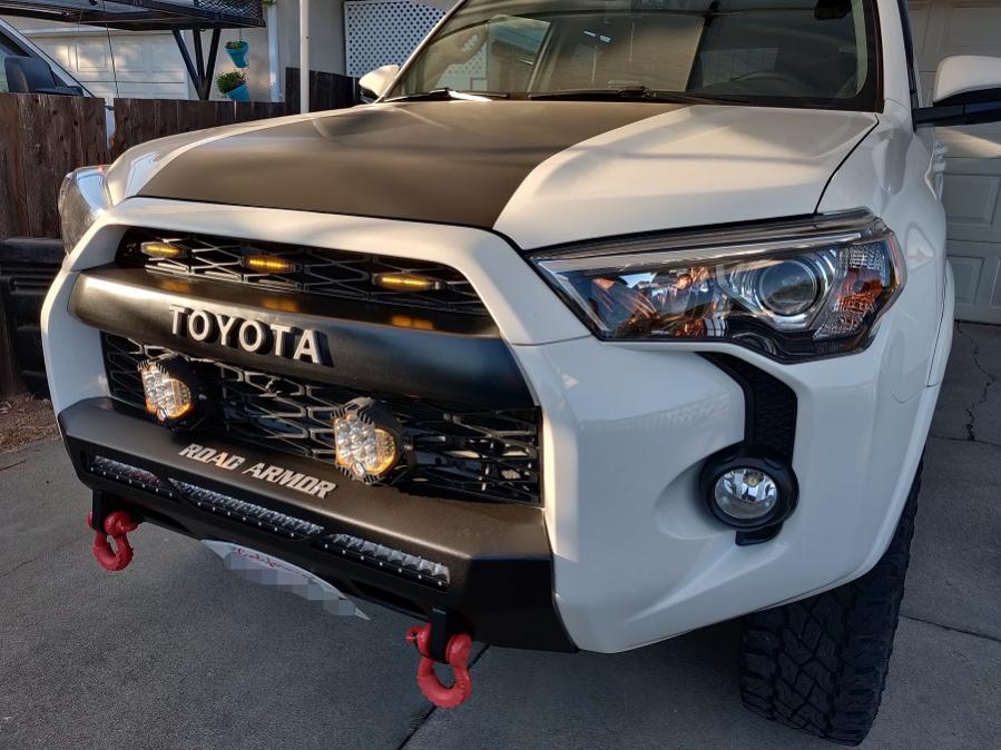

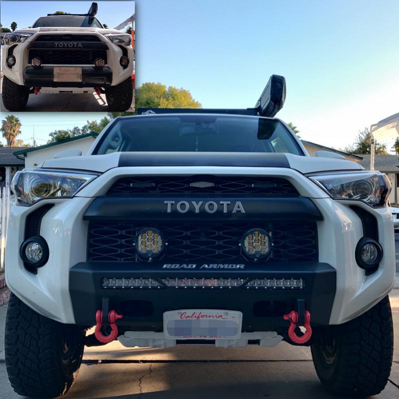

I installed mine over the weekend. I couldn't pass up on the deal. It looks awesome! Solid, heavy and well built. Everything was bolt on perfect fit for me. Except they provided me the wrong Allen wrench size to the button head bolts for the skid. I don't have any other bumpers to compare to like the C4, SSO, Victory, etc. Also, I don't have a winch. But the CaliRaisedLED 32" single row light bar fits perfectly. Here are some pics.

The mounts to the frame horn look scary thin. I wouldn't trust this thing with my bodyweight let alone a decent winch pull or recovery pull. I would file this under useless N-Fab running boards and raptor lights. All show and no go.
