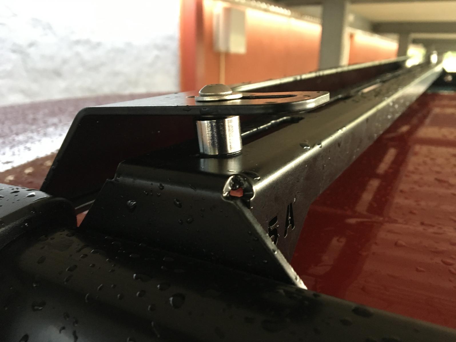

Does it change the general fitment at all? I have a fairing on the front of my stock rack with 4 LFD cross bars, and I couldn't even get it to tighten down without really pressing down on the roof. I ended up putting a couple 1/4" sleeves to raise it up a bit. Seems to work and no vibration, but it does block the front some if I need to have stuff hanging off the front end at all.
-Chris
No, we didn't change the length any, just added center supports. We do see some people need a few washers in the center as a spacer, but I've not seen anything that high. Not sure why you would have needed that much height. Something's weird there.
It is certainly a little higher than needed, but I also didn't want to reinstall 5 times to get it just right after doing this and having the wind noise mostly go away.

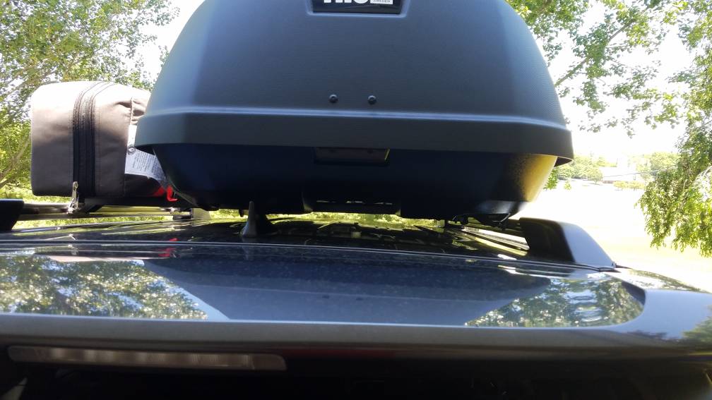

Got 2 crossbars and a wind fairing fpr a thule box. Sadly the thule mount was too wide to fit inbetween the fairing and the bar. So i just ordered a third (i was originally going to get 3 but figured id try to make 2 work and maybe save money) the mounts work perfect on the lfd bar
Need a way to mount maxtrax with the box and my tent so going to get a fab shop to make an angeled bracket. (dont own any tools for metal work)
