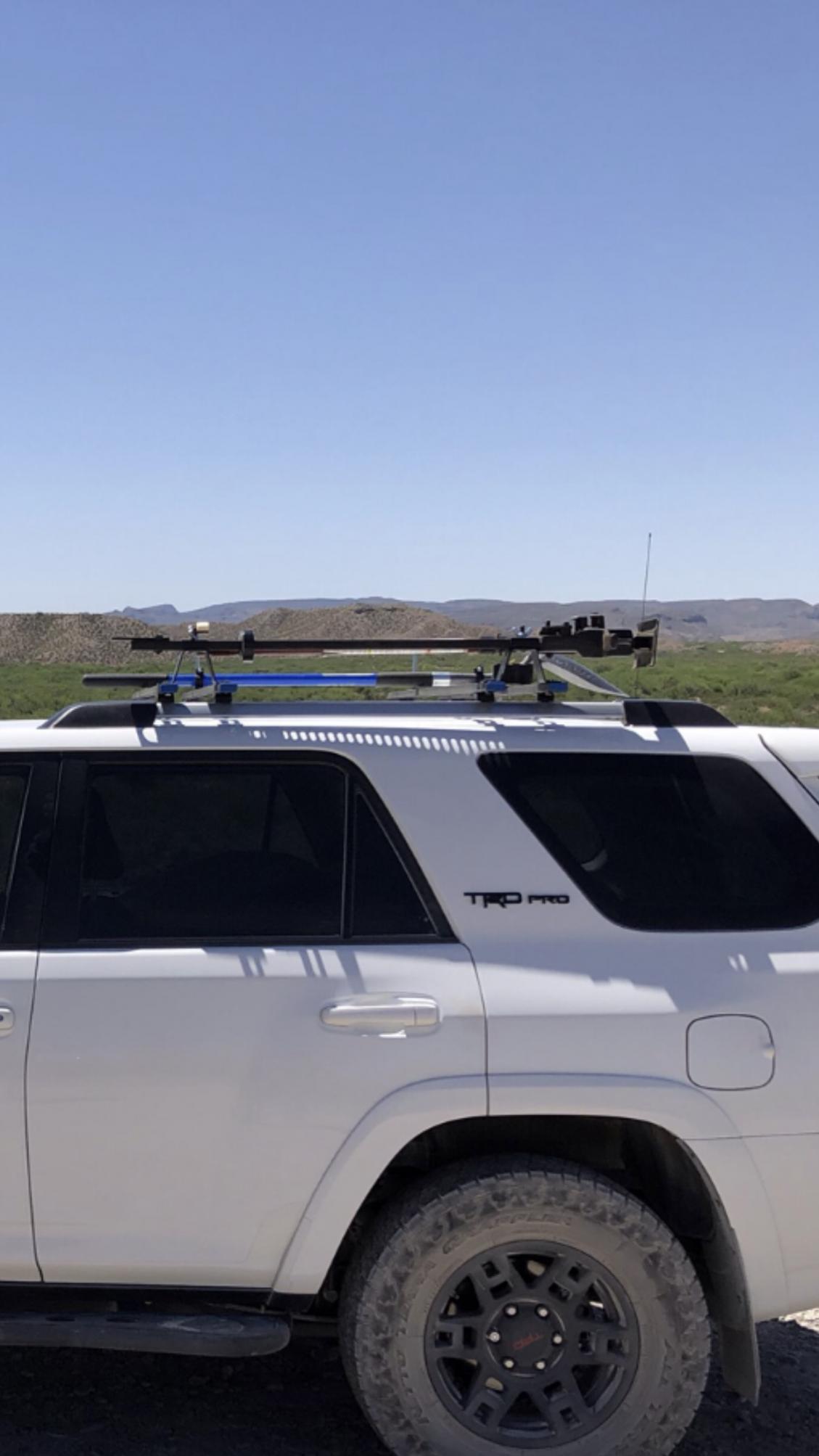

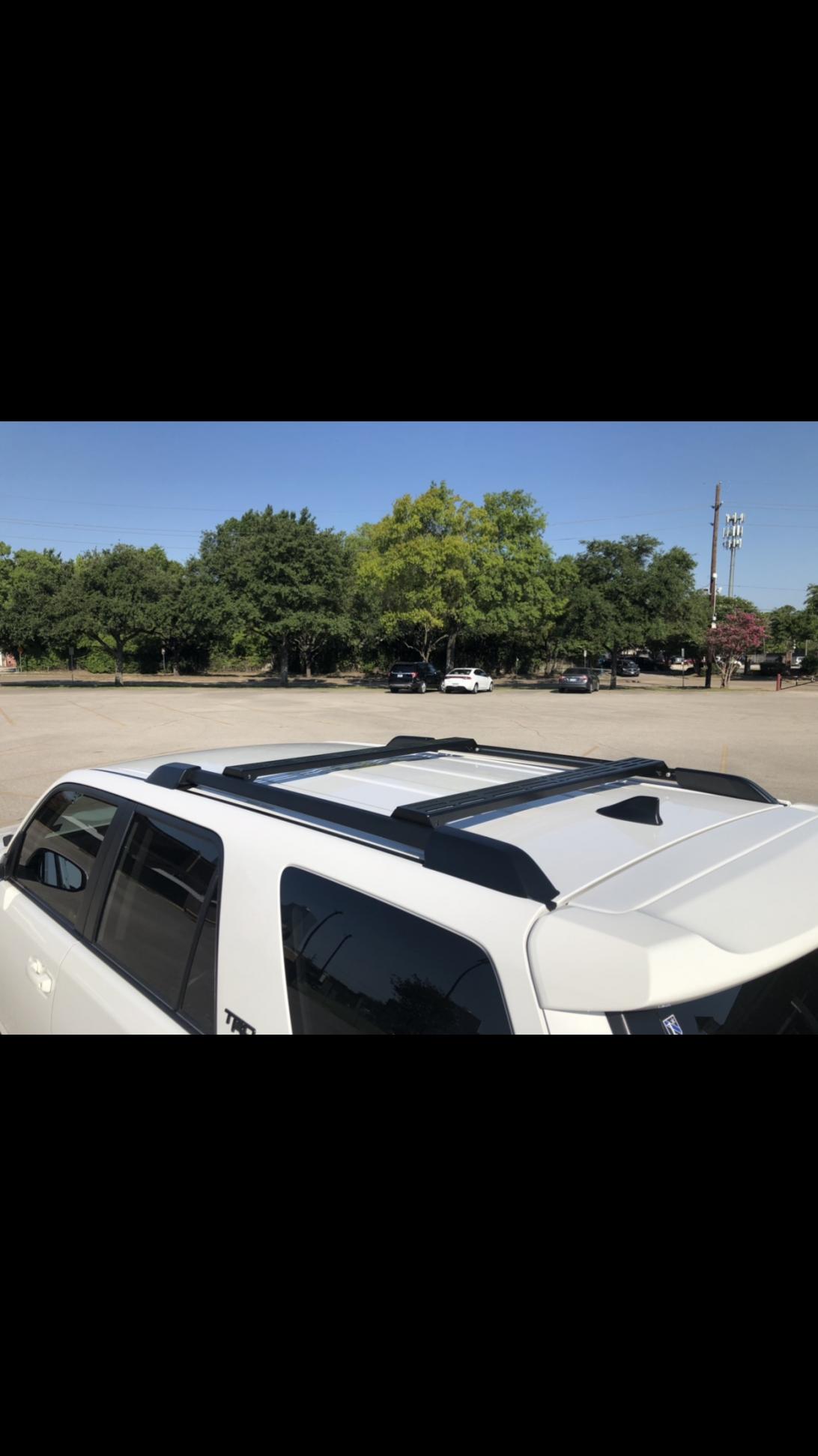

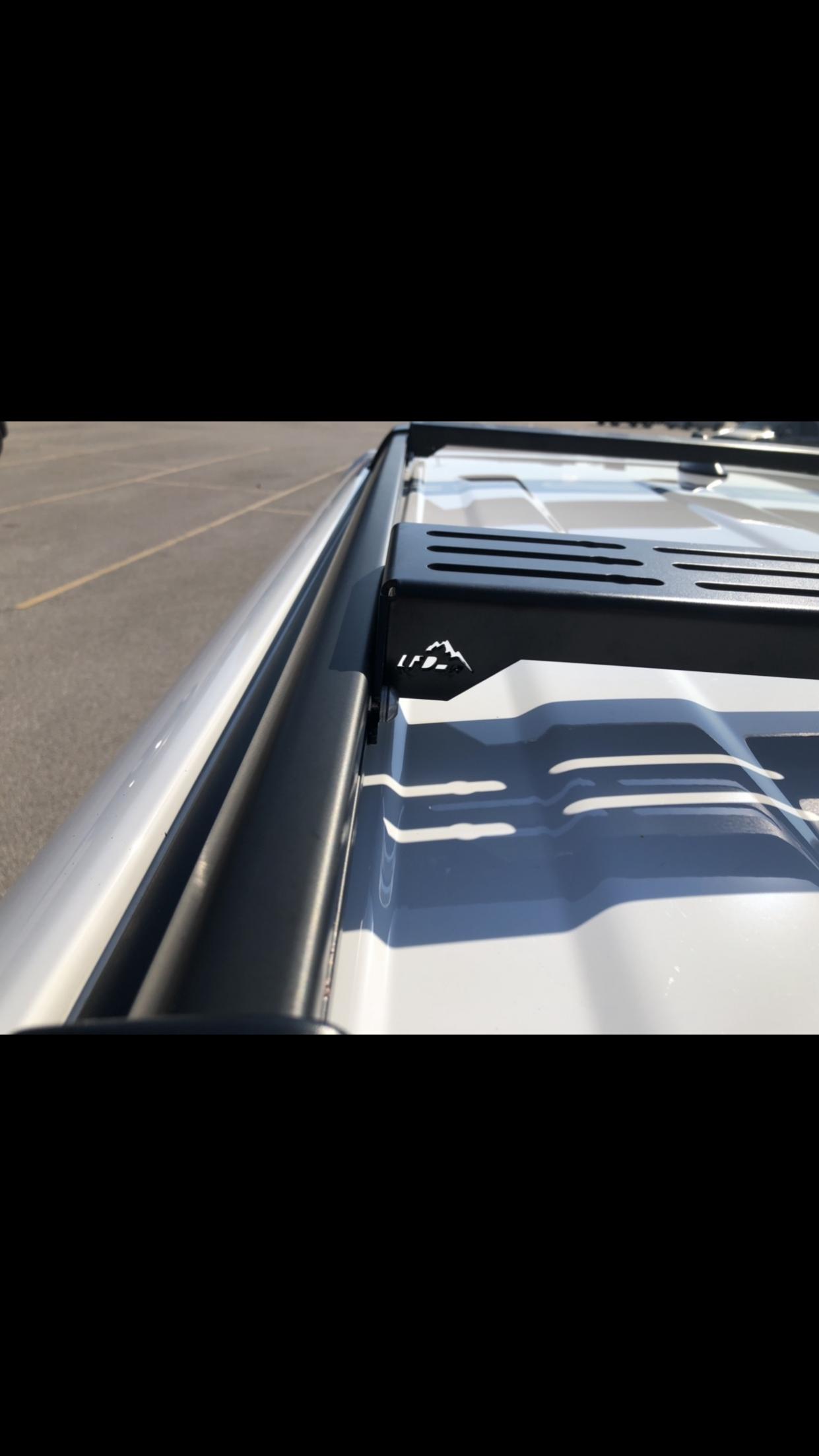

Here is stock vs LFD 3/4 rack. The plastic cap ends on the stock units where the bolts are located are not usable for rails (red marks). The LFD 3/4 rack makes that space usable and adds maybe an inch or so in front between where the bolts mount and the edge of the sunroof. I’ve also attached a picture of my 60” hi-lift jack mounted on the rack to show that the previous post was correct in regards to 60” of mounting space (and with rear hatch up).

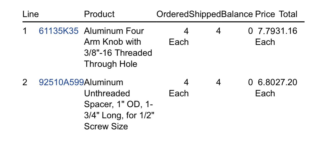

For the x-bull traction boards, I used a Stainless Steel 3/8' carriage bolts (5" long if you want to stack them on top of each other, 3" long if individual like I have them now) nuts, and washers from Home Depot. I also used rubber washers (off amazon) in between the bolt head/crossbar and between the SS washers/crossbars to prevent scratching/rust due to our strong winters here in Chicago. The aluminum bushings and knobs I got from McMaster.com at the recommendation from LFD (same knobs they supply with their hi lift mounts, see attached picture). DEFINITELY use anti-seize on the bolts to prevent galling and making them near impossible to remove if needed later.

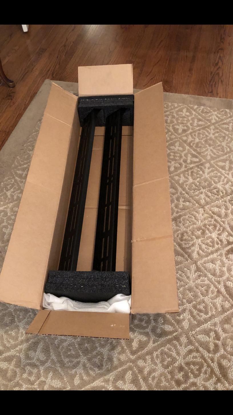

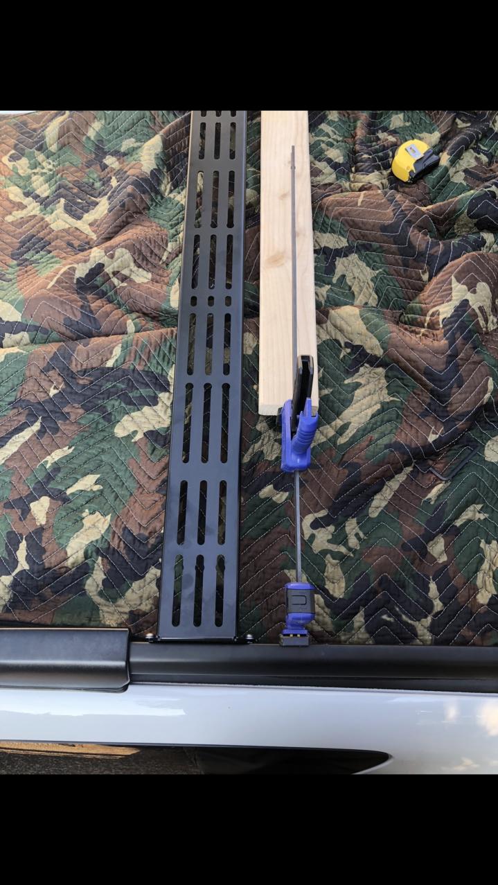

Install went easy. Not sure if the vinyl wrap caused issues or the 1st bar drew the rails together but I had to spread the the rails just a tad to fit the 2nd bar. Also instead of taking the mounts off and all that mess I just bumped the t-nuts ever so slightly on the grinder to flatten them just enough to fit though the slots.
I freakin love the bars! looking forward to next months purchase!
