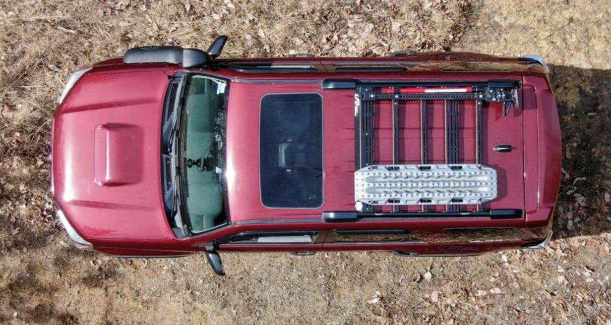

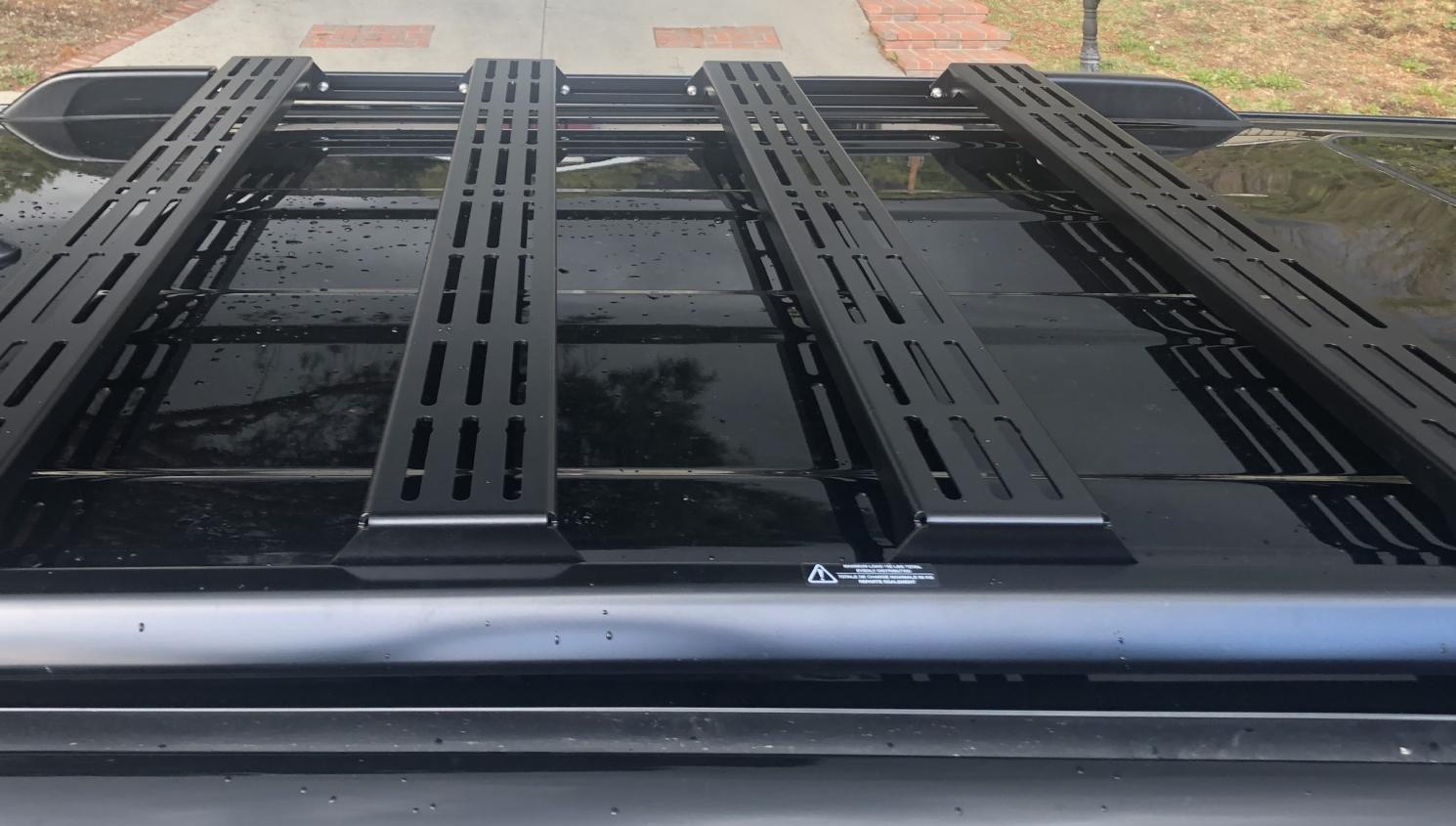

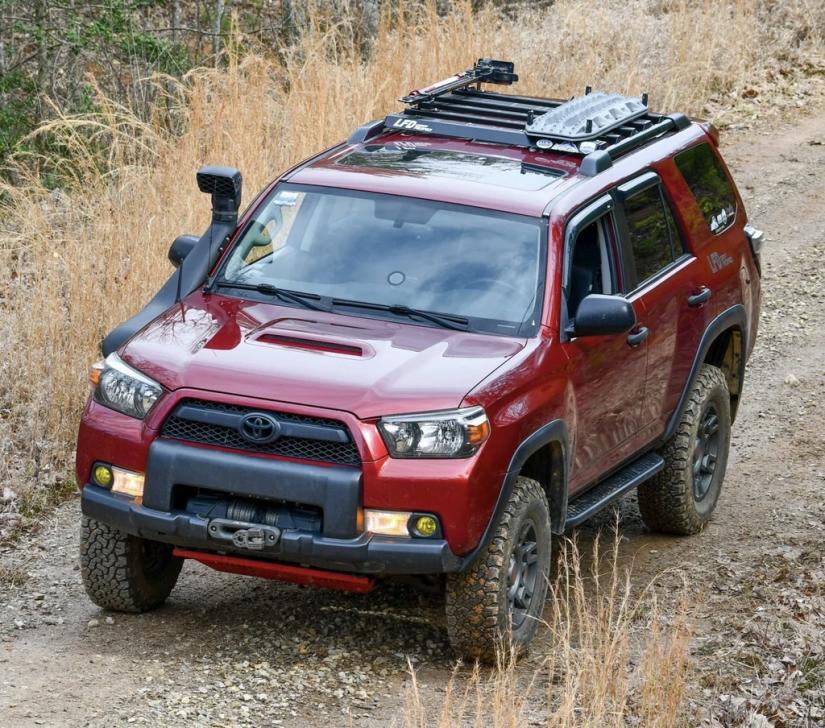

Pic Request... anyone with a combo of narrow and wide bars on stock rails, can you please post pics of your setup?
Here is a couple pics from LFD’s website. I just went with four wide bars on BF 2 years ago.

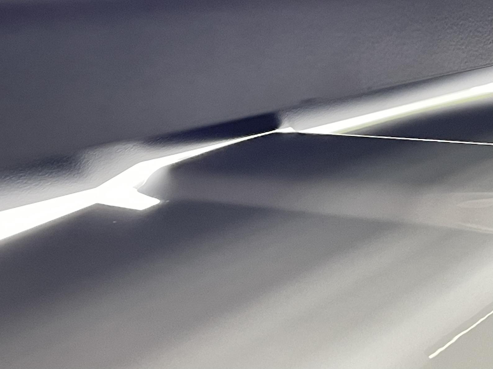

What type of film protection are you using? Does it come precut? I just installed my LFD bars and wind fairing 3 days ago, I left the rubber strip out as there was enough gap to prevent touch and debris accumulation but now the wind fairing makes a very slight contact with one side of the ridges of the roof causing to rub against the paint. I’m thinking about just using 3 bars for now as I’ll be mounting a couple of ROAM cases.

Can you try to loosen the bolts on that crossbar and move it higher a little? There should be enough play in the bolt slots to get a little more clearance.
3M protective film strips on amazon, just need to cut it to length.
