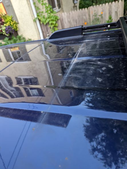

After a year of running the integrated fairing and a couple bars I went to mount my Skybox. Some trial and error later I realized the integrated fairing bar would have to come off for the box to clear the hatch on stock rails. Well, needless to say I'm pretty disappointed in what I found under the fairing strip. I should have checked that it was resting on the paint after reading this thread a while back but it slipped my mind. I guess use me as another data point, but do not install the weather stripping with the integrated fairing bar, it will destroy your clear coat.

damn that sucks. honestly LFD should stop including that weather stripping. I didn't install mine and I have about 1/4" clearance between the highest point of the roof and faring. that faring rubs on almost everyone's vehicle that installs it. you can try and install some clear bra or PPF if you really want to use the weather stripping but you're only buying time. vibration ruins everything especially when little bits of sand get stuck between the PPF and weather stripping, acts like sandpaper. I love my LFD rails and want to get a 3/4 rack. they make great products but this stripping needs to go

Best way to prevent rubbing (damage) is to skip the ironically named protective strip. There is only a small gap between the fairing and the roof without it. Myself and others have not noticed any wind noise without it.

let me save you some time - just remove it. you don't need it and you'll never have to worry

I initially installed the protective strip along the wind fairing but I also noticed what looked to be a bit of grit build up after the first couple of weeks. There was probably 1/16th to 1/8" of clearance between the stripping and the roof. I have since removed the stripping and there is a full 1/4" of clearance now and no signs of additional grit build up. It also seems as if removing the stripping seemed to reduce the wind noise even slightly more... (not that it was significant in the first place).
