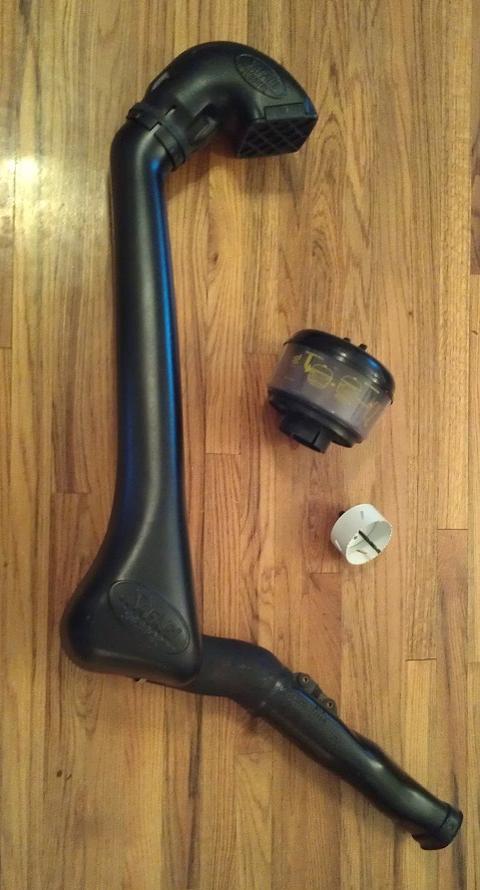

well i saw this thing about 3 weeks ago on craigslist and wanted it so bad but didnt have the cashs(the guy was asking $200), and anyhow the guy is selling his 4runner and bought a new fender cause his old one had a dent in it and didnt want to drill a hole in the new fender so put this up for sale separately. well when i saw the add posted a second time i responded and told him i wanted the snorkel, but had to wait for my tax return. he said he would hold it so i no issues giving him his full asking price. then i got a some extra money back from a loan to a friend almost a year ago(wasnt expecting to ever see it again) and so cost to me out of pocket was only $100, the prefilter is over $100 just by it self. anyhow its going on my rig tomorrow. the guy even threw in the hole saw bit he bought when he originally installed it.
his runner is a silver 2001 SR5 with 137k and ARBs F/R w/4.88 gears, TRD Tundra front coils with OME 890s and OME shocks. an ARB front bumper with a Warn M8000. just had the TB and WP done and put on brand new 285 dura tracs. he replaced the radiator recently and put in a external trans cooler as well. hes asking $11900. i have a friend whos been looking for one ever sense she totalled her defender 90 last year on mt hood, and so shes buying it from the guy. personally with as clean as his rig is, and what he has done to it, i dont think is is too far off with his asking price. to me it seams vary fair and reasonable. its a middle aged guy so i dont get the feeling that its been abused and hammered, there are really no dents on the truck that i could see either. if i had the money id of bought the truck too...
anyhow back to my build, im gonna try and install this thing tomorrow and get some pics of it for you guys, cause i know we all love pictures!

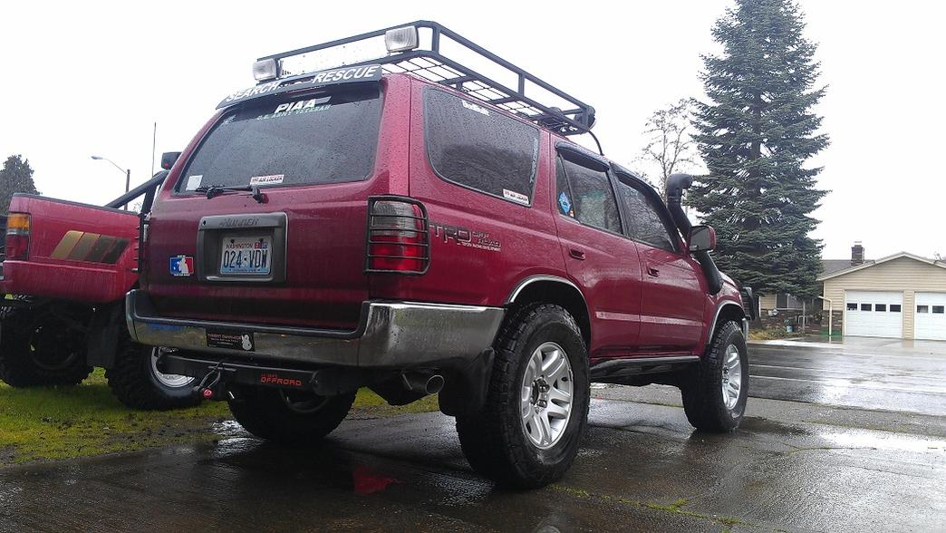

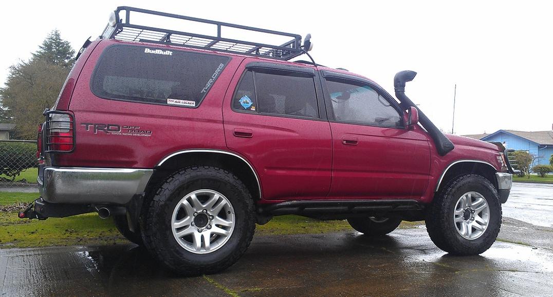

so i got my snorkel done today...

Looks good man! Have you thought about some LC 7 or 8 wraps?? I think that would really set you up for a kicka$$ stance...IMO.... BTW, I love the color of your rig.......oh...and those Tundra Wheels! :)
i have a set of LC 8wraps and 9wraps in my garage, im just waiting on the front 5100s and then ill have my lift. i know the 9 wraps will be way too tall, but when i do a rear bumper and rear winch setup, i think that will be enough weight to squat the 9wraps to a level stance. i think im gonna be runnig around with enough weight from my armor, tools and recovery gear that i carry daily to have the 8wraps sit level with the brand new trundra front coils. at least thats my hope.
That looks awesome buddy! I love the way it sounds too! Sounds mean! You got my favorite color too!

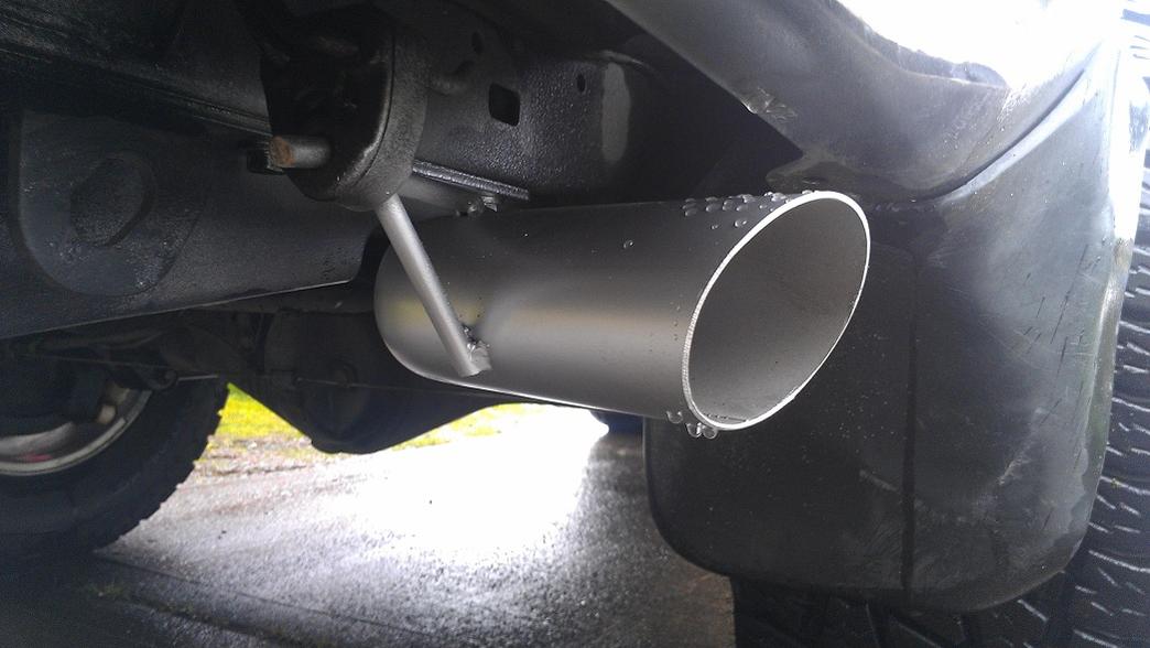

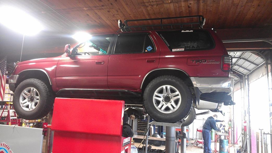

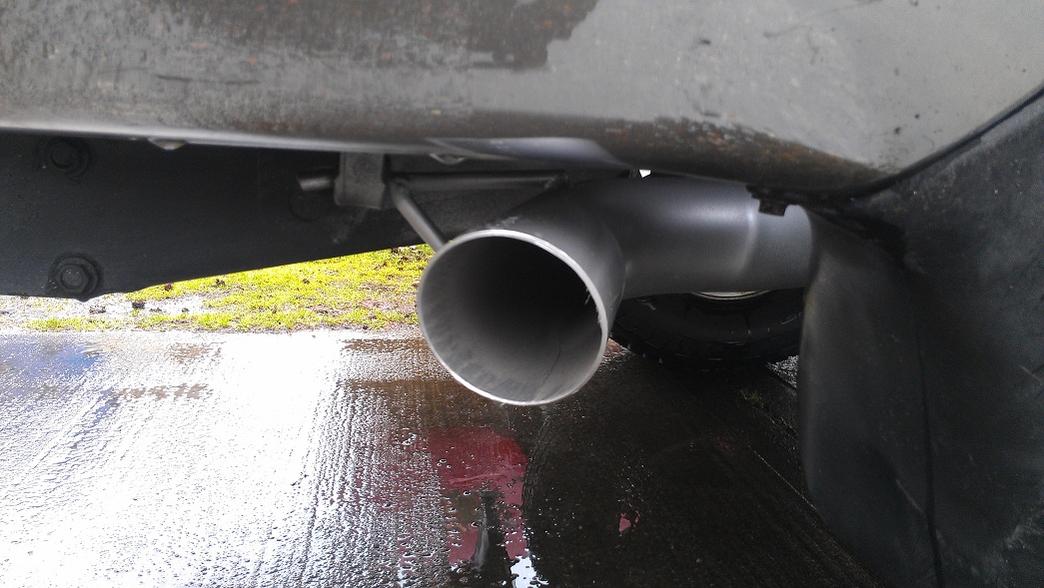

got rid of my dual exhaust hack job from the previous owner... flipped the muffler around and built a Y pipe and then went with 2.5" all the way to just past the rear axle, then went to 3" for the outlet/dump. i like the way it turned out, its all nice and tucked up tight to the bumper so when i put on a replacement bumper i dont think my exhaust will hang down too low. its a little louder now, not sure if thats from flipping the muffler(not sure if your supposed to do that or not -i called a few exhaust shops and they said it souldnt matter as long as their is no flow indication arrow on the muffler itself). anyhow the sound is nice, a little more sound inside, but i liked the quieter sound before, but i can already feel an increase in freeway pickup/acceleration... also my mileage really picked up too. i am now at just past 1/4 tank used, not quite to 1/3, and ive gone over 107 miles... usually i will see about 120-130 at half a tank, so im hoping ill be getting right around 300 to a tank now(finger crossed). like i said its a little louder than it was before and a little louder than i would like(i really liked the sound before) but i will gladly take the louder sound for the increased performance in both power and mileage.
i didnt snap a pic of the Y pipe(should have i know...) anyhow i will take one later once it stops raining...
