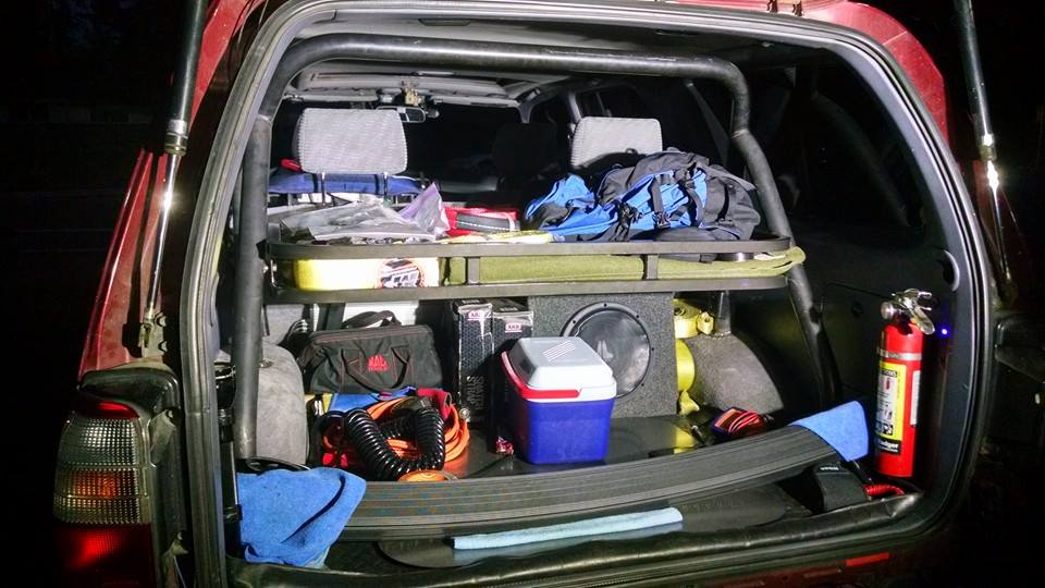

got my first gen roll bar mod project almost complete...
Bunk Beds?
SWEEEEEETTT!!
I have to admit that's the first thing I thought I saw. It's been a long day.
Looking sweeet man! Like the 2 levels for storage built in.
