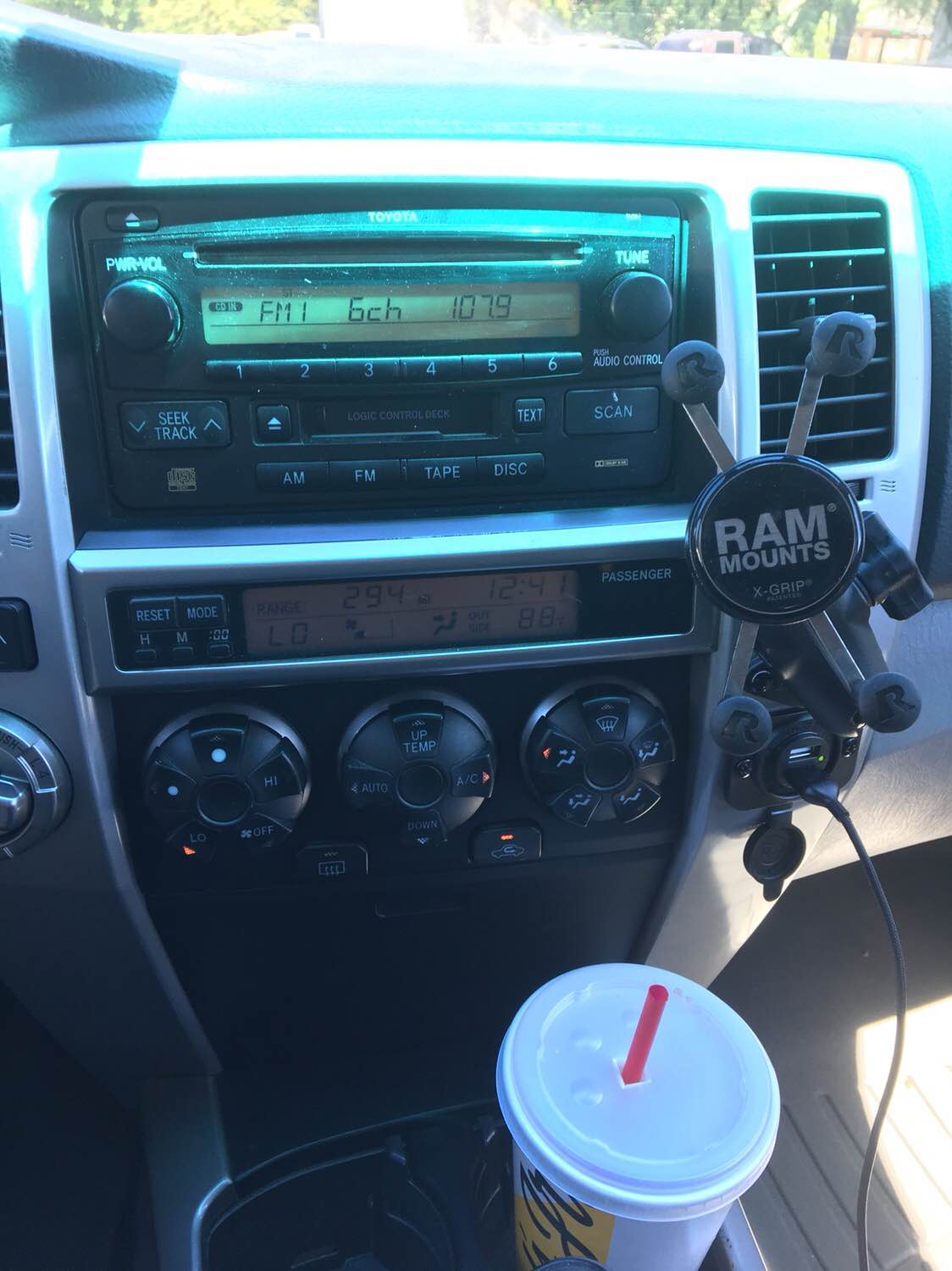

What did you wire the blue sea usb port to? I am looking to do something similar with this and the ram mount, but wiring is definitely not my strong suit. I do see you mentioned the firewall and going to your blue sea setup, but what wiring size, etc did you use?
Id be curious to see your electrical setup as a whole.
That's so funny that you asked this....I literally just went to ask the same question.......what did you wire the blue sea usb port to? I don't want to wire it directly to the battery because then there would be constant drain on the battery if something is plugged in.....Is it safe to tap into the 12v charger port in the center console?
TIA.
I just grabbed a ground behind the dash as there is a lot of bare metal there that braces the dash and center column area. For the positive wire I used some thicker guage (top of my head 12ga or 14ga...) and wired it direct to my Bussman Relay/Fuseblock which is on a stand-alone breaker. It is wired constant ON but I wanted it this way so I could charge things with the vehicle off from that specific port.

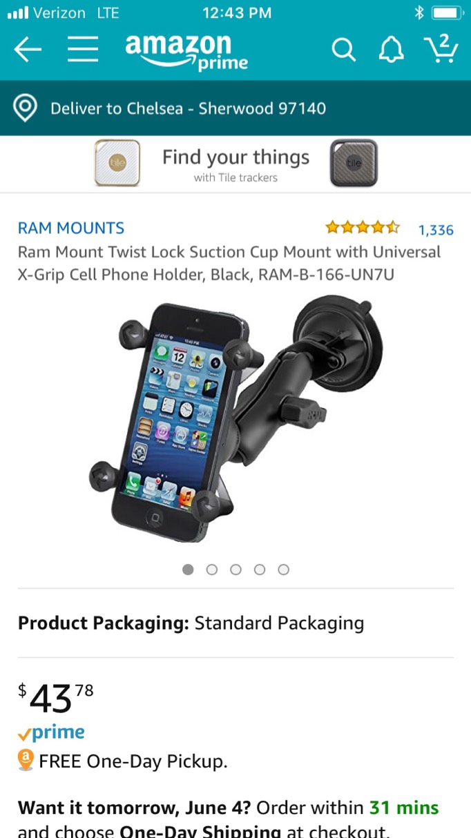

Rickashay- I love this set up and want to copy it [emoji51] wondering if this is the ram mount you bought to do this ?

Yah thats the one. I still have the suction mount too which I use in my other vehicle on another RAM mount (it works excellent too) but I like having the hard-mount with charging in the 4Runner.

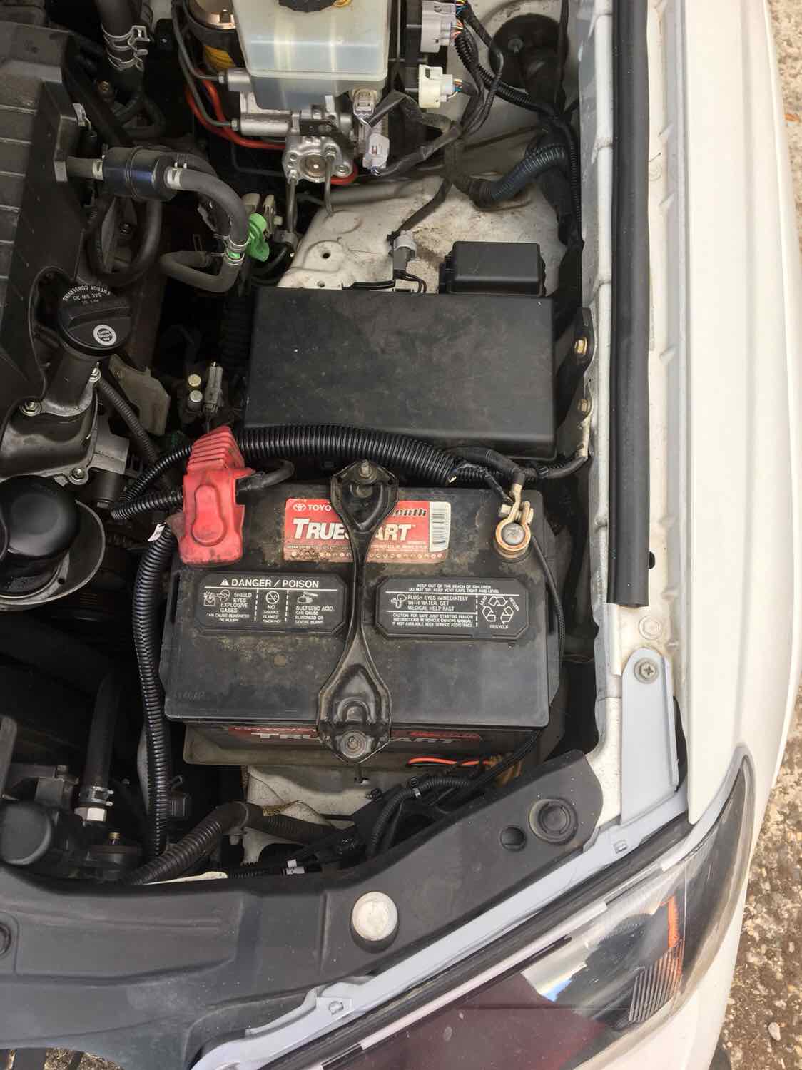

Over the years I've always had too many items/mods to get power to, and therefore one of the first things I always do is ad some kind of auxiliary fuse block or panel at the start of all my builds. It just pays dividends later to have clean wiring and a place ready to accept incoming wiring modifications.
This is just a prime example, I ran straight to the battery to have constant 12V and not have to worry about a splice-job being insufficient. That's my vote ;)
Great minds think alike [emoji16] I did exactly that and could not be happier with how it turned out ! I completely copied your set up but tell people I got the idea from t4r ! I ran the wires through a plug in the firewall just above where the main harness goes through the firewall! I wrapped everything in convoluted tubing and now you would be hard pressed to know the difference between factory and aftermarket
