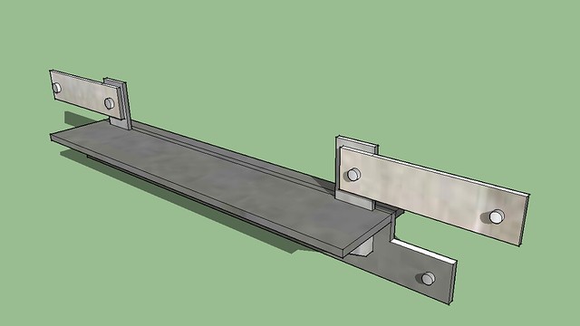

Goal:
To make a winch mount that discretely fits inside the OEM Bumper behind the license plate.
Background/history:
I bought a Badlands Recover Winch in October, and it sat on my shelf for a month doing nothing. I was still offroading, but I wanted my winch. I was in a market for an armor bumper, but I still wanted to use my recovery tool in the mean time. During a weekend in November, a buddy of mine and I made and mounted a sneaky winch mount in about 15 hours. Even though I have a completely functional winch setup hidden in the OEM bumper and brush guard, I am still planning to replace the bumper with armor later in 2014. This mod is good in the mean time, and I bet it could work for long term as well.
Methodology
The winch mount mod has to meet these constraints:
-Fit inside OEM Bumper
-Still allow for brush guard mounting
-Be solid
-House a 6K winch (light, but adequate with a block n tackle)
-Still allow mounting for frame bumper (correct me if that's not the right name for it)
-Be sneaky, like OEM sneaky. :P
I lost all of my original progress pictures since I stick welded with my iphone in my pocket (scrambled the data on my phone. That was a hardcore derp right there). All I've got left are the afters from the dry fitting.

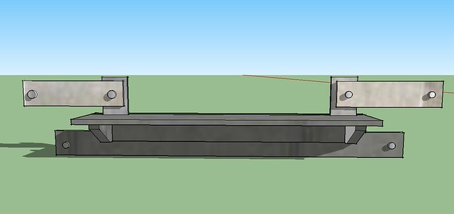

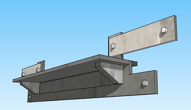

Not-to-scale model of the winch mount (notes on dimensions also lost from the welding/iphone mishap). The example is close dimensionally, I'll measure it again if needed, but these give the gist of it. This model does not show the fairlead mount.
Offset topside view
Front view
Offset underside view

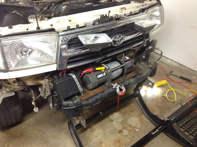

Next up was the dry/fitting installation of it and remounting of the bumper.

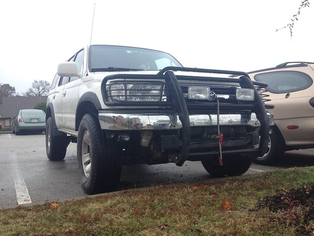

This was an image of the 4Runnner parked without the fairlead mount finished. Folks looked at it and said it looked a jerry-rigged border crosser. I guess one could take that as an insult and a compliment at the same time...

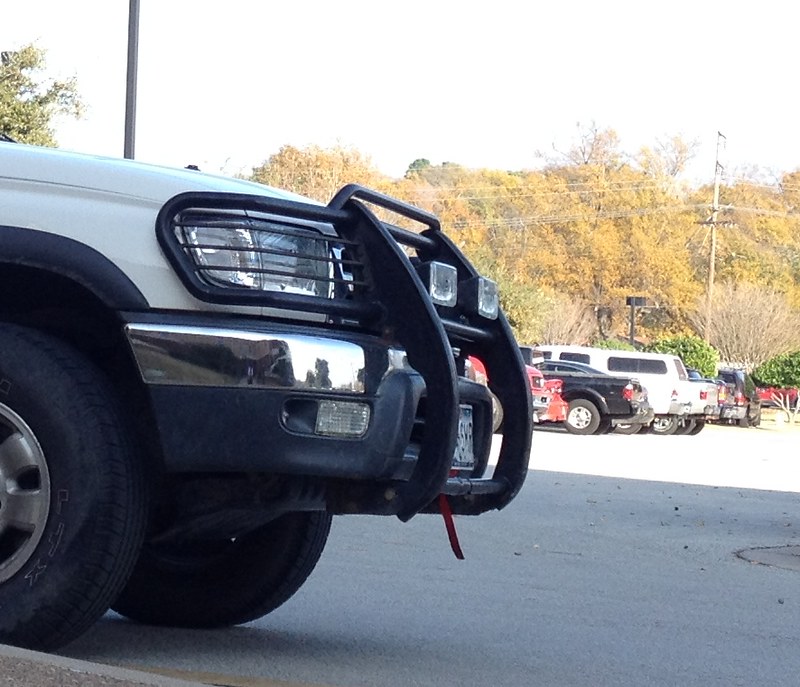

Now it looks back to normal! Winch, lead and hook all are hidden behind the license plate. The only thing out of the ordinary is a red, lizard tongue flag that dangles from under the plate.

Excellent job. I like mods like this. They're unnecessary for my truck as I strayed from sneaky a while ago but they're still awesome. Reminds me of sleepers in the racing world, and I love sleepers.
Let's see those welds mr. engineer
Sweet mount! I am on the fence about getting one like that, or saying screw it and having the welding shop near by fab me a tube bumper with a winch mount... This mod looks a bit cheaper than an entire bumper though!

Singtoe, the fairlead is already mounted. I didn't take photos at the time--I was scared of wiping my phone again, so I left it in the next building. I'll get a picture for you in a little after a week. The only real after photo I have is the first one with the flag sticking out (fairlead is again behind the license plate). I'm about 1K miles from home (and sadly, my 4Runner) for the next seven days. I'll get the fairlead pic for you. By the way, I just ran through your V8 mod today. THAT IS EPIC! Great job!
TCMach, thanks! I am hoping to go loud as well and move away from sneaky as well. I've been PM'ing some folks on potential used SW front. I'd mod and reweld the crap out of the bars though, lol. Not sure what bumper I want to use on the back yet, maybe a 4x4innovations. Oh, and for the weld shots, it'll be over a week to get the photos taken and uploaded--same reason as above. I hadn't stick welded in three years, so there will be plenty there for you to, uh, make fun of!
vtferret, yep! It's a super affordable mod. It was all scrap plate, so that made for an excellent mod project. I cut out the plates and the bolt holes with an oxy fuel torch and stick welded the parts together. I did some grinding and painting afterwards. It was a fun project overall. I don't know how much it would cost a welding shop to make it for you, but jump to the bottom of this comment for my thoughts.

Oh, and thank you, good sir! It is a blast to make and bolt on. Do you need dimensions or a sketch of how to do it?
Did you have to modify the bottom bar on the brush guard because I to have a brush guard and am planing on doing this mod
This is a sweet mod. If you've got those dimensions and sketches handy, I would sure appreciate it. I've gone back and forth on getting a new front bumper and doing this, and it would be nice to be able to just pull it out if I decide I wanted the after market bumper down the road.
Cheers :beer:
You could also upload the Sketchup design to the Sketchup database and then post the link here! That would be the easiest way to share the dimensions.
Neat mod! I think your pm box is going to fill up with requests as I don't think anyone offers a hidden mount for a winch commercially.
