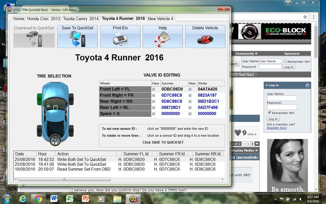

Your previous post sounded more definitive and infallible about the 5th TPMS sensor. My 5th gen 4Runner ECU only shows four (4) active TPMS sensors and nothing for the spare wheel. I know this because I just programmed the winter wheel TPMS IDs onto ATQuickset.
The 2016 and I think 2015 Limited have 5 sensors. Not sure how much hardware is shared with SR5 and Trail.
I believe you. How did you confirm this? Do you have a TPMS tool?

On my 2016 Limited I got a flat on day 3. It has 5 matching wheels, tires and TPMS so I had the flat fixed and left it as the spare. On the newer Limited Toyota recommends a 5 tire rotation, you can't do that without 5 sensors.
From page 418 of the owners 2016 manual
When a tire is replaced with a spare tire
Vehicles without P245/60R20 tires
The spare tire is not equipped with a tire pressure warning valve and
transmitter. If a tire goes flat, the tire pressure warning light will not turn off
even though the flat tire has been replaced with the spare tire. Replace
the spare tire with the repaired tire and adjust the tire inflation pressure.
The tire pressure warning light will go off after a few minutes.
Vehicles with P245/60R20 tires
The spare tire is also equipped with a tire pressure warning valve and
transmitter. The tire pressure warning light will turn on if the tire inflation
pressure of the spare tire is low. If a tire goes flat, the tire pressure warning
light will not turn off even though the flat tire has been replaced with
the spare tire. Replace the spare tire with the repaired tire and adjust the
tire inflation pressure. The tire pressure warning light will go off after a few
minutes.

It is close enough on the bumper. Before I damaged one and got the light in all the time, I only had 4 installed and I do a 5 tire rotation and it read just fine on the bumper.
I'm 99.99% sure 5 can be registered but only 4 are monitored at any point in time (which means that if one of those 4 failed, it would register but the 5th wouldn't pick up the spot and if the 5th, unmonitored tpms, were to fail while being used, no light would come on). I believe there was a post at one point a few years ago that showed this using techstream.
