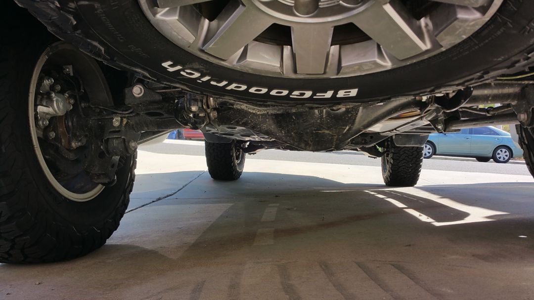

A little known story as to why I always put the spare underneath the truck with the "nice" side facing the bottom of the truck rather than facing the road...With the nice side facing the road it creates a nice little nest area for animals.
Years ago in my Chevy Blazer the spare was held in the same place and it had the nice side facing down. One night out on the 30 minute drive home my friend and I kept hearing the sound of a kitten, we dismissed it thinking it was in the music we were listening to at the time. Sure-enough the next morning in the garage I hear the same kitten meow. Turns out in the cold, snowy night the kitten found refuge in the nice, warm and protected pocket the upside down spare created.
Also, when off-roading that nice side is going to get scraped up pretty good when sliding off the rocks.
Just my $.02 and yes, I occasionally drop the spare to check the tire pressure. I like doing that to make sure the spare-tire release crank works too in addition to checking the tire pressure.
Good discussion. Since the spare does seem to fit fine with the stem facing down, I'm curious why Toyota (and the owner's manual) seem to think it needs to face up.

If anyone cares, my spare is mounted with the TPMS sensor pointed directly towards the back bumper. Stem looks accessible with a flexible air chuck.
