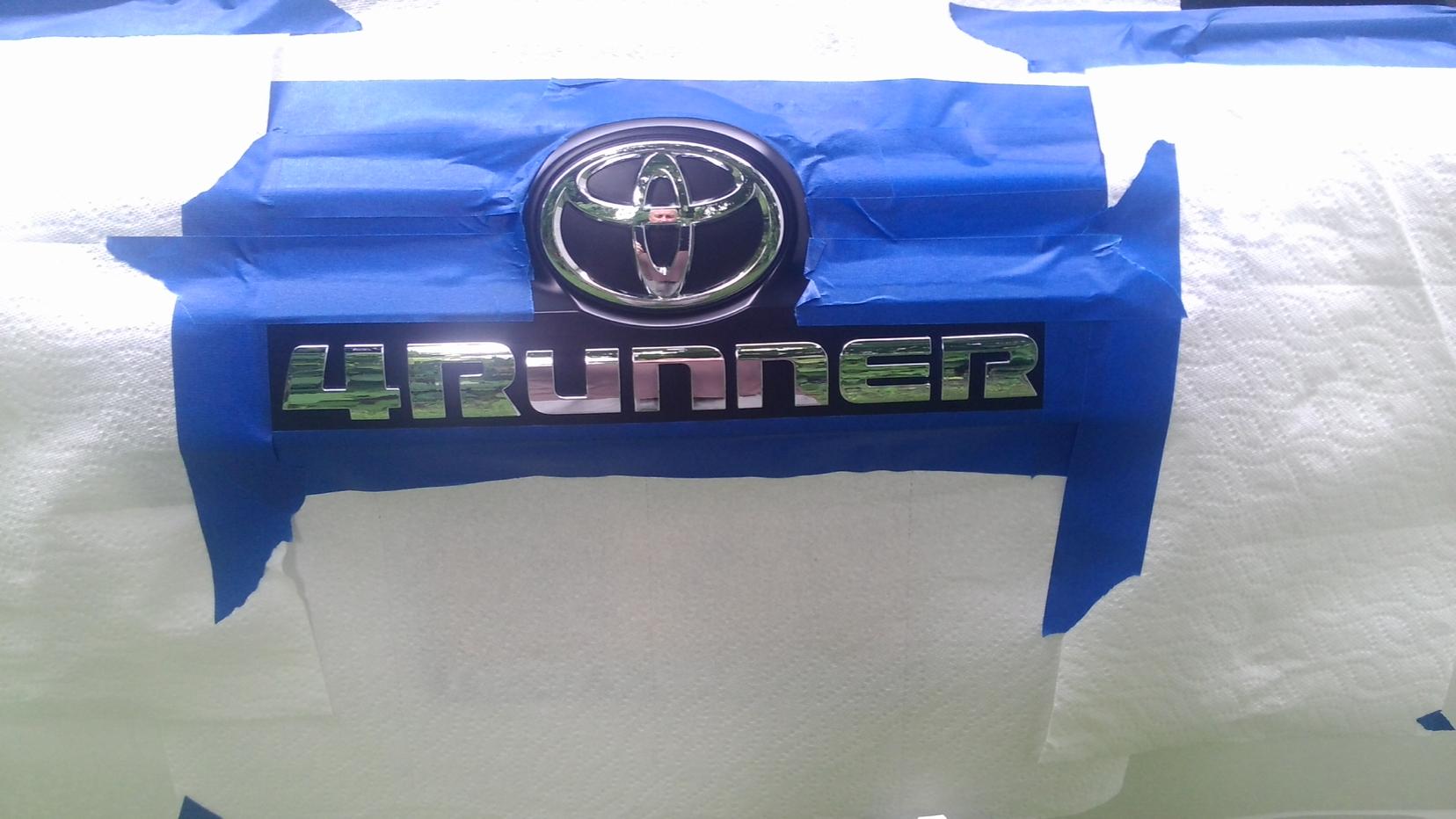

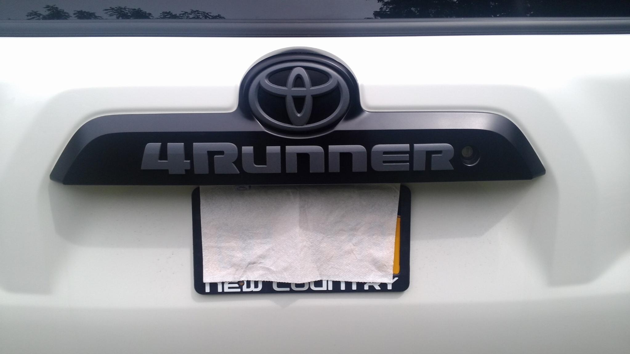

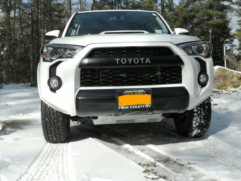

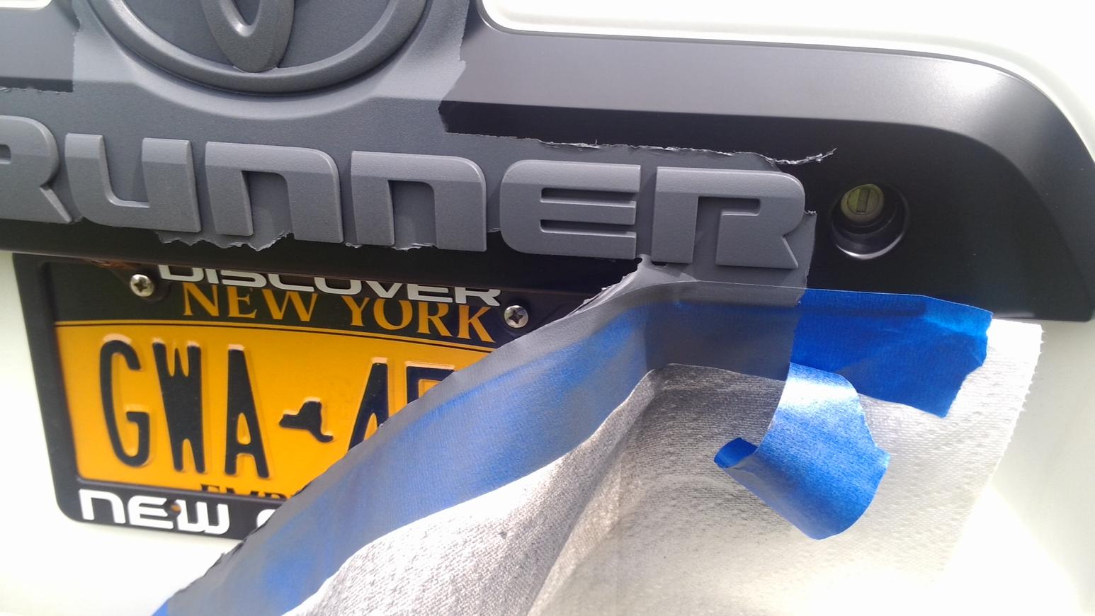

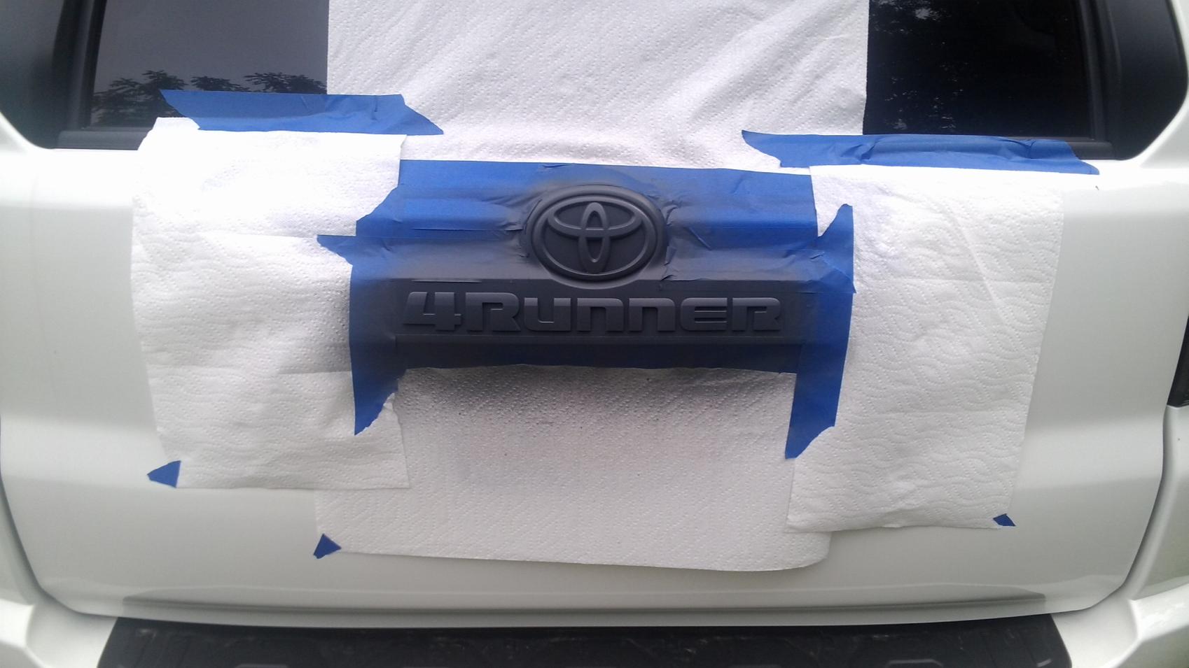

Plastidip Emblems Gunmetal Grey

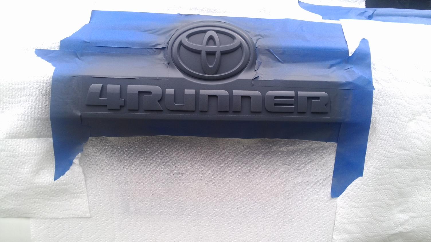

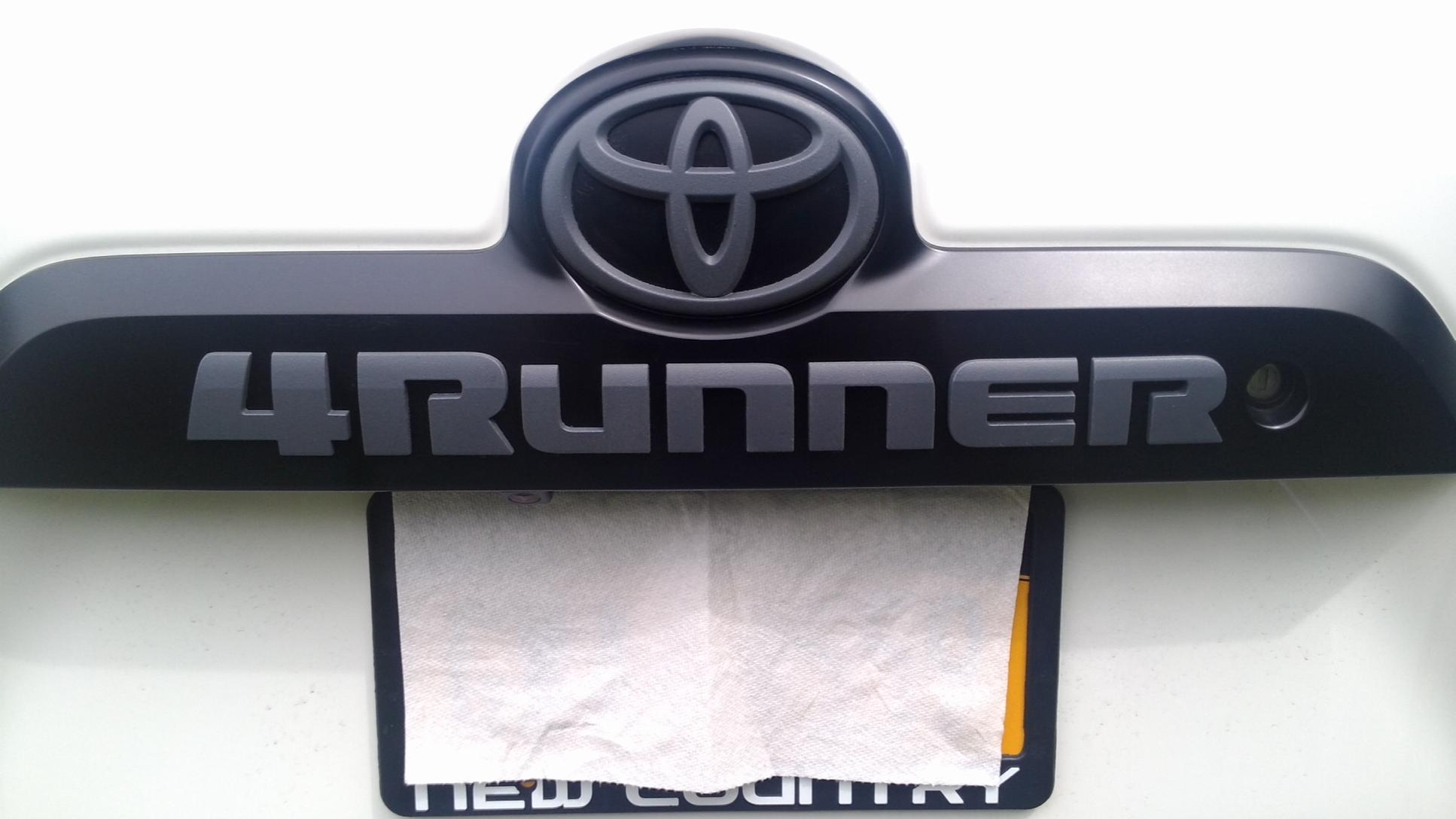

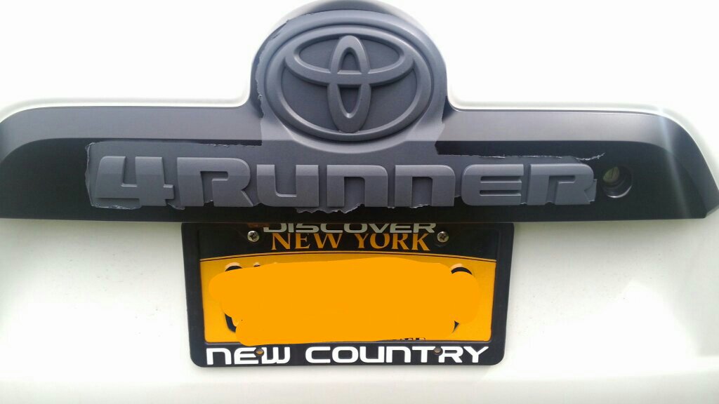

Plastidiped my shiny rear emblem and letters gunmetal grey. I wanted them to somewhat match the front TOYOTA emblem which came grey. Picked up a can of Plastidip at Wallyworld for about $6. Cleaned the emblems and surrounding area with a wet cloth and dried it well. Taped off the outer area to catch over spray and started with a light coat which came out a little splotchy but dried flat. Shook the can well and cleared the nozzle between each coat. Second coat really covered well and definitely showed the grey color. Third coat was a little too close trying to get the nooks and crannies and ran a bit but it too dried flat and even. Fourth coat was just to touch up a couple of still shiny edges.
Waited 15 minutes between coats and an hour before peel off. Patience and a little guidance brought much of the excess off. Used a couple of toothpicks to remove the rest between the letters and within the emblem. A little rough on a couple of edges up close but overall turned out better than I expected. I'm happy with it and think it looks much better. Next up, roof rails.
If you search this forum and YouTube you'll find a bazillion tutorials on how to do it. Yes, a bazillion. I counted them.

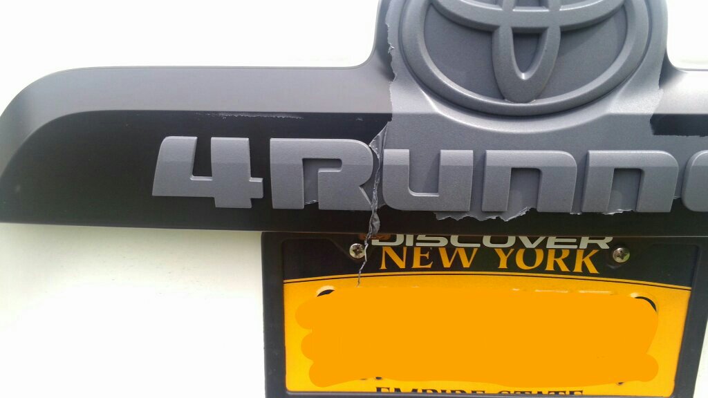

Peeling Plastidip
A couple more shots of the peeling process.

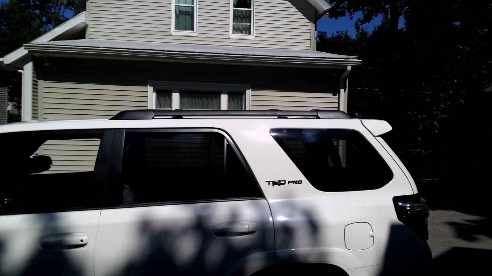

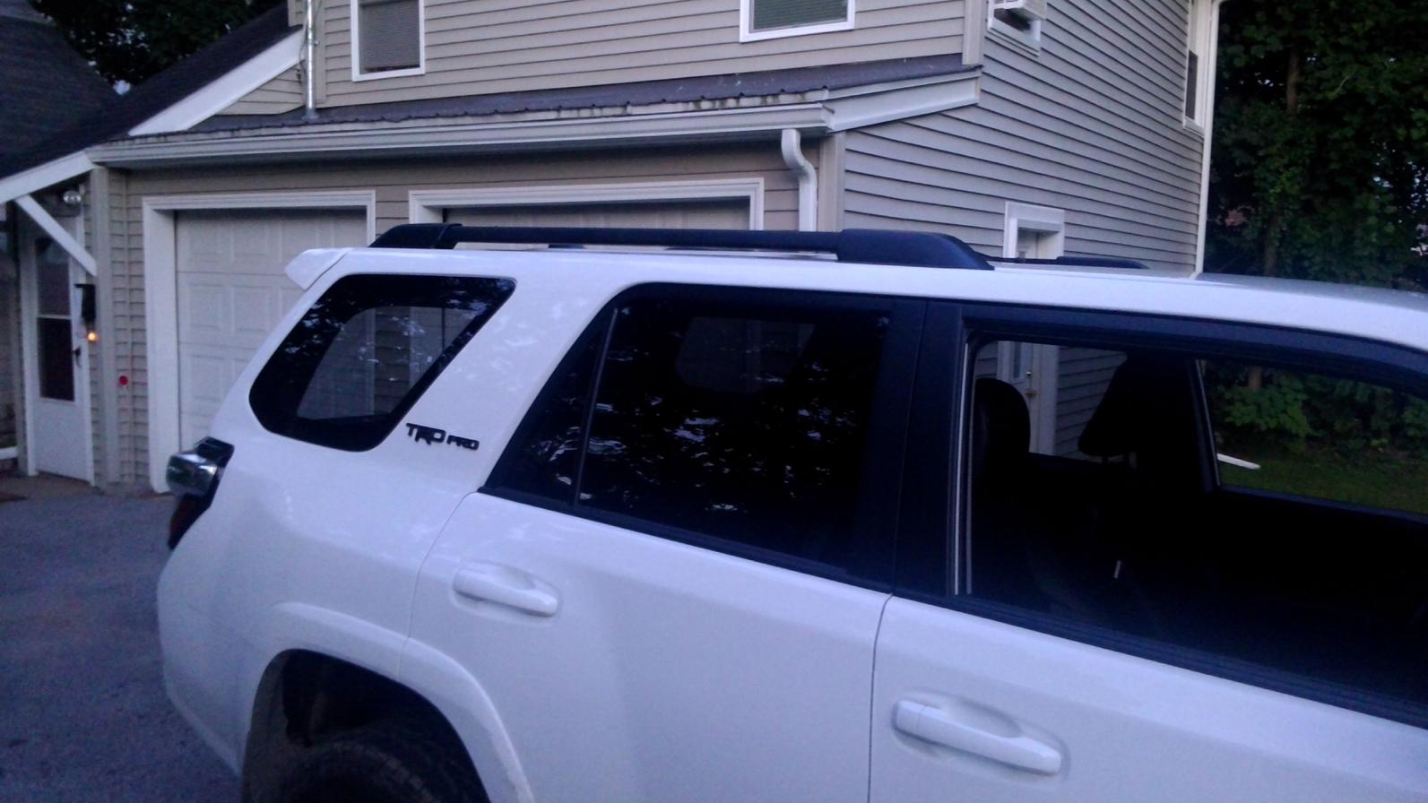

Plastidip Roof Rails

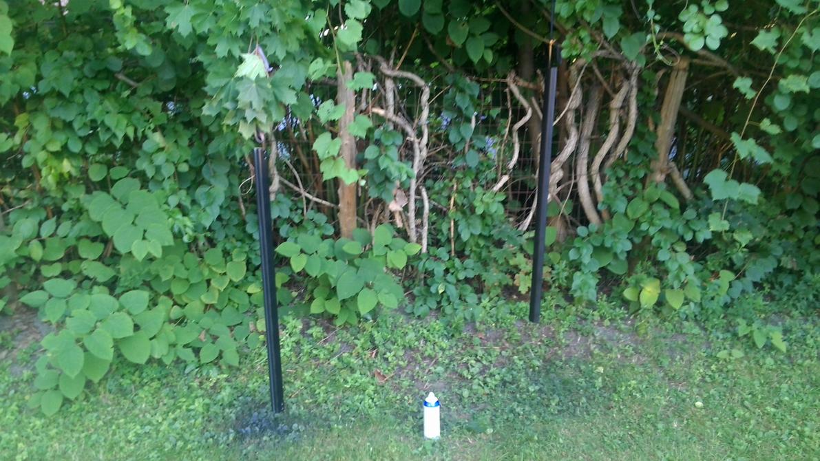

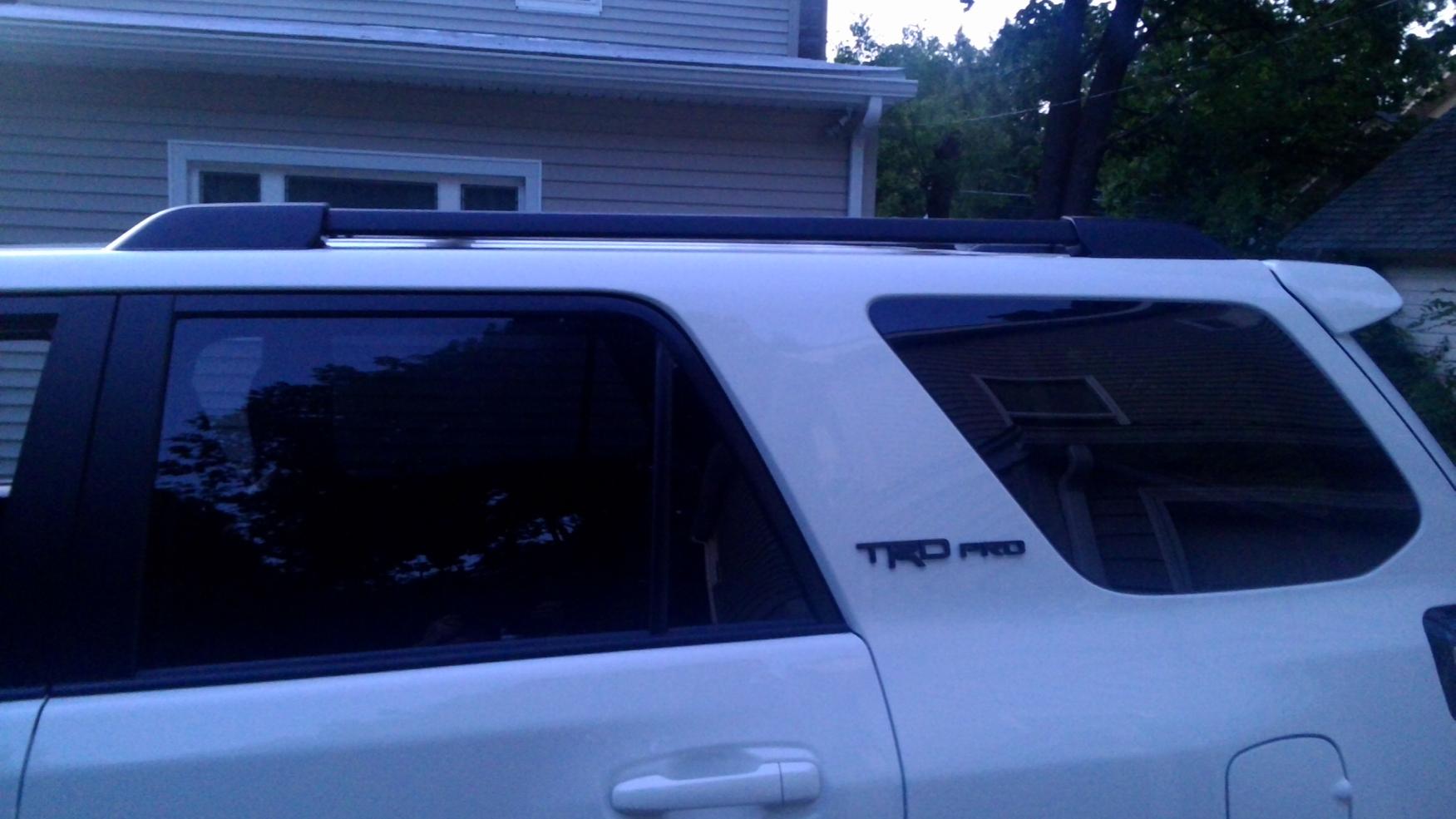

Plastidiped my roof rails black. Looks much better than the silver. I had some grey Plastidip left over so put on two coats as a base and then sprayed two coats of black. It was very humid out so the finish is a bit uneven and I had to touch up several spots where the grey showed through but they turned out pretty good.
Hung the rails from a couple of trees out back. Worked out well.
I used medium loctite on the rail bolts when putting them back in and put silicone around bolt heads for weather tight protection.

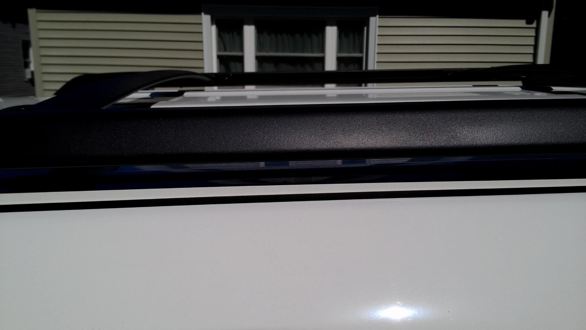

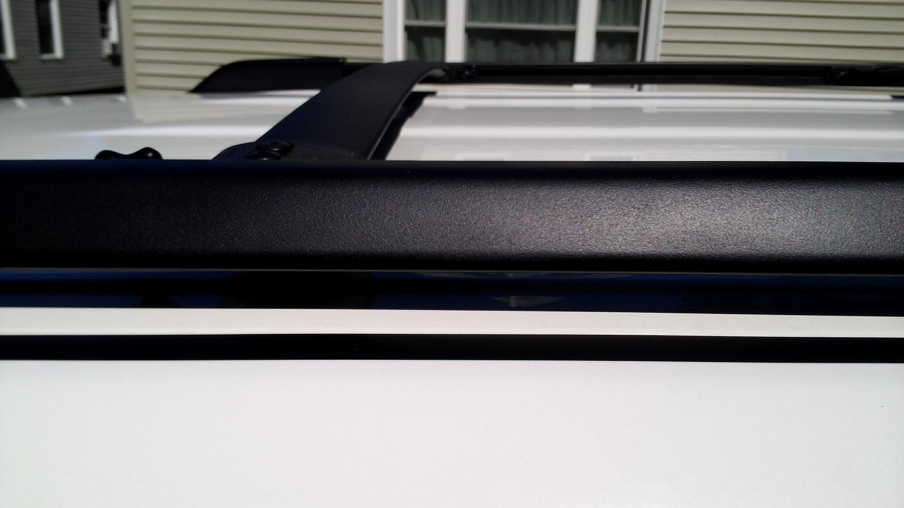

Closer shots of the texture and finish of the black Plastidiped rails. They dried to a nice even finish. I like the textured velvety look. Thanks to everyone who share these great ideas.

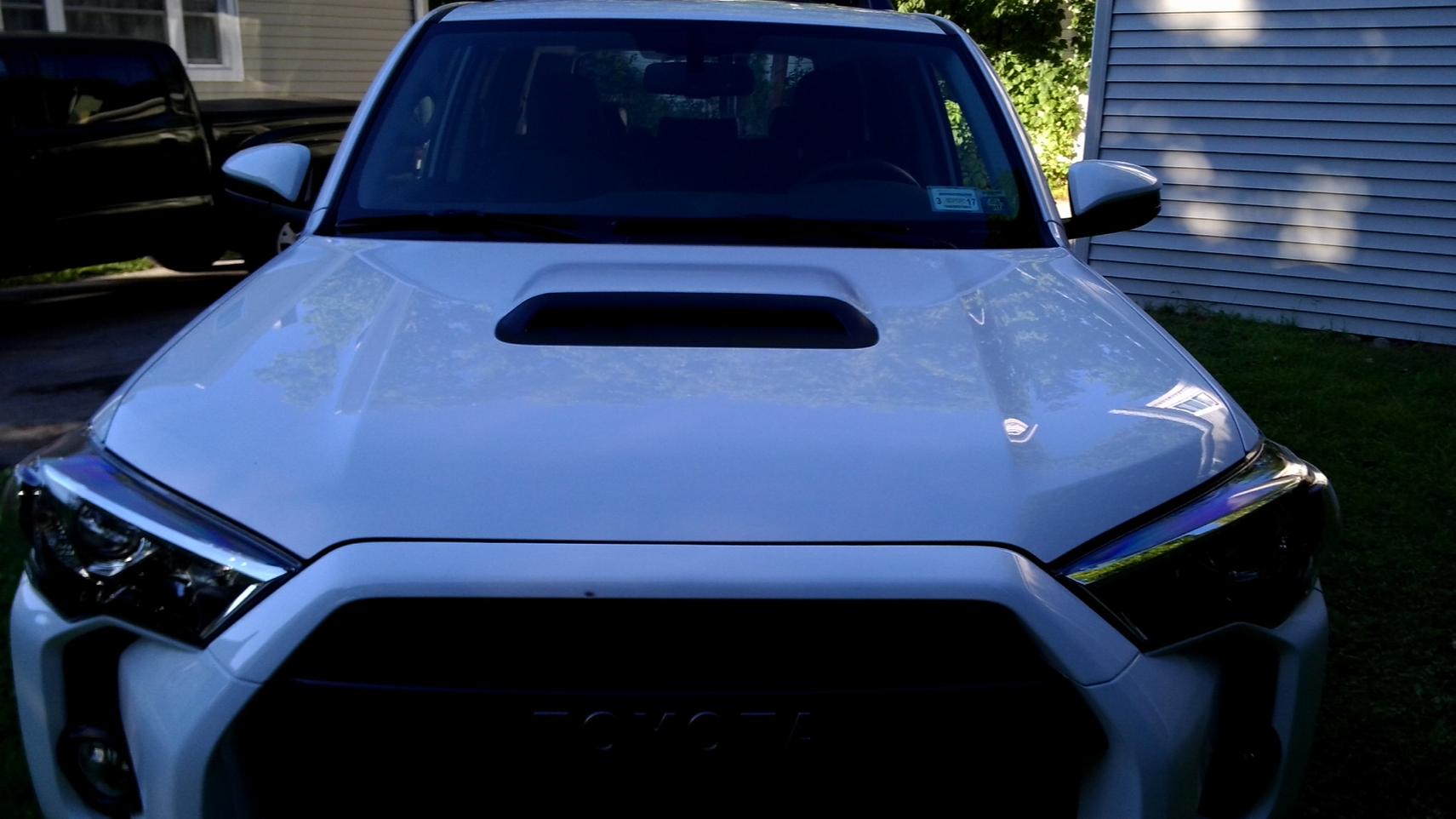

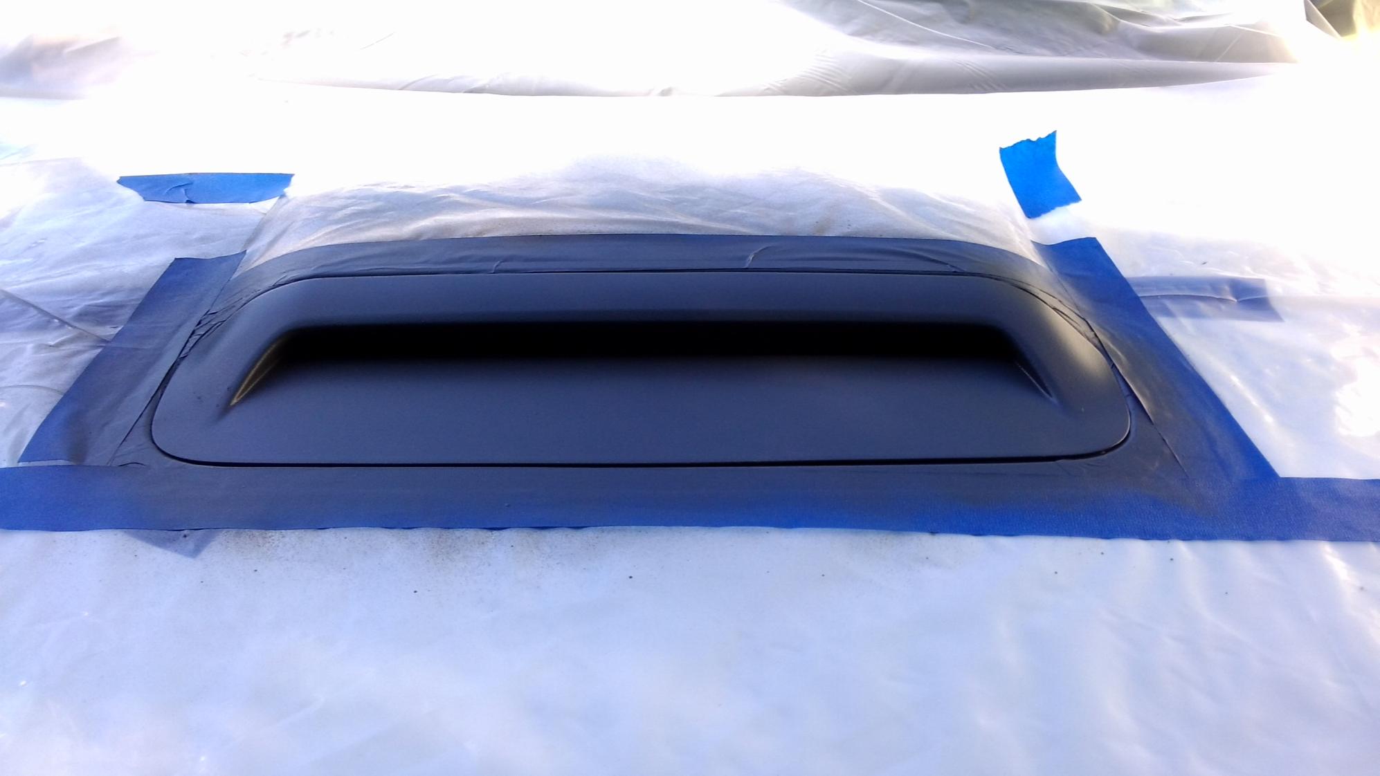

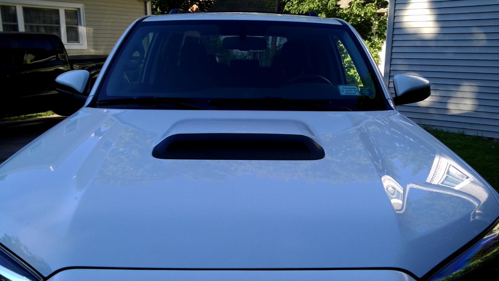

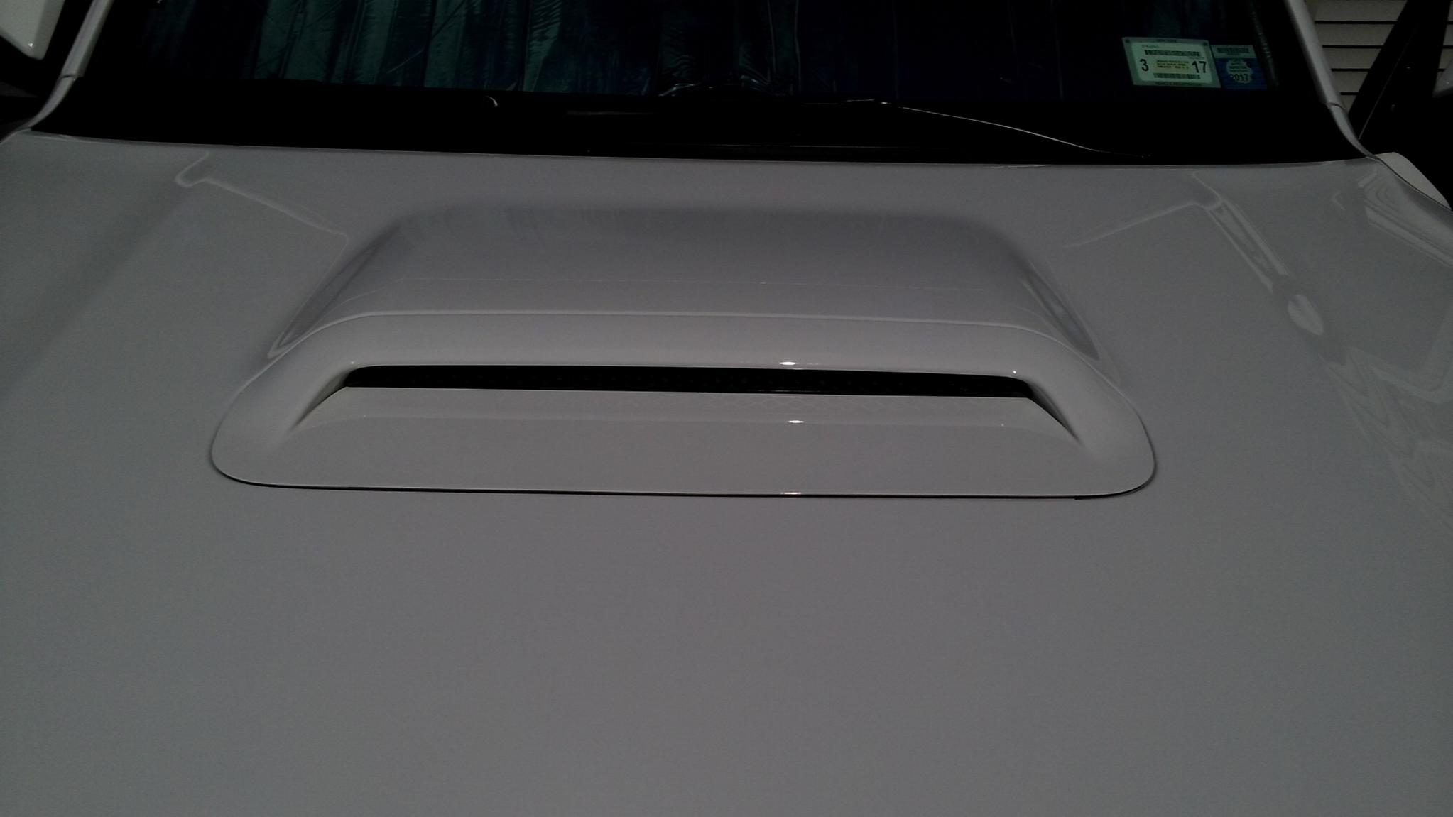

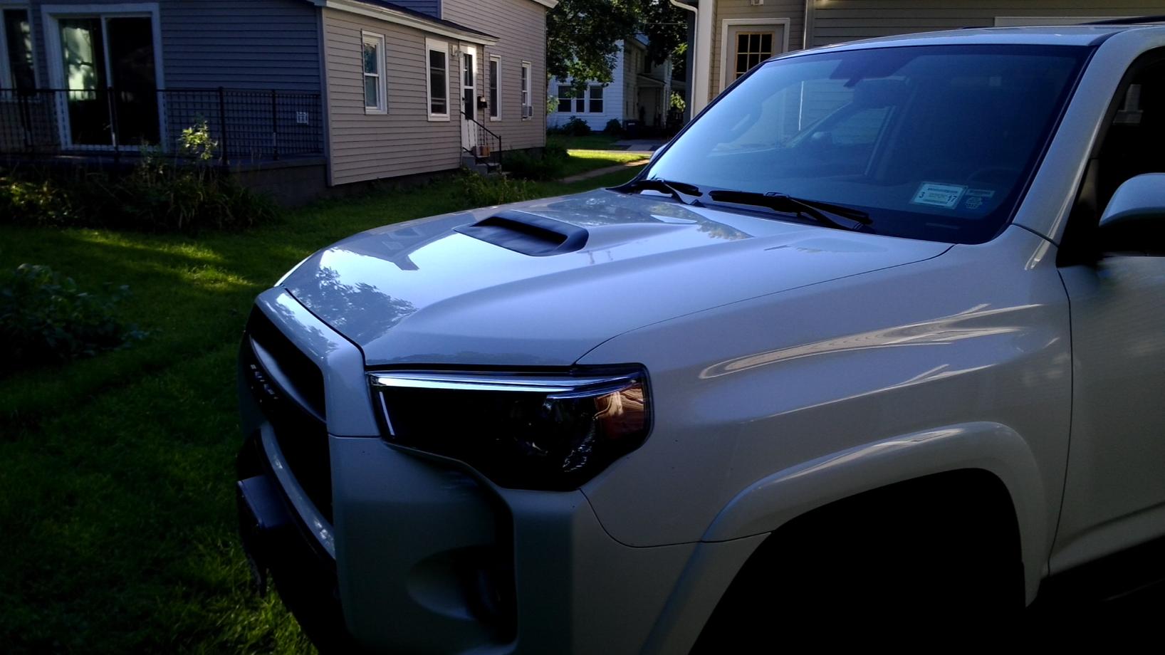

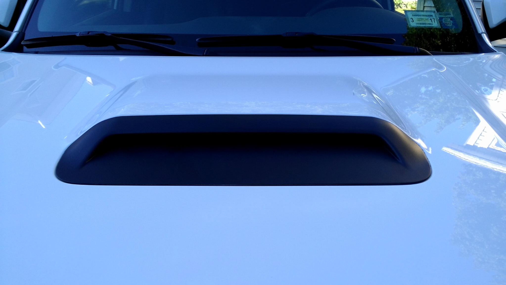

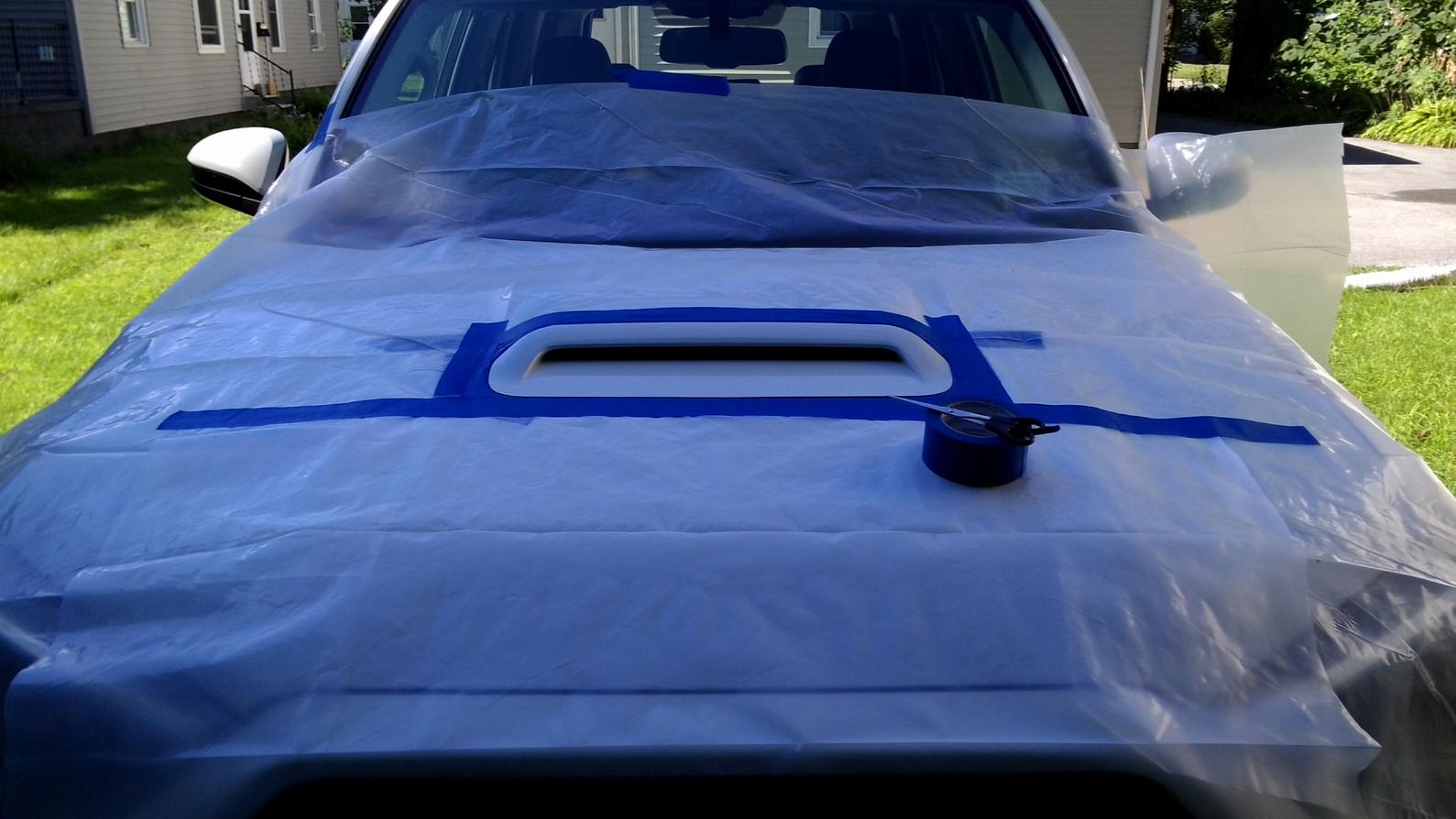

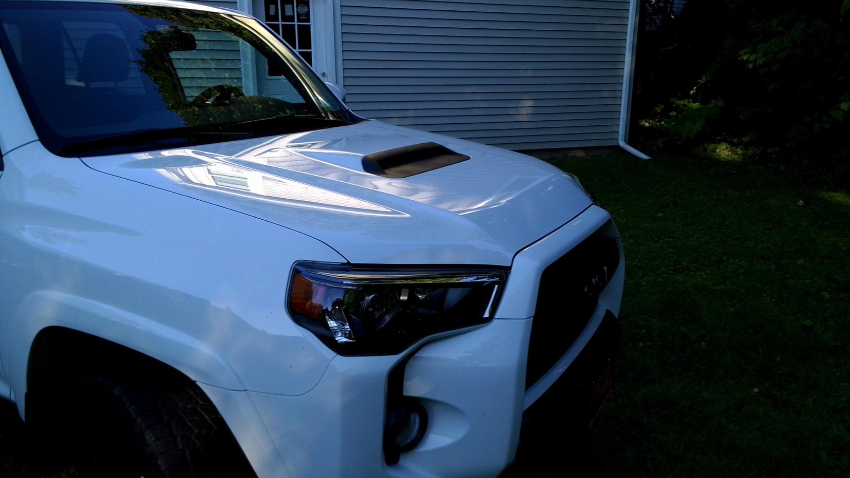

Black Plastidip Hood Scoop Tip
Plastidiped my hood scoop black today. Did not remove it from hood, used some plastic and painters tape to cover hood. Used 3 coats of grey plastidip I had leftover for a base to cover the white. 15 minutes between coats. Then 3 coats of black. Be careful how you mask the edges with the tape. In one area the tape came up a little on the edge and caused the plastidip to pull as I removed the tape revealing a couple of small white spots. (Which I colored in with a black sharpy. lol) Had a little overspray on the hood which wiped right up with a micro fiber cloth. I am pleased with the way it turned out. Pops with all of the other black accents.

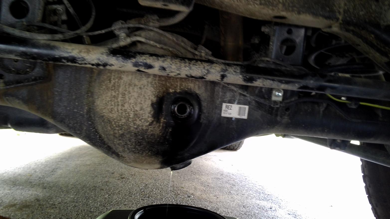

Changed Rear Differential Oil

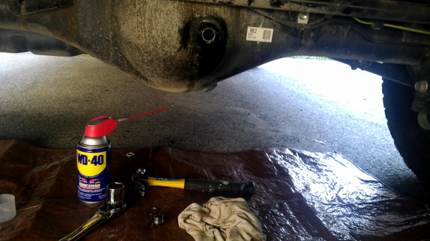

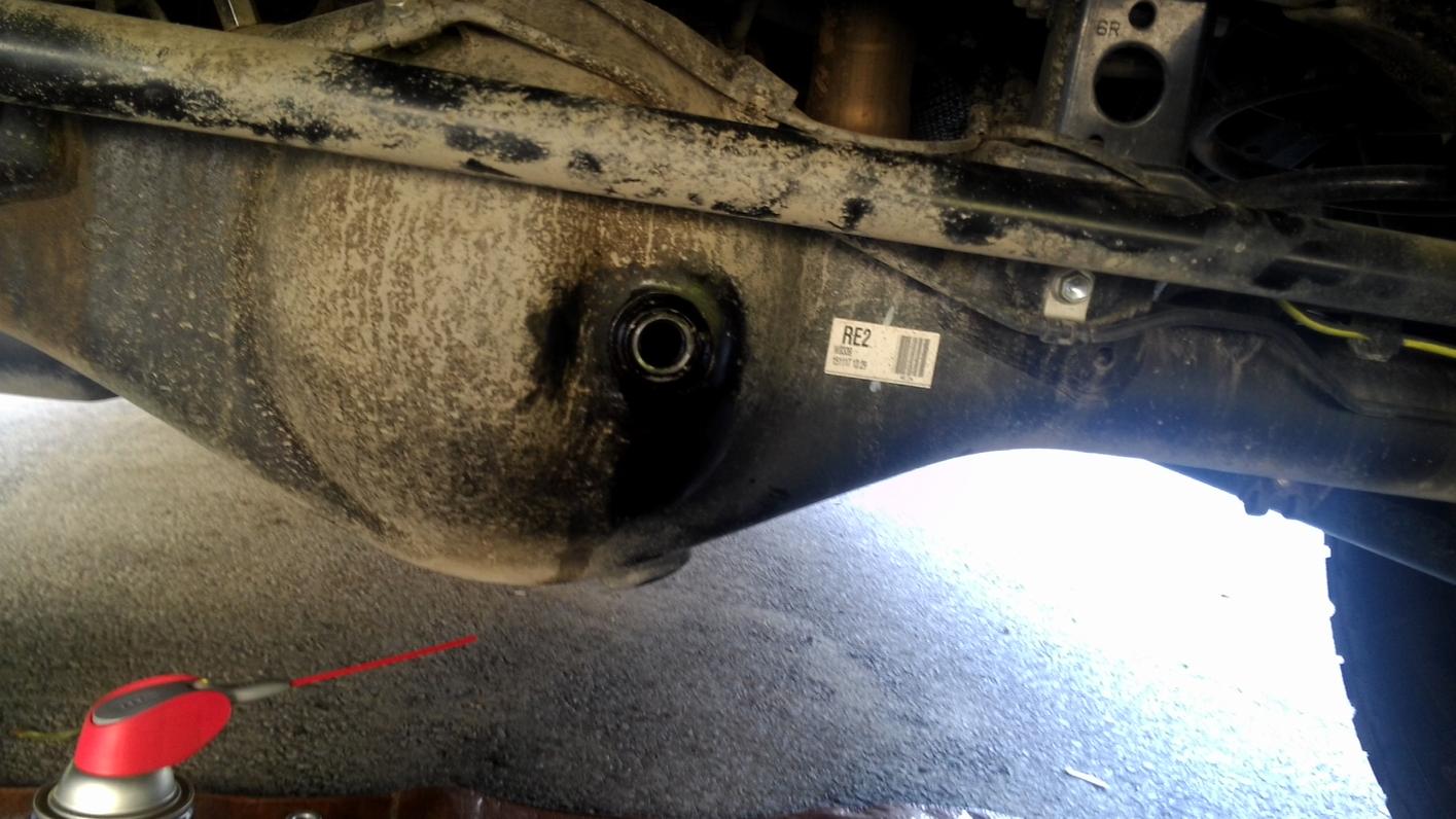

I changed my rear diff oil because before I did my breather mod I went through several washouts at least up to a foot deep, one was back in March when the water was full of ice chunks. I have just 4950 miles but want to be sure.

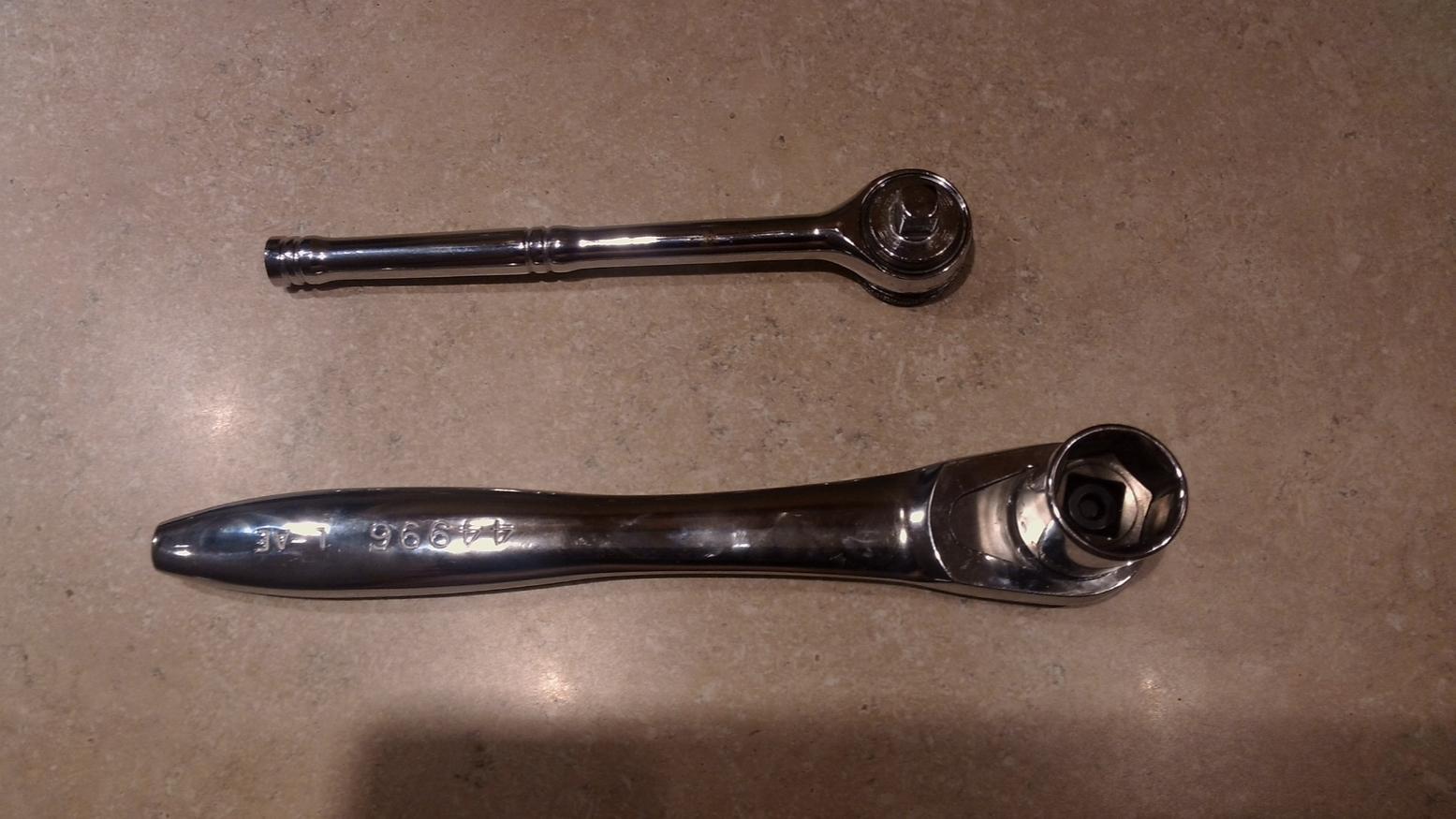

I tried to check the oil but the fill plug would not budge. I used a 12 point 24mm socket adapted to a small 3/8" rachet. I read alot of various vehicle forums where evidently this is a notorious problem. Solutions ranged from breaker bars, pipe plug sockets, heat and hammers. Notably most warned against pneumatic wrenches for fear of cracking the housing.
Sprayed WD40 on it yesterday and today, tapped on it with a hammer and put a larger 1/2 " ratchet with a 6 point 15/16" socket on it. Pulled down with everything I had (and I weigh 200 lbs) but no movement. I feared rounding the bolt head so went in and had lunch. Later I tried again, more WD40 and tapping, I put the ratchet on to push up and it gave. I thought, Shit I've rounded the head but tried again and it came right out with no damage.

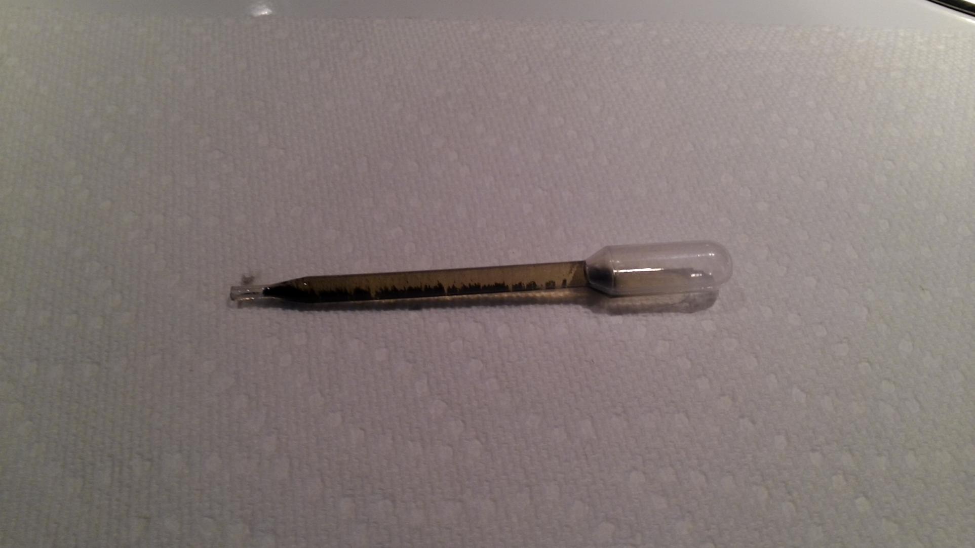

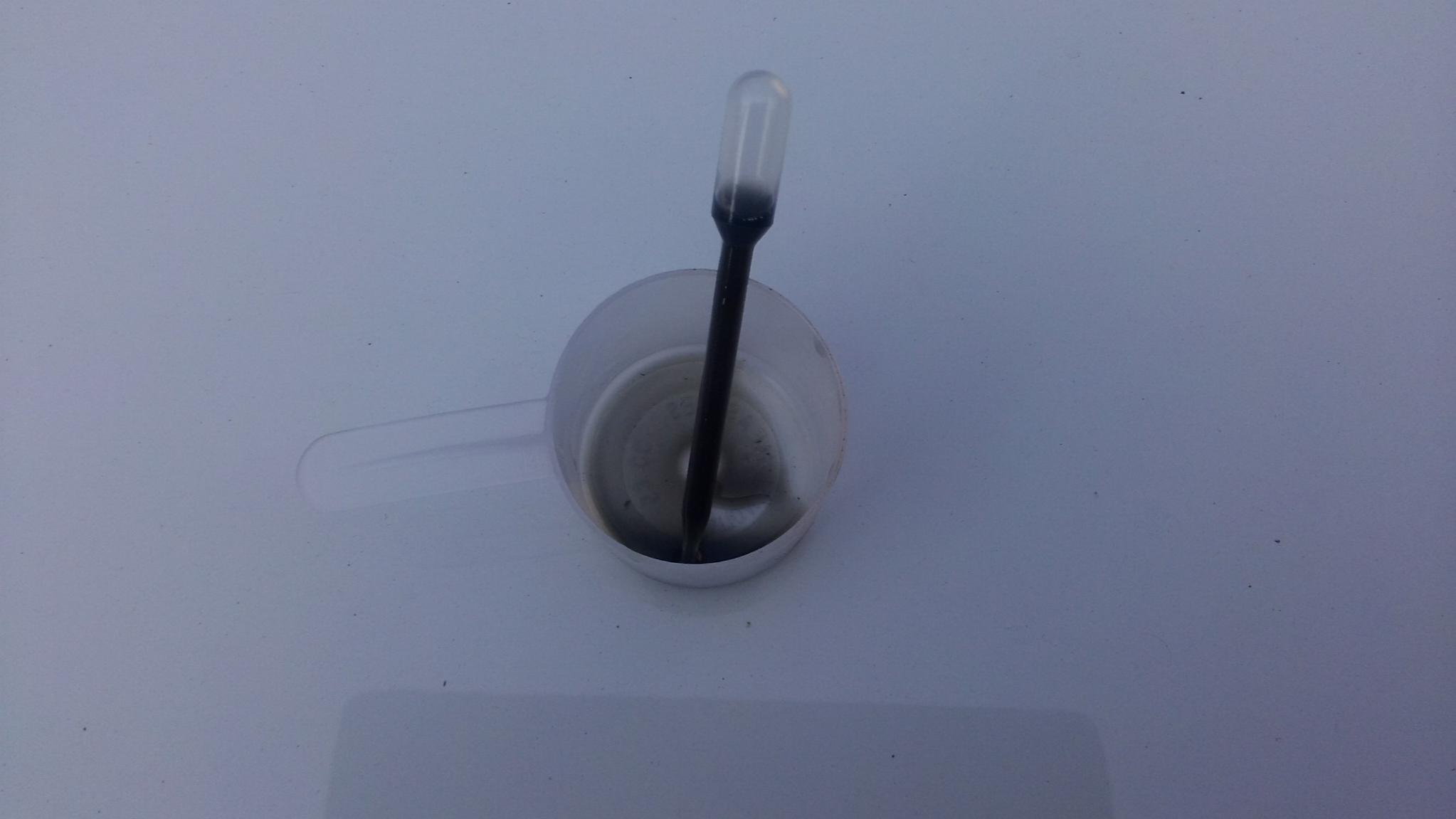

Rear Diff oil change
So put a little dropper in and sucked up some juice and as you will see, it is as black as night. It still feels slick but I'm guessing it ain't good if it looks like that!
After letting my oil sample set for two days the sediment settled out and the oil turned clear. I squirted some onto my finger and the sediment is very fine, barely able to feel it. I'm still changing it though.

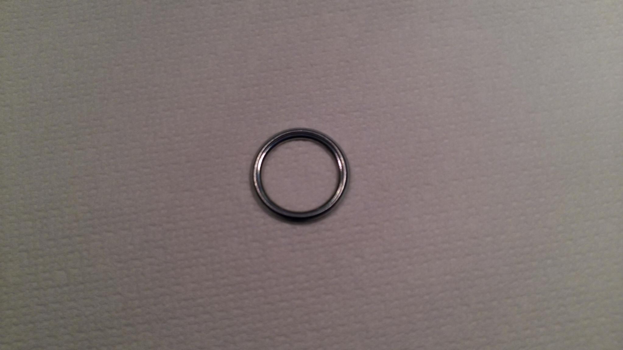

Rear Differential Plug Crush Gaskets
Picked up three plug gaskets from the local Toyota dealer. The same gasket goes on both the fill and drain plugs. Cost 4 bucks and change.

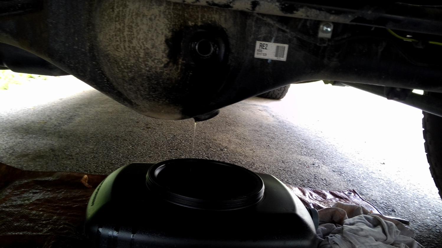

Rear Differential Oil Change
Drain plug came right out no problem.
