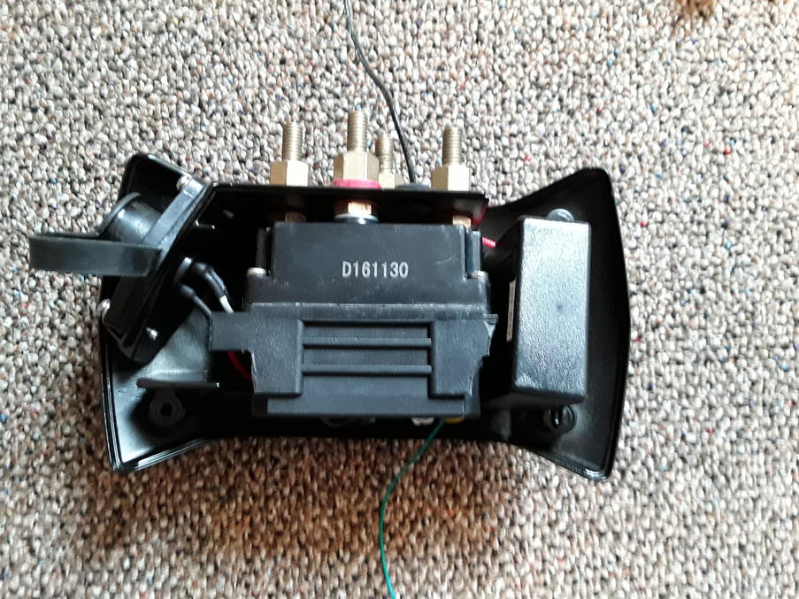

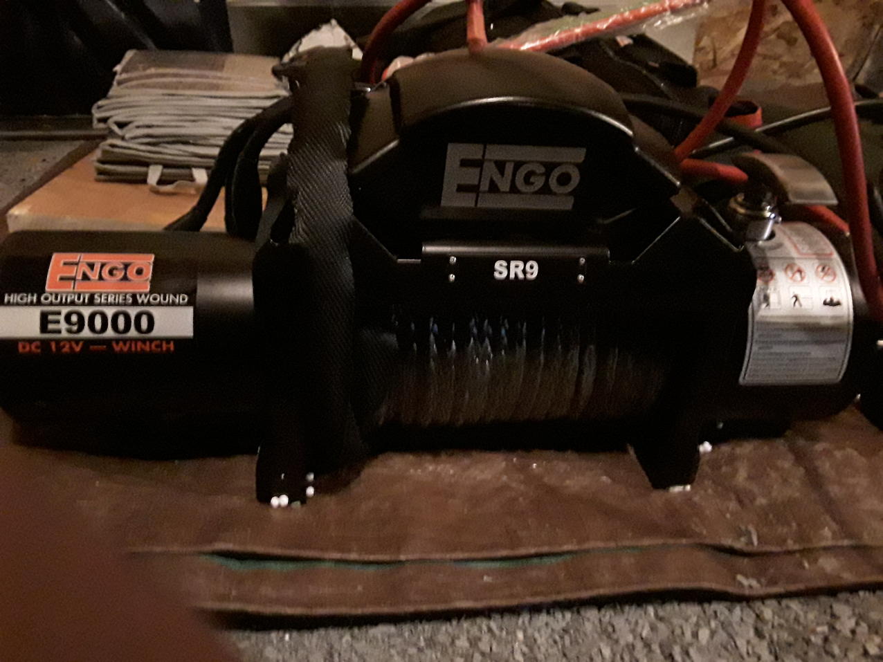

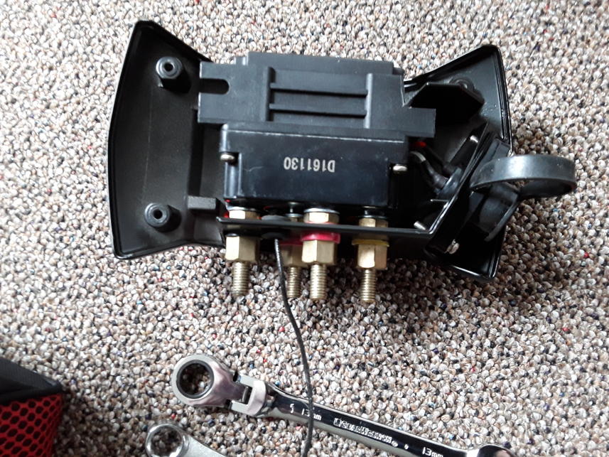

Installed an Engo remote controller onto my Engo 9000 S winch SR9 solenoid today. The details follow below.

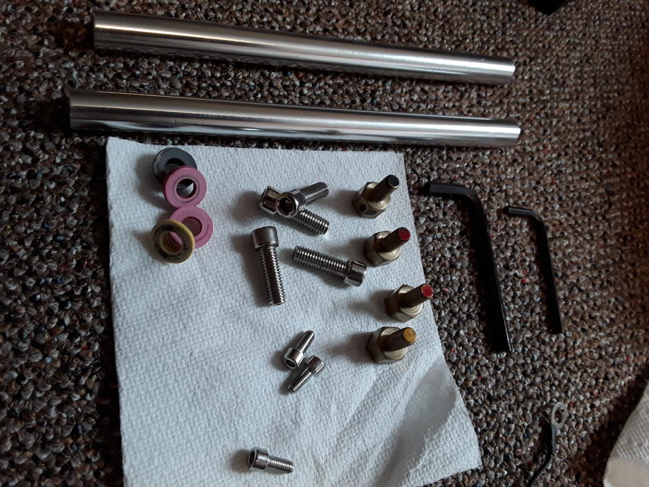

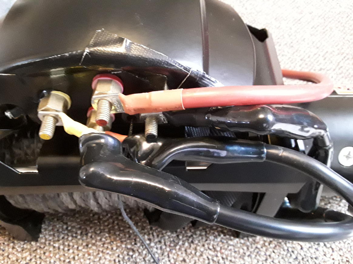

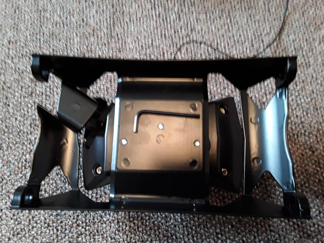

First I had to unbolt the main power cables from the back of the solenoid. Then I removed the solenoid chassis from the winch housing. There are four 6 mm hex bolts bolted into spacer tubes which hold two halves of the winch onto the drum. Once the chassis is removed underneath there are three 4 mm hex bolts which hold the solenoid housing together.

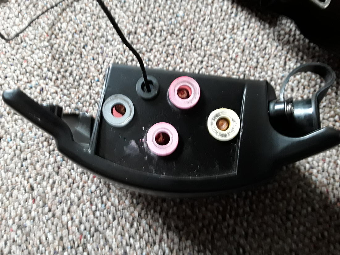

Then remove the outer connection bolts from the solenoid housing. Be sure to pay attention to the color of the connections. If you screw these up you're going to burn out your solenoid have a bad day.

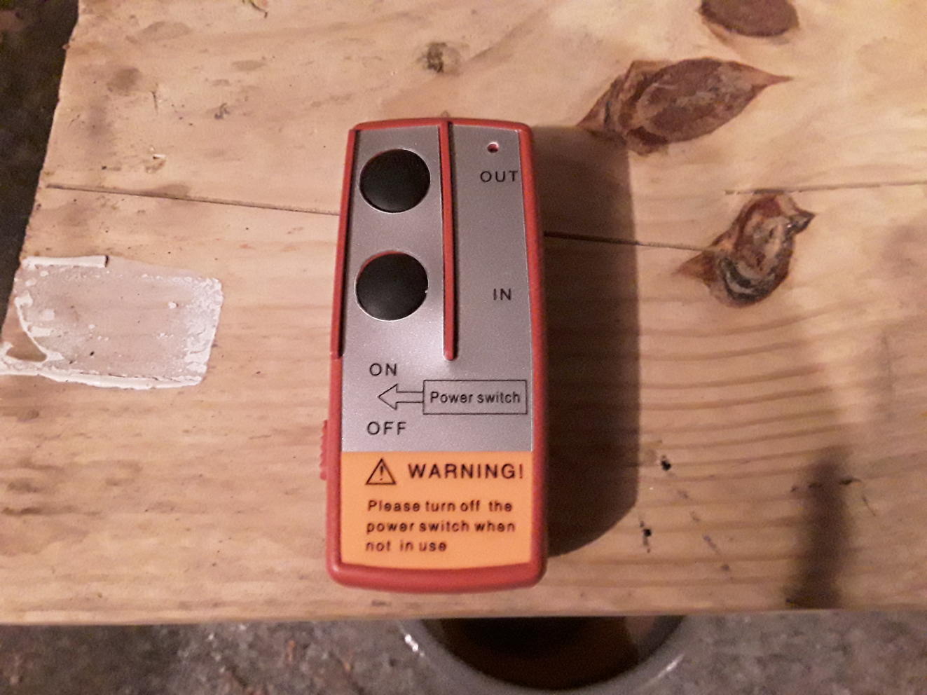

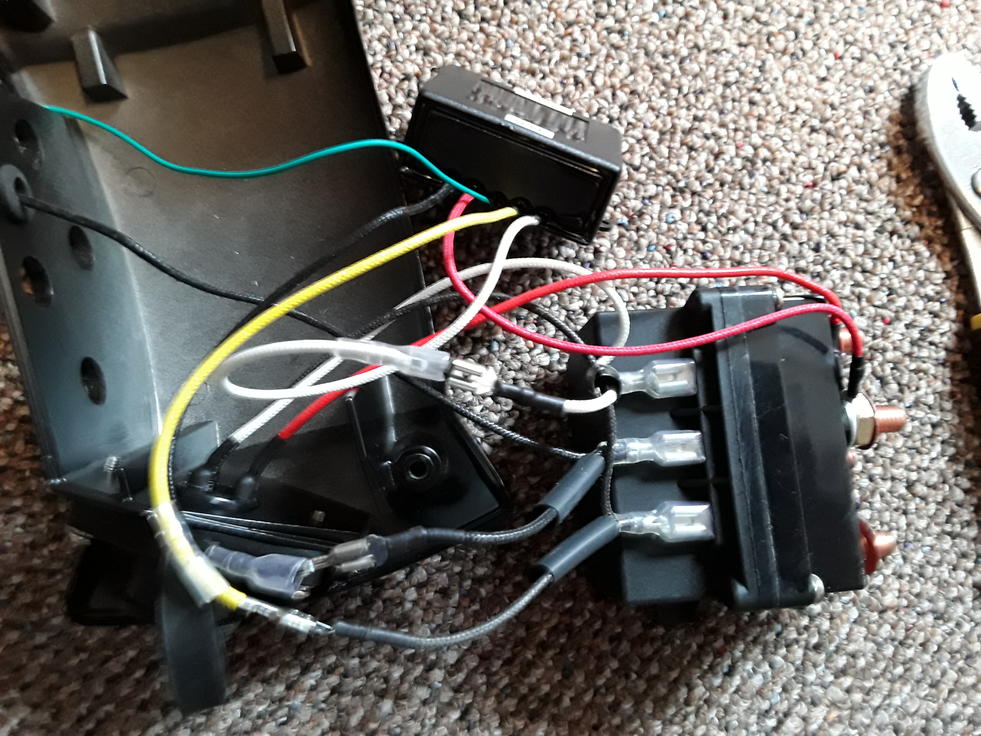

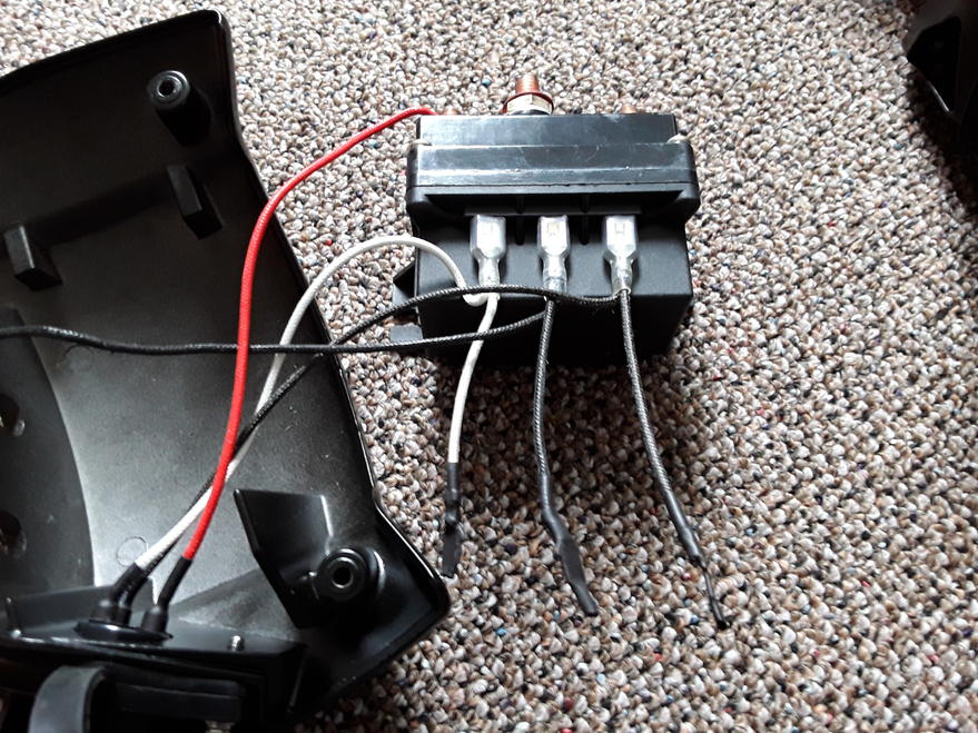

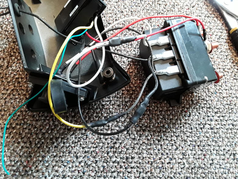

Once you have the solenoid out you see four wires; red, white and two black. The remote controller has black, red, green, yellow and white wires. The black wire from the remote controller connects to the black ground wire, in the middle, on the solenoid. This is the connection that runs to the underside of the winch motor and connects with the black grounding cable that runs to the battery.
The red wire piggybacks onto the red connection on solenoid. This is your hot wire.
The green wire is the the radio wire, it is left loose in the housing.
The yellow wire connects to the black connection farthest on the right.
The white wire connect to the white connection. The white and yellow are the in and out controls.
I sealed the connections with heat shrink tubing.

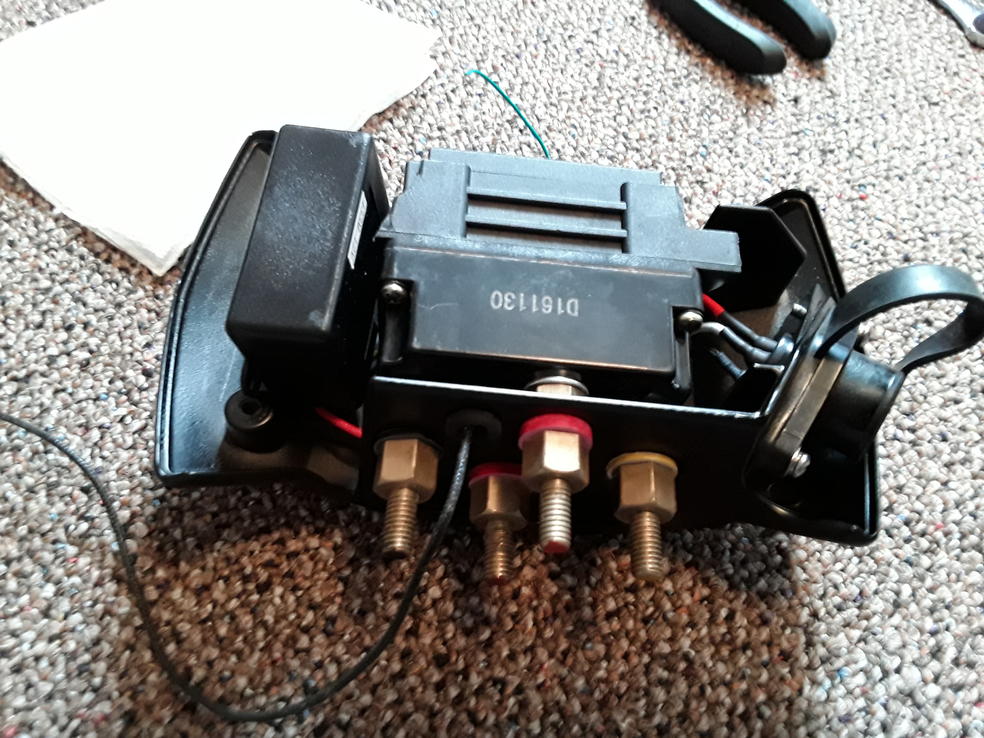

On the left of this next pic you'll see a plastic screw slot tab. This needs to be cut off so the control box can fit in to the solenoid housing. The next two show the controller in the housing. From here on out just put everything back together again. Remember to pay attention to the color coding of your main power cables.
Taking my time and sorting through all of this took me a few hours. But having gone through it I'm so glad it worked! I really did not want to have to take all apart again to troubleshoot. Now I wait for the weather to warm up so I can install the winch on my truck.

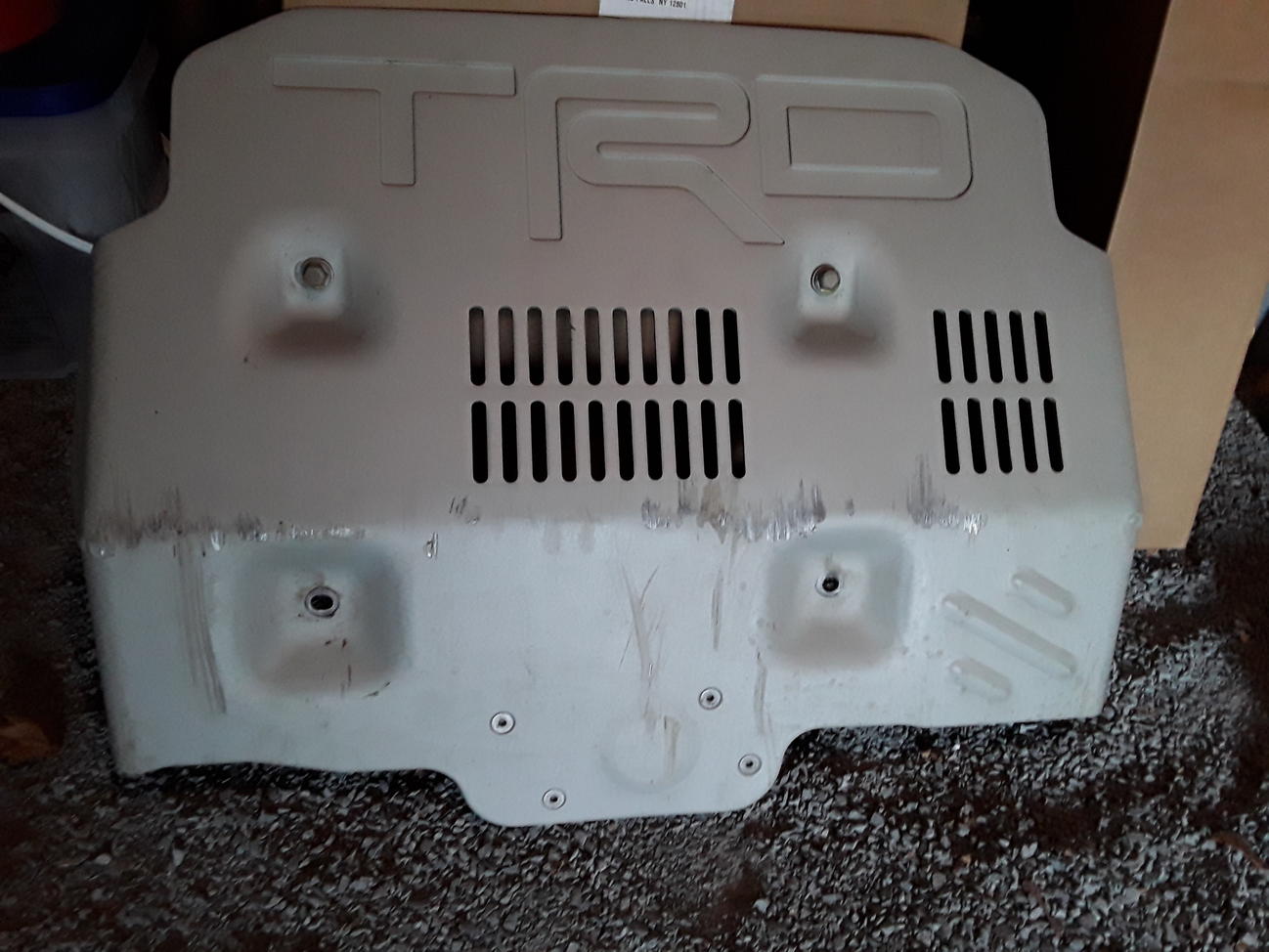

Changed the front differential oil today. ODO at 11017. Put in Amsoil Severe Gear 75 W 90. Factory skid came off ok. Plugs came out easily. Old oil black but only a little sludge on magnet. Took off front skid in preparation for changing engine oil in a couple of days. Front skid bolts came out without problem. Evidently my dealer service dept did a good job with my oil changes. I will probably use Mobile 1 for the engine. I'm planning on a 6 month or 6000 mile interval schedule. Amsoil 0 W 20 is just too damned expensive.
Front skid is holding up pretty well.

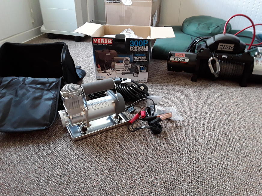

The Easter Bunny was good to me.

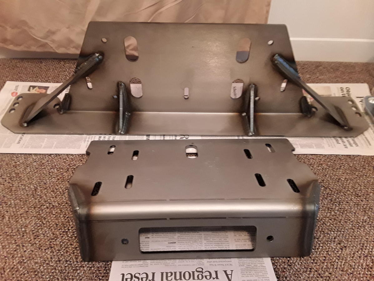

Got a Viair 300 P compressor and my RCI Aluminum Integration and steel Transmission and Transfer Case skids. As soon as the oil is changed I will Fluid Film the hell out of every thing underneath and install my skids. Then hopefully it will be warm enough to paint my mount and install my winch.
