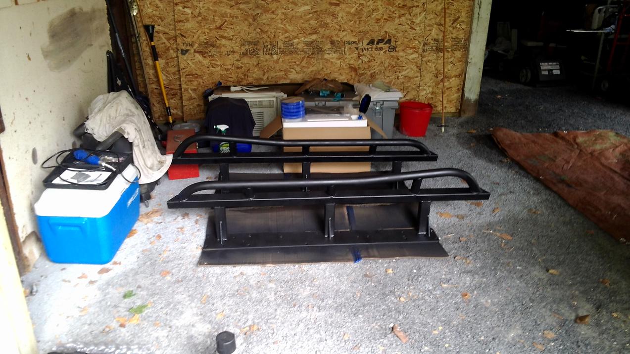

Pulled sliders to grind out rust and repaint and sprayed inside frame rails, cross members and lower A arms with Eastwood Internal Frame coating. (Six cans for 2 coats) Necessary Northeast maintenance.

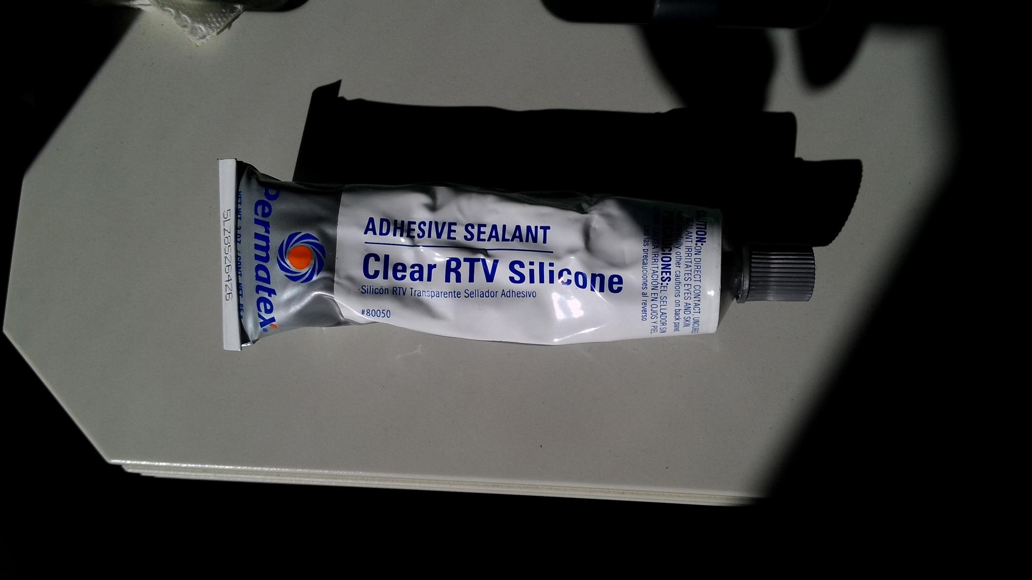

Sorry to dig this up, going to plastidip my rails as well. What sort of silicone did you use when resetting the bolts?
That's ok. It's what these threads are for. I used some basic stuff I got at the auto parts store. Pretty straight forward.

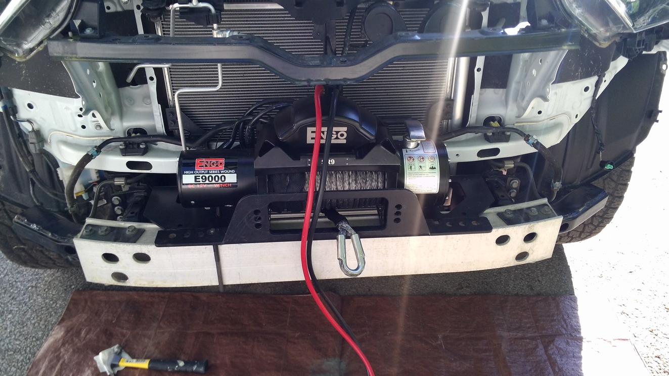

Budbuilt Hidden Winch Mount on 5th gen TRD Pro
Might as well update the thread while I'm here.

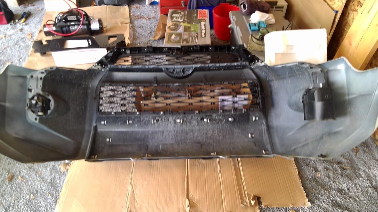

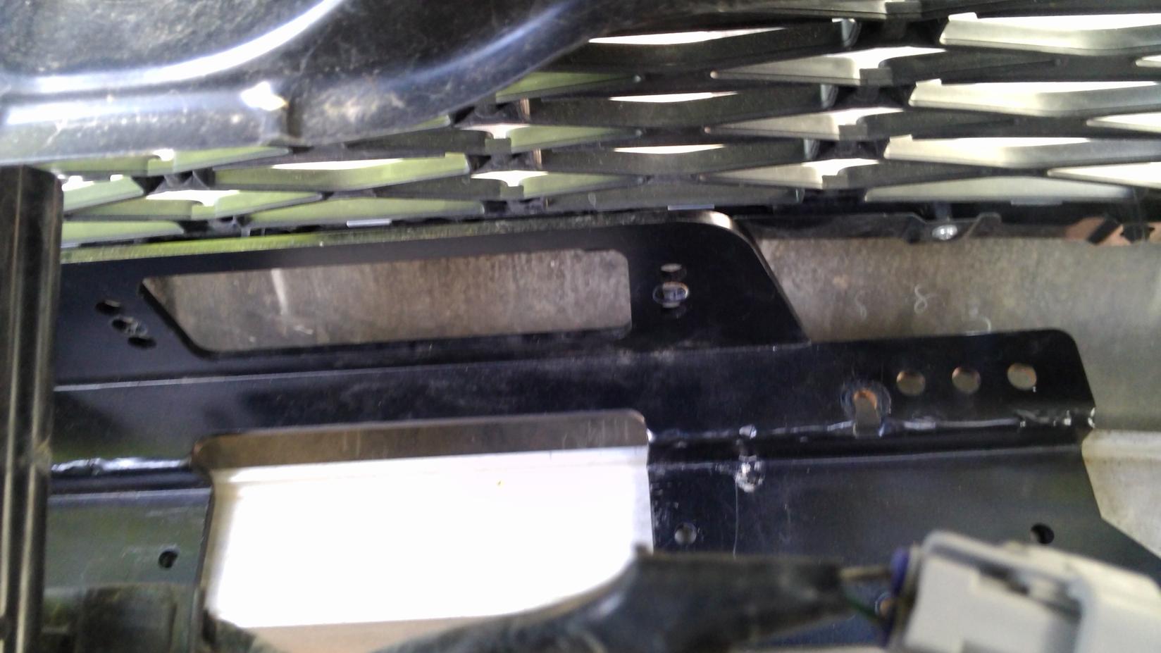

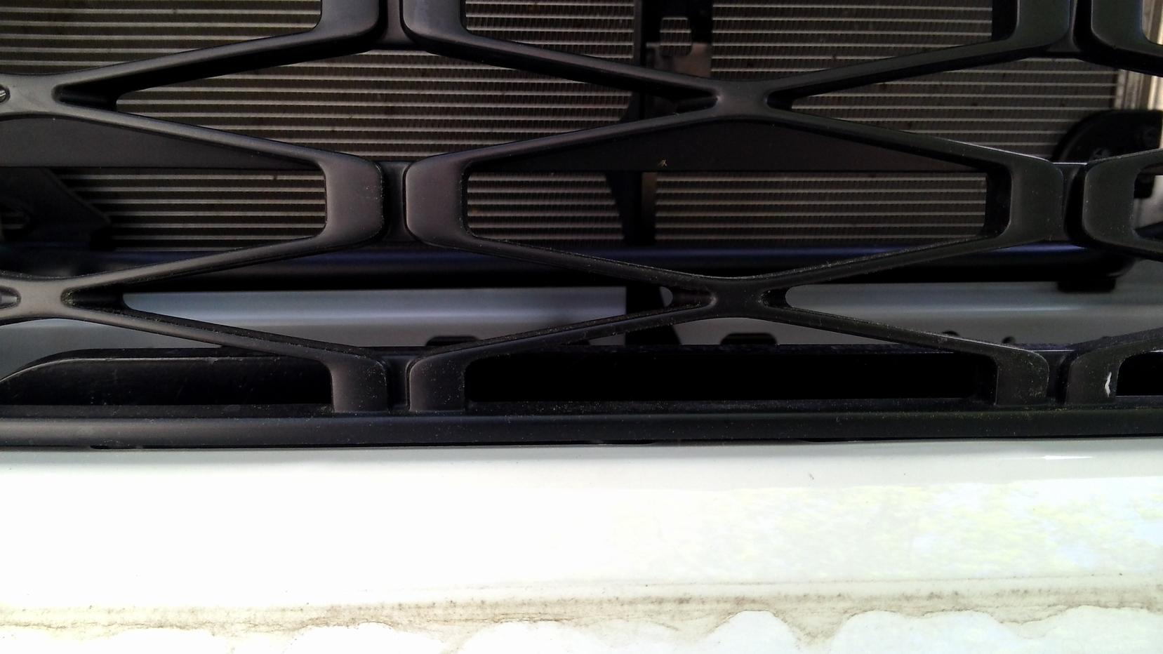

For the record: the Budbuilt HWM will NOT work with the TRD Pro grill. Due to the fact that the mount sits on top of the stock bumper, the vertical fairlead mount plate sets too high in the grill mesh. The fairlead mount needs to be in the license plate area on the Pro and I believe also for the Trail Premium.

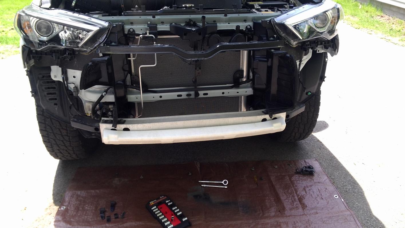

I bought an Engo 9000S winch and got a great deal on the Budbuilt mount from a member. Pulling the front end off was a matter of following all of the bolts, screws and clips to get everything to come loose. Pulling the side panels out over the wheel wells is nerve wracking first time but they pop out in one piece with a little persuasion. If I remember correctly all of the bolts and screw heads are 10mm. Just keep track of which goes where when reinstalling. I waited a day before putting it back on and had a brief Oh Shit moment when looking at all of the connectors piled in the tray. A little patience and common sense got each one back where it belonged.
Also the connectors for the fog lamps have a little nub which when squeezed in alows the connectors to slide right out.

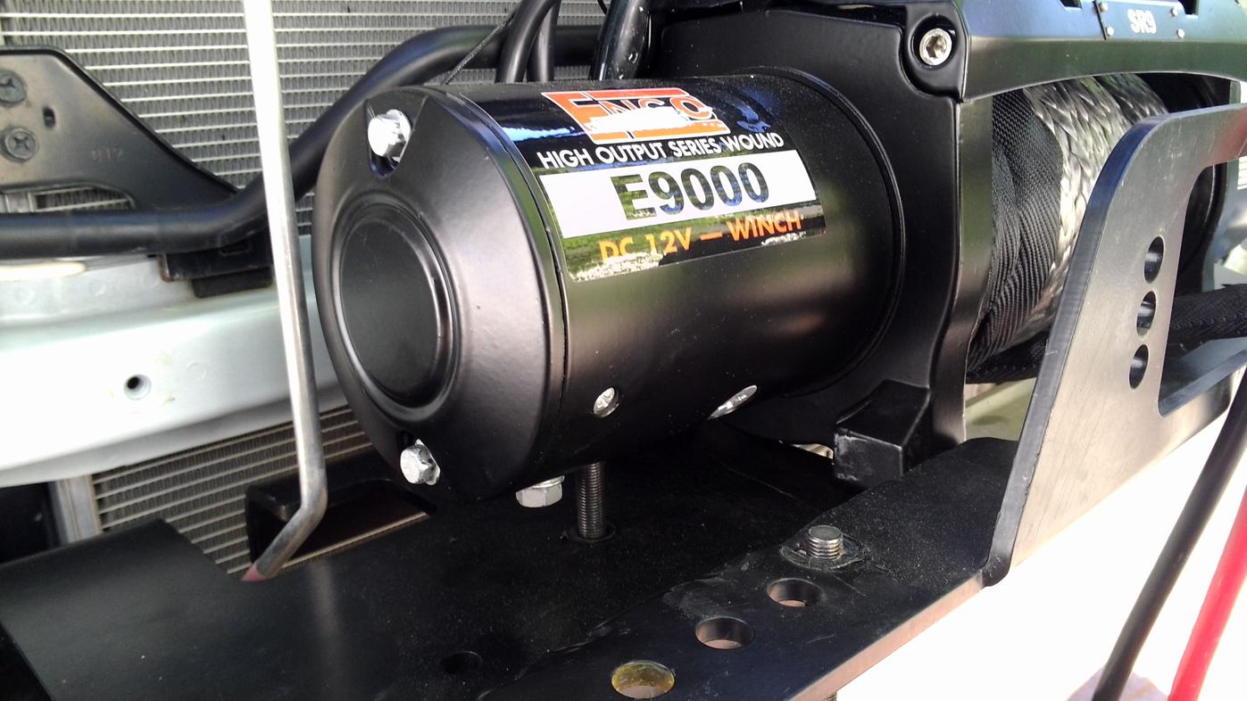

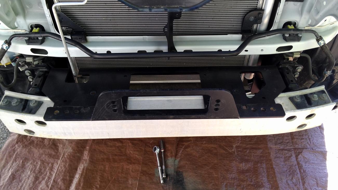

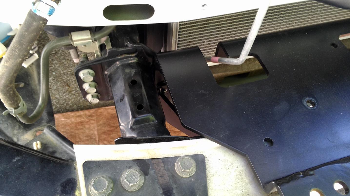

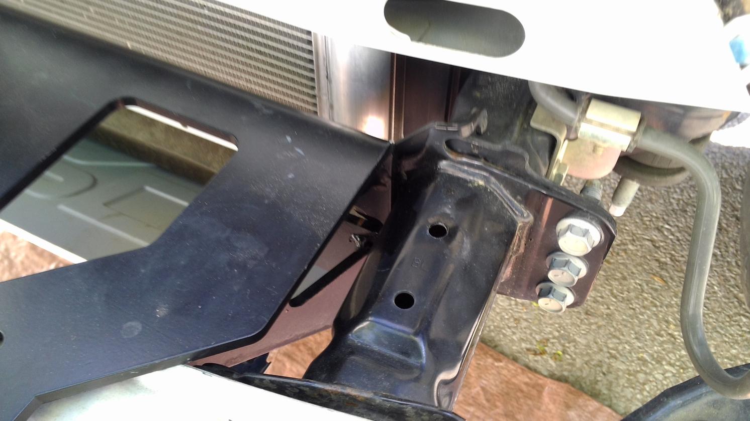

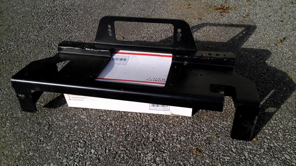

Budbuilt Hidden Winch Mount install
Mounting the Budbuilt on the frame and bumper was fairly easy. The mount bolts onto the two inner bolts only. Pull those two bolts out but leave the six outer bolts alone. In order to get the mount to slide in behind the bumper you have to pull the styrofoam off the front of the bumper and loosen the six bumper mounting bolts inside the bumper. 3 each side. Just loosen them an inch or two. Do not completely remove them. You will need a 14mm deep socket to do so. Once you do this the mount slides into place behind and on top of the bumper.
I test fit the whole set up by just setting the winch in place after removing the AC line brackets and moving the line back a bit. Everything fit fine. When I loosely hung the front end on to determine the fairlead placement I found the Budbuilt would not work with the TRD Pro grill. It sits too high and lands right where the plastic cross brace supports the lower grill. To make it work would require hacking up the grill, comprising strength and making the whole thing look like crap.
I was able to sell the Budbuilt mount to another member and am now saving for a Pelfreybilt HWM which is the correct mount for the Pro. This mount replaces the entire bumper assembly putting the fairlead lower where it belongs. Chalk it up to a learning experience.

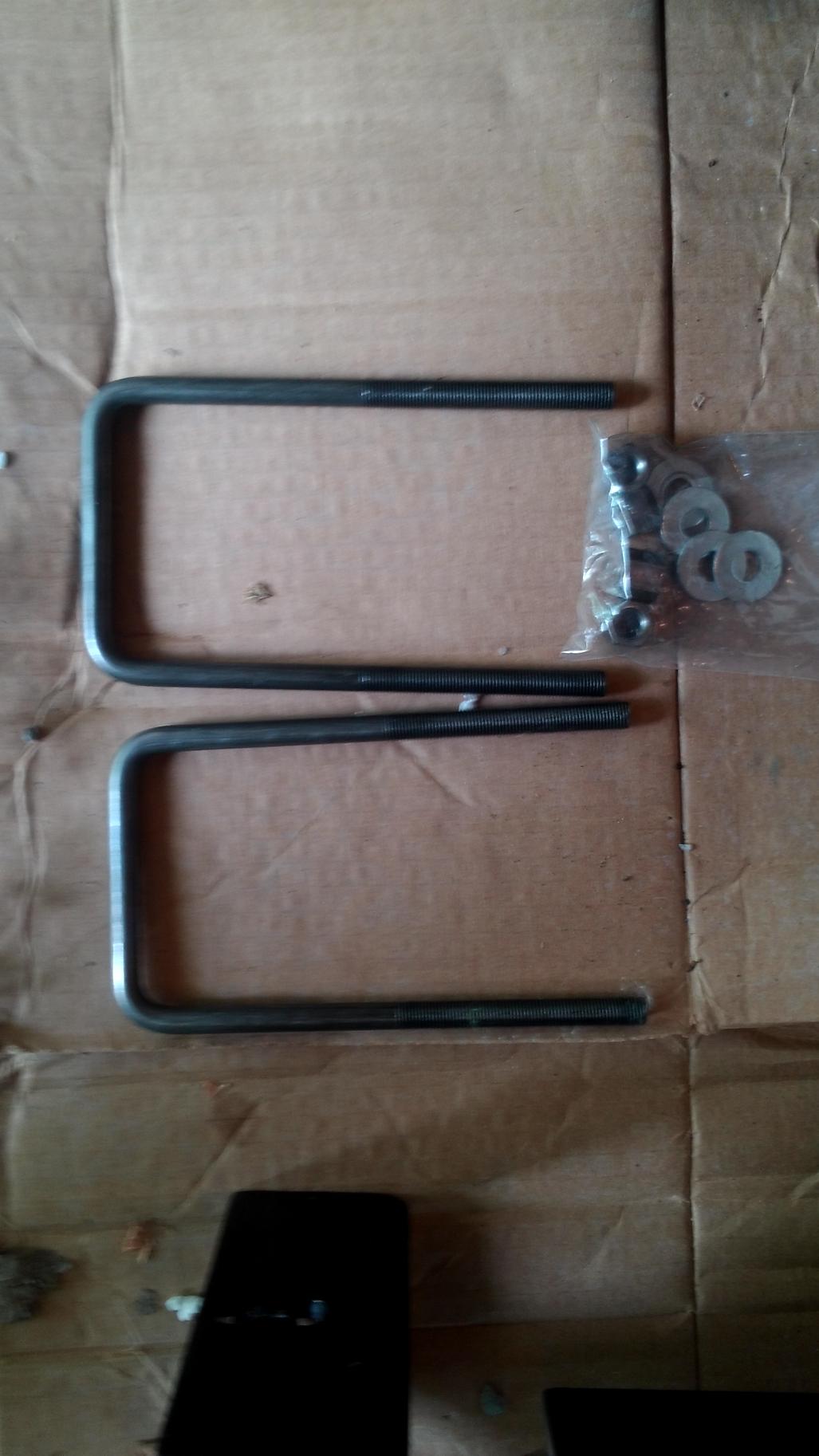

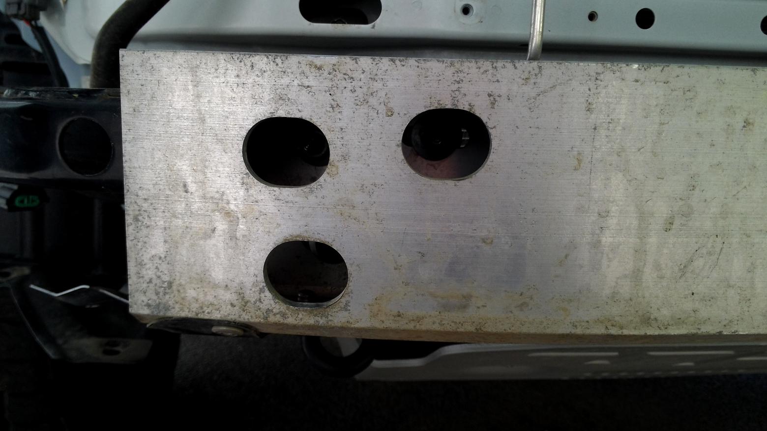

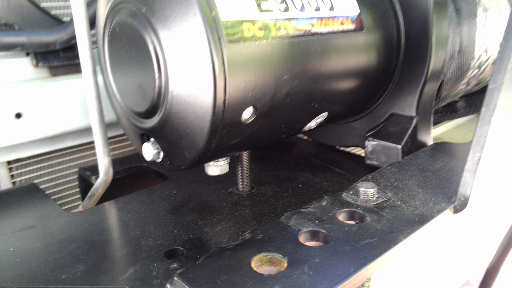

I did have a clearance issue with the ubolts supplied by Bud. In test fitting the inner bolts ran into the bottom housing of the winch. I was going to cut an inch and a half off those arms which still would have left plenty of thread to nut on to. Don't know if anyone else has had this problem. Just a heads up.

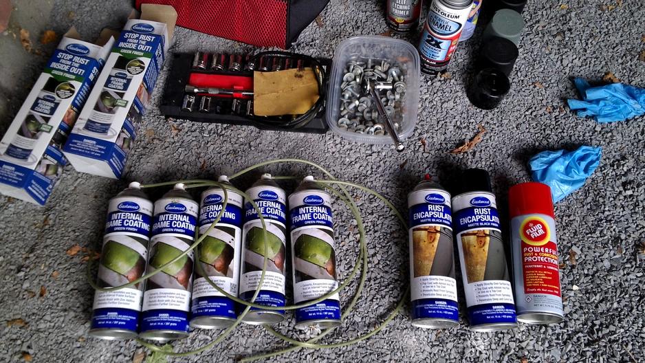

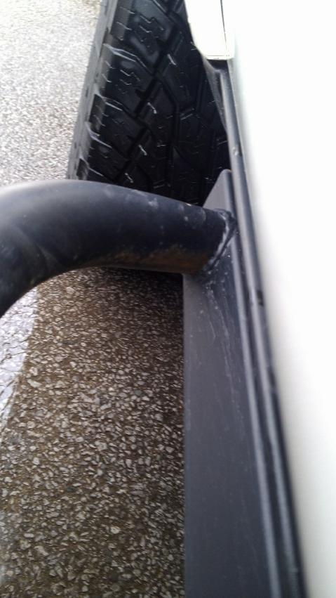

Rust Prevention

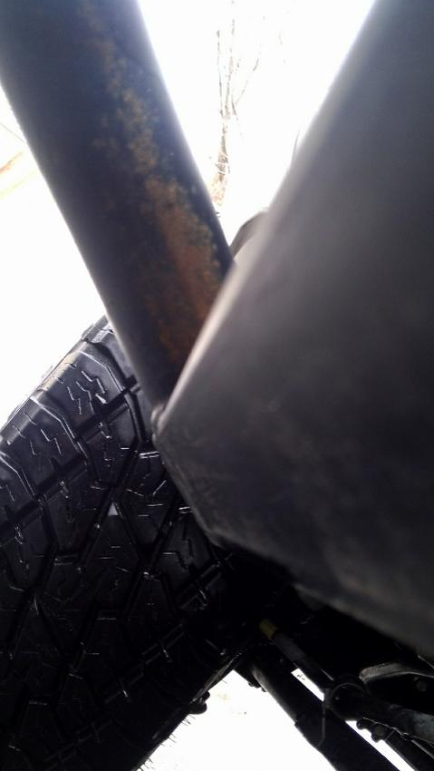

After it's first real winter the sliders which I painted with Rustoleum had quite a bit of rust on them so I decided to pull them off, grind out the rust and repaint them using Eastwood Rust Encapsulating Paint. I was planning on spraying inside the frame rails with Eastwood Internal Frame Coating so I had to pull the sliders to gain access to all of the holes in the frame anyway.
It took me 4 hours with my rotary tool and several sanding drums to get all of the rust patches ground out. It was much more extensive than I thought. Needless to say I'm disappointed with the Rustoleum.
I put a coat of the Eastwood paint on and because I had left over Rustoleum and black Plastidip I put coats of those on too. I figure the rubberized component of the Plastidip may be an effective barrier. The Plastidip is not a good outer coat because everything sticks to it and cannot be wiped off so I finished with two coats of Rustoleum matte black. Lets hope this does it. I also plan on spraying lots of Fluidfilm on them before winter.
I sprayed Eastwood Internal Frame Coating (green) inside my frame rails, cross members and lower A arms. It took eight cans to do 3 coats. Access was plentiful with all of the holes in the rails. You will want to straighten the spray lines that come with it ahead of time. They come curled up. I laid them out flat and put some heavy objects on them for a couple of days. The process is messy so put a tarp down to catch the excess that comes out the other holes, wear nitrile gloves and eye protection.
I also sand out any surface rust underneath as I find it and repaint with Eastwood Rust Encapsulating paint. Along with the Fluidfilm I plan on spraying extensively underneath before winter I hope this will buy more time for the frame. Love snow. Hate rust!

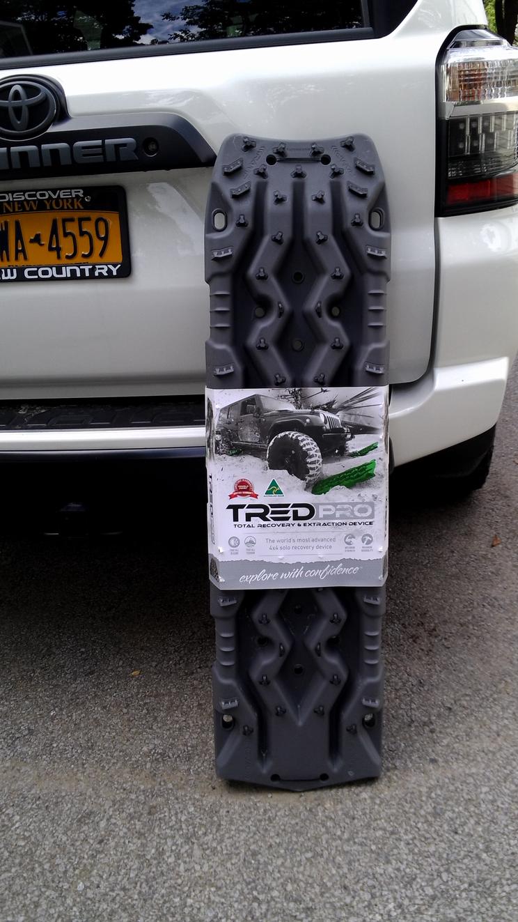

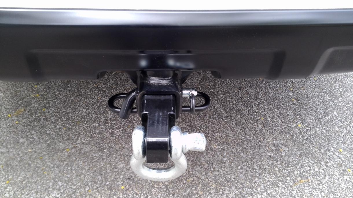

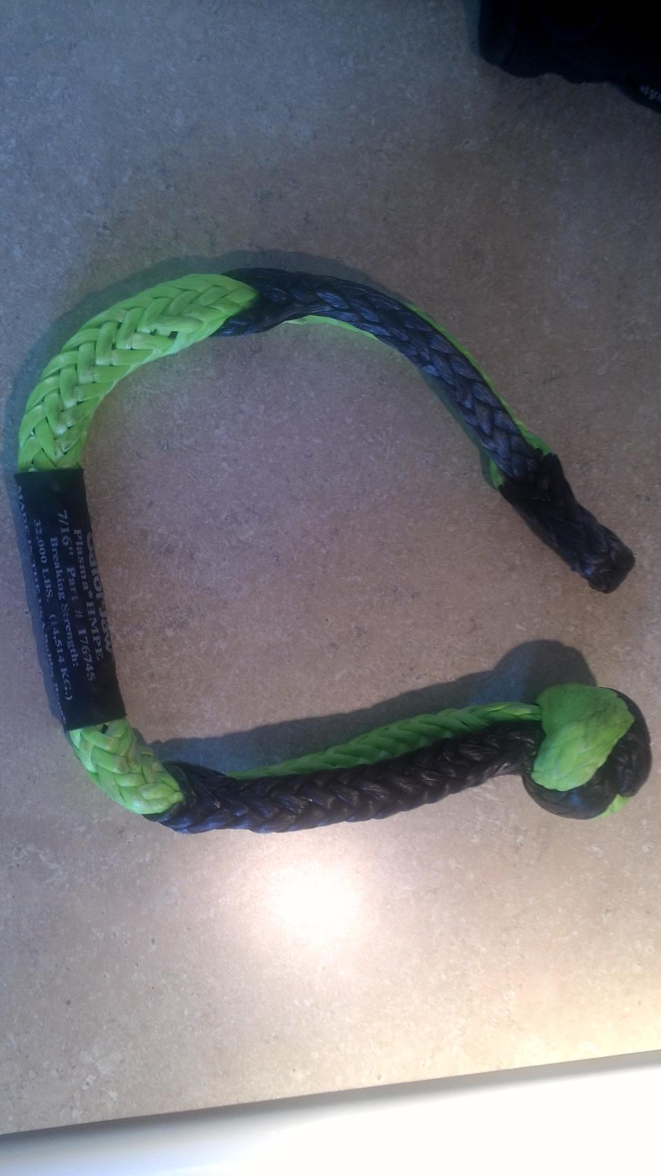

Since I got my Tred Pro recovery boards today I figured I'd add some of my recovery stuff.
ARB Snatch Strap 24000 lbs ~ ARB Tree Strap 26500 lbs ~ Gator Jaw Soft Shackle 32000 lbs ~ Bestop HighRock Recovery Hitch & D Ring 9500 lbs ~ Tred Pro Recovery Boards ~ Engo 9000 Synthetic Winch (which I do not have mounted yet because I'm waiting for the Pelfreybilt HWM holiday sale. Eventually I will also get more soft shackles and a load equalizing bridle.
