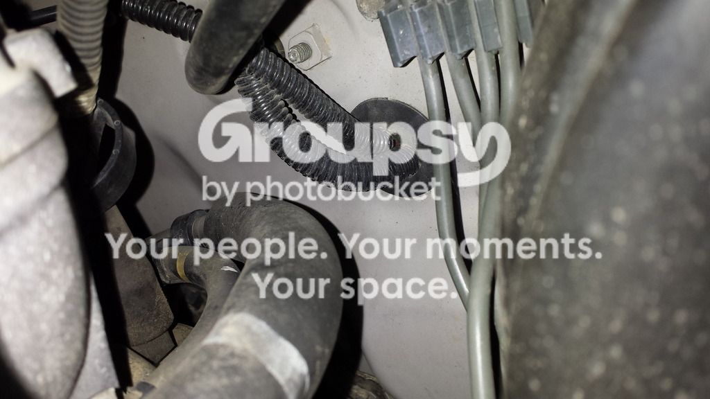

Here is a photo of one grommet with alarm wires going through the firewall. Could this be the source of the leaking? How would I seal that up? I guess I could just stuff some silicon caulking in there, but is that the best way?

I doubt it’s your firewall
Not too much water actually runs down it especially if your driving

It does seem odd that I get that much water inside the truck for such a small hole in the firewall. Not sure.

Ran into the same problem after I ran a cable through the firewall. Drivers floor mat soaked after a good rain. If you ran any aftermarket cables through the firewall, this may be your problem. I sealed mine up with a lot of black RTV and it has been dry ever since.

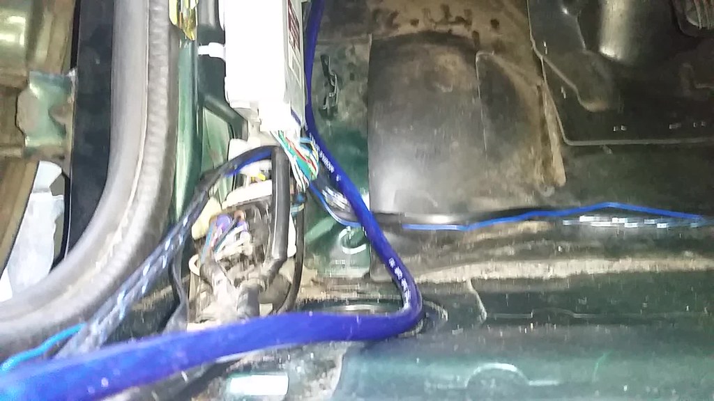

Here's a video I took trying to find the problem after spraying water on the roof, hood and windshield. Click the picture for video.
