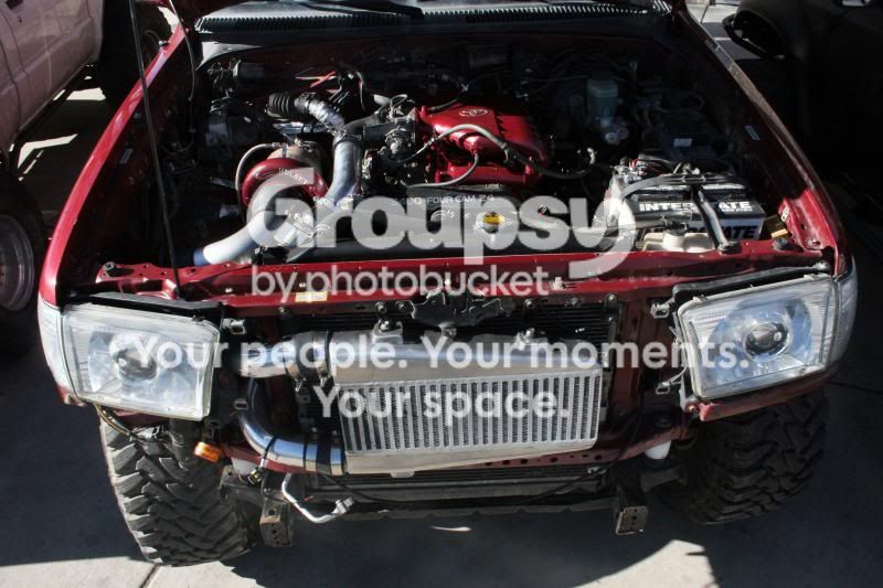

After driving and tuning the turbo setup for a few weeks, i came to the conclusion that the HX35 is a little bigger than i want. These things are meant to push 40psi through a diesel so running it 8-10 was giving a lot of lag.
I decided to swap to the smaller turbo we had sitting on the shelf. Now its running a HX30W which is originally on a 4BT Cummins and it is way more responsive. I can nail it in 4th gear at 1500rpm and build 8psi in a few seconds and it will peak at about 10psi.
I do still think the HX35 is a good setup but it would be better suiting to a higher reving motor and i'm much happier with the smaller turbo.
Also, I didn't mention this yet but i decided to sell the ODL bumper and will be building a new one which should be done by this time next week. The ODL would have fit with some minor trimming but i figured it was worth more if i didn't cut it and i've wanted to build my own front bumper for a while now.
I'll leave you with a picture of the engine bay and the smaller turbo
