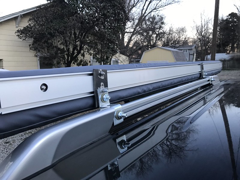

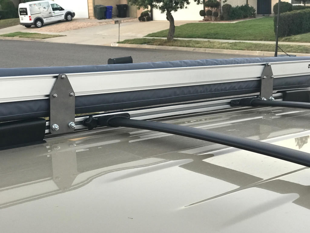

Options for factory roof rails
Note: this is for me (although, I’m posting it here so you can use it as well.)
After poking around the forums for a while, I’ve decided to make entries of things that I don’t want to search for again…
Brackets for the factory rails. While this was in a thread for awnings on factory rails, it opens up a number of possibilities for mounting things to the top of the vehicle.
  • This one looks to be the most solid. It looks like it’s been constructed from 3/16 steel plate, but the simplicity of this opens it up to a lot of different possibilities.
  • The next two appear to be options, but only for lighter weight components. They don’t look quite as stable for heavier items, but could be used for a shovel, axe, or something lighter. I’m not certain that I’d use it for an awning unless I put about 4 of them up.
  • The last one… workable, but not quite as elegant as the two above. This seems to be more of a “need to come up with something quickly” solution than anything else, and it also looks like any weight, or cranking to get it tight would really damage the factory rails.

I like those awning mounts in the first picture. Does anyone sell these or are they custom made?
