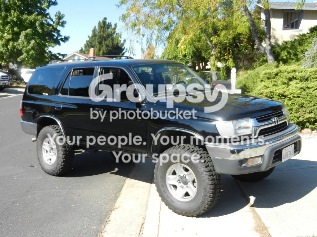

The next day I picked up my 285/75/16 MAXXIS Bighorn MTs and got an alignment:
DSCN0173.jpg~original
Front Closeup
DSCN0175.jpg~original
Rear Closeup
DSCN0176.jpg~original
From the back:
DSCN0177.jpg~original
DSCN0179.jpg~original
From the Front:
DSCN0180.jpg~original
DSCN0181.jpg~original
Man it looks great!! nice job with the lift and tires! just a couple things tho, Any rubbing with those 285s? and it may be just me but how are you measurements on all four corners? the front right and rear left look a bit lower compared to the other corners but it may just be me. Either way it looks great :rockon:
I did have some rubbing on the rear, it used to rub the stock rear bumper when stuffed and some on the gas filler nozzle inside the rear fender. The new CBI rear bumper fixed the bumper contact and the wheel spacers helped the nozzle contact.
I also had some in the front, still do sometimes but I have yet to pound in the pinch welds in the inside fender.
As for the measurements I would need to check, those pics are a few years old and the lift has settled some since then. Typically the driver sides sit a bit higher due to longer springs to compensate for driver weight and the fuel tank. Not sure which pic specifically you are referring to though. When I get some time I'll post my current measurements.
That would make sense as the springs and shocks weren't settled and makes sense for the weight of driver. I just noticed and wanted to make sure I wasn't crazy :)

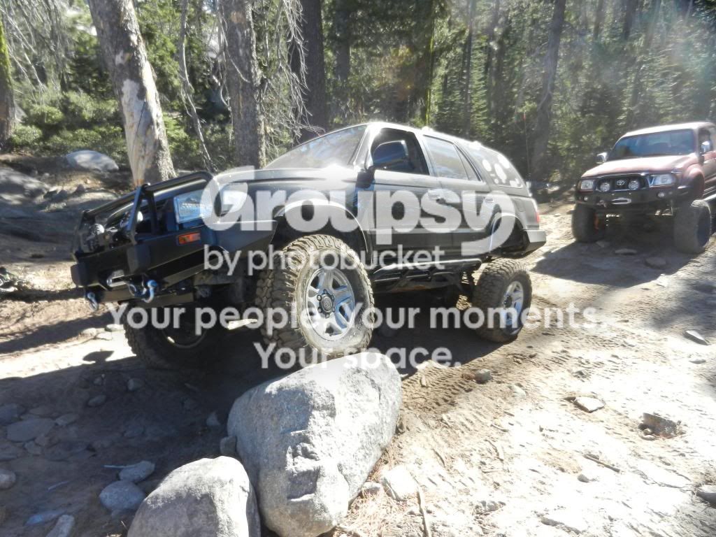

Well finally! haha Glad to see you're getting this going because it has changed a ton since the first time we went wheeling. Do you still have that dent on your rocker panel from the rock?
I'll post these pictures up just for fun...
It was such a baby back then.
Ha hey Robert, yeah I really did mean to start this thread a loooooong time ago but it just didn't happen. Life has been crazy busy the last few years and I'm finally settled enough to contribute.
I do still have a small dent there and I have a few more after Rubicon last week, my armor for SURE has dents in in now but that's what it's for.
Seeing those wheeling pics make me laugh now, you said it right it was such a "baby" back then. But then again you were in that 2nd gen 3.slow too. We both have come a long way!

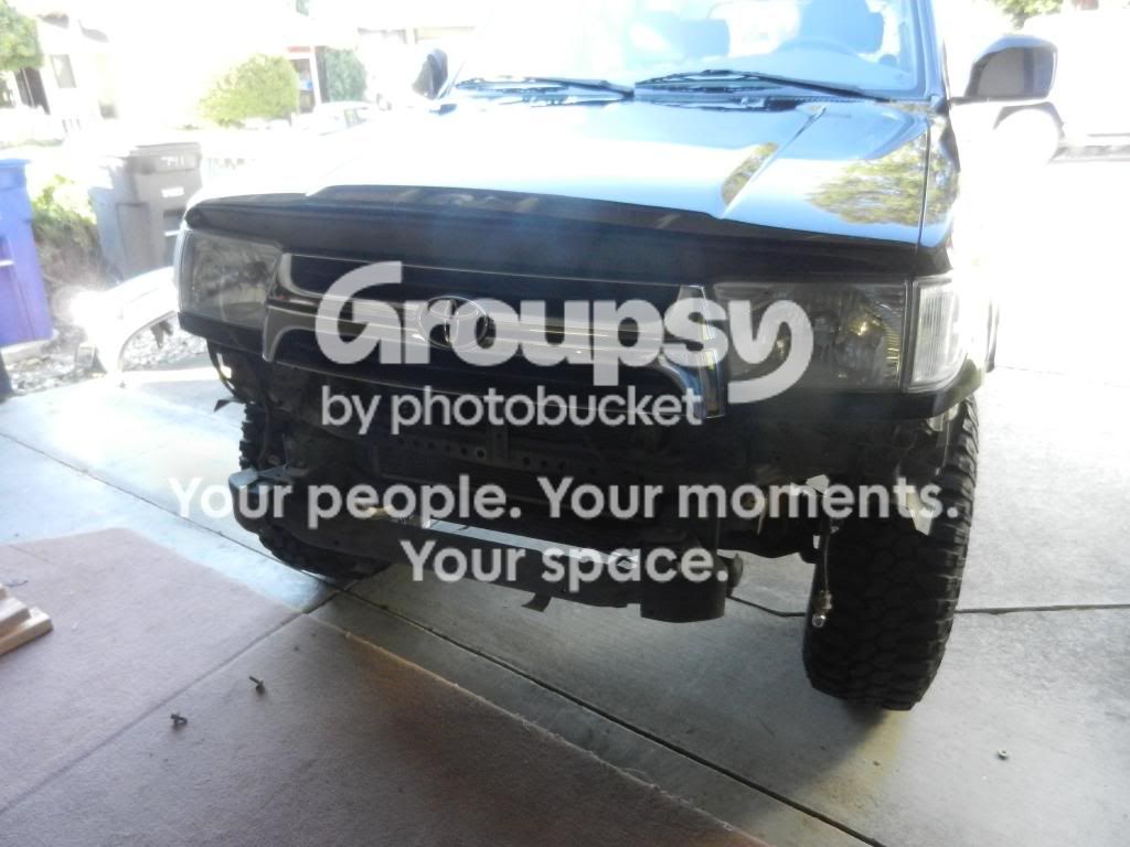

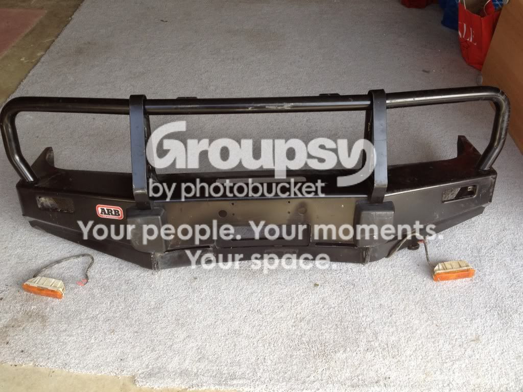

My next mod ended up being an ARB front bumper that I scored off Craigslist for $400. It was used but complete. Had to drive out to sac to get it but it was still about 1/2 of new so what the hell.
Here is she is before the install:
DSCN1452.jpg~original
Front Bumper removed:
DSCN1454.jpg~original
A bit better pic with more flash:
DSCN1457.jpg~original

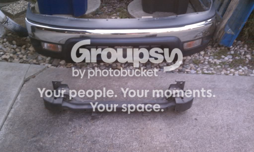

Here are the removed parts. I ended up selling these for a few hundred bucks so the ARB was just about free!
IMAG0365.jpg~original

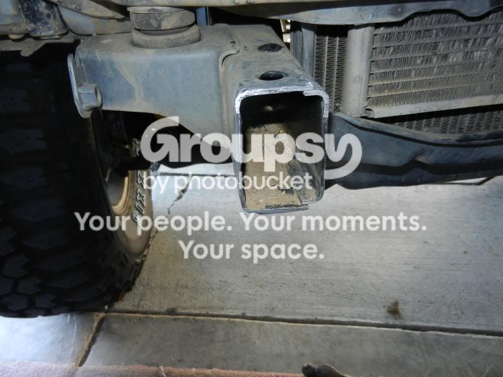

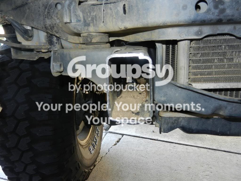

Impact bar removed and front tabs already cut off. I thought it was funny that my frame had dried mud in there. And this is exactly why I HATE mud. (no ref to 1h8mud lol)
DSCN1460.jpg~original
DSCN1462.jpg~original
Here it is all bolted on. I didn’t bother to do write up as it’s been done several times before.
Photo160.jpg~original
Total install took me about 2 or 3 hours all by myself.

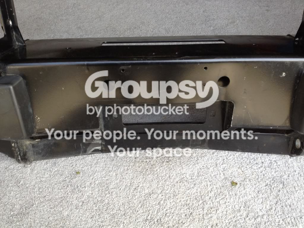

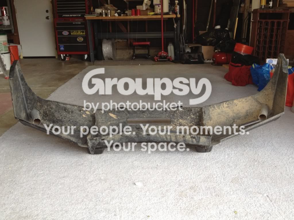

I didn't take any pics of the truck after the accident for some reason but here are a few pics of the bumper after I took it off. These are the pics I used to sell it. (I gave full disclosure to the buyer of the accident too)
cda929aa.jpg~original
6a09aebb.jpg~original
3447b8f1.jpg~original
